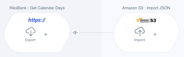

Flow: RiksBank (GetCalendarDays) to Amazon S3 (XPath)
In this section, we'll build the flow to take calendar details from RiksBank, convert the payload to JSON, and put that into a file on S3.
Below is a visual representation of the final result of the flow:

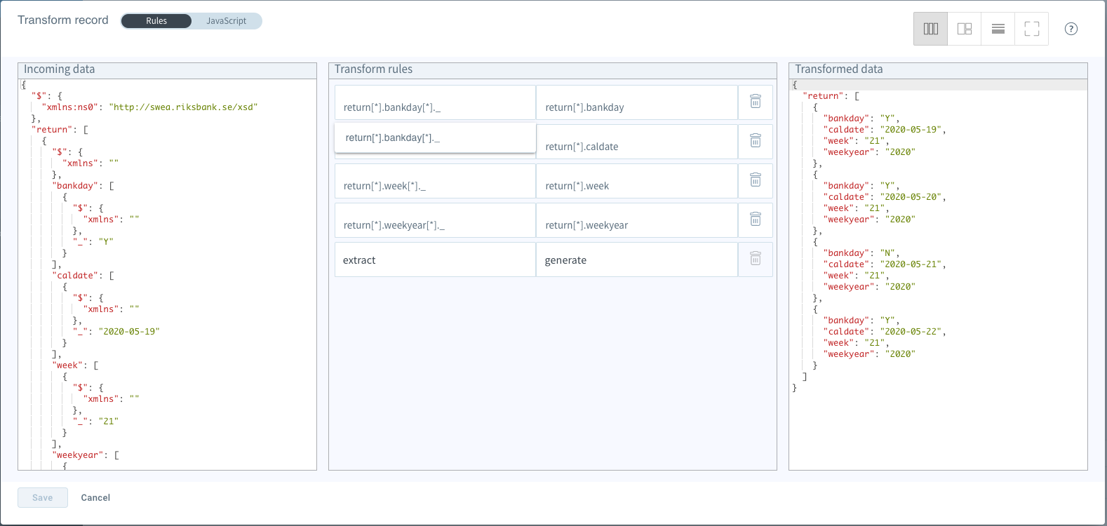

Step 3: Define a transformation on the export
This step defines how integrator.io cleans (or transforms) the basic JSON payload (from step 1) into a more human-friendly structure. Below are the details of the transformation.
Export
Import
return[*].bankday[*]._
return[*].bankday
return[*].caldate[*]._
return[*].caldate
return[*].week[*]._
return[*].week
return[*].weekyear[*]._
return[*].weekyear
Here's an example of what your end result should look like.
