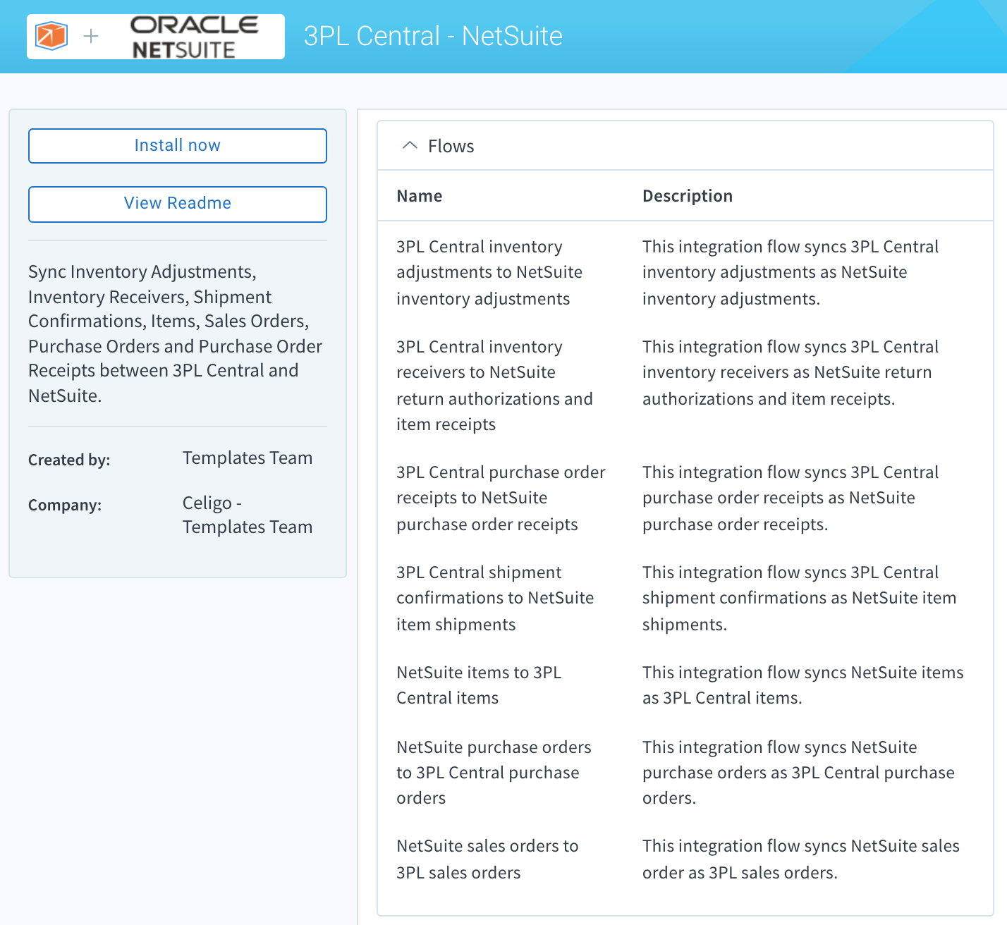

- From the available templates, select either 3PL Central or NetSuite.
- Find the 3PL Central – NetSuite template and click Preview. The Install template page appears.
- Review the template’s contents and the ReadMe file, and click Install now to begin. The Install integration page appears.

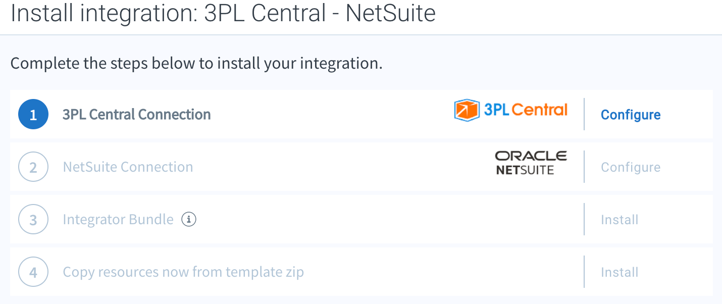

Set up the connections and integrate with 3PL Central and NetSuite
To install the integration, complete the following steps.
Step 1. Connect to 3PL Central
Click Configure to set up the 3PL Central connection.
If you have already set up a connection to 3PL Central, select Use existing connection and choose it from the Connection list. Otherwise, click Set up new connection and provide your 3PL Central account credentials.
Step 2. Connect to NetSuite
Click Configure to set up the NetSuite automatic token-based auth or manual token-based auth connection.
If you have already set up a connection to NetSuite, select Use existing connection and choose it from the Connection list. Otherwise, click Set up new connection and provide your NetSuite account credentials.
Step 3. Install NetSuite integrator bundle
Click Install to install the NetSuite integrator bundle. The setup page detects whether this integration bundle is already installed with the NetSuite connection that you provided. The NetSuite custom bundle (ID 326983) contains custom fields and saved searches tailored for this template. If it cannot be confirmed, you are redirected to NetSuite where you can install the bundle as follows:
- Sign in to your NetSuite account.
- From the Customization menu, select Suite Bundler > Search and install bundles.
- Enter the bundle ID 326983 into the Keywords field, and click Search.
- Select this bundle, and click Install.
- After the Celigo Integrator bundle is successfully installed in your NetSuite account, switch back to the browser window with your integrator.io account.
- Click Verify now.
The integrator bundle status changes to “Installed.”
Step 4. Copy resources now from template zip
Click Install to create all 7 flows in your application.
