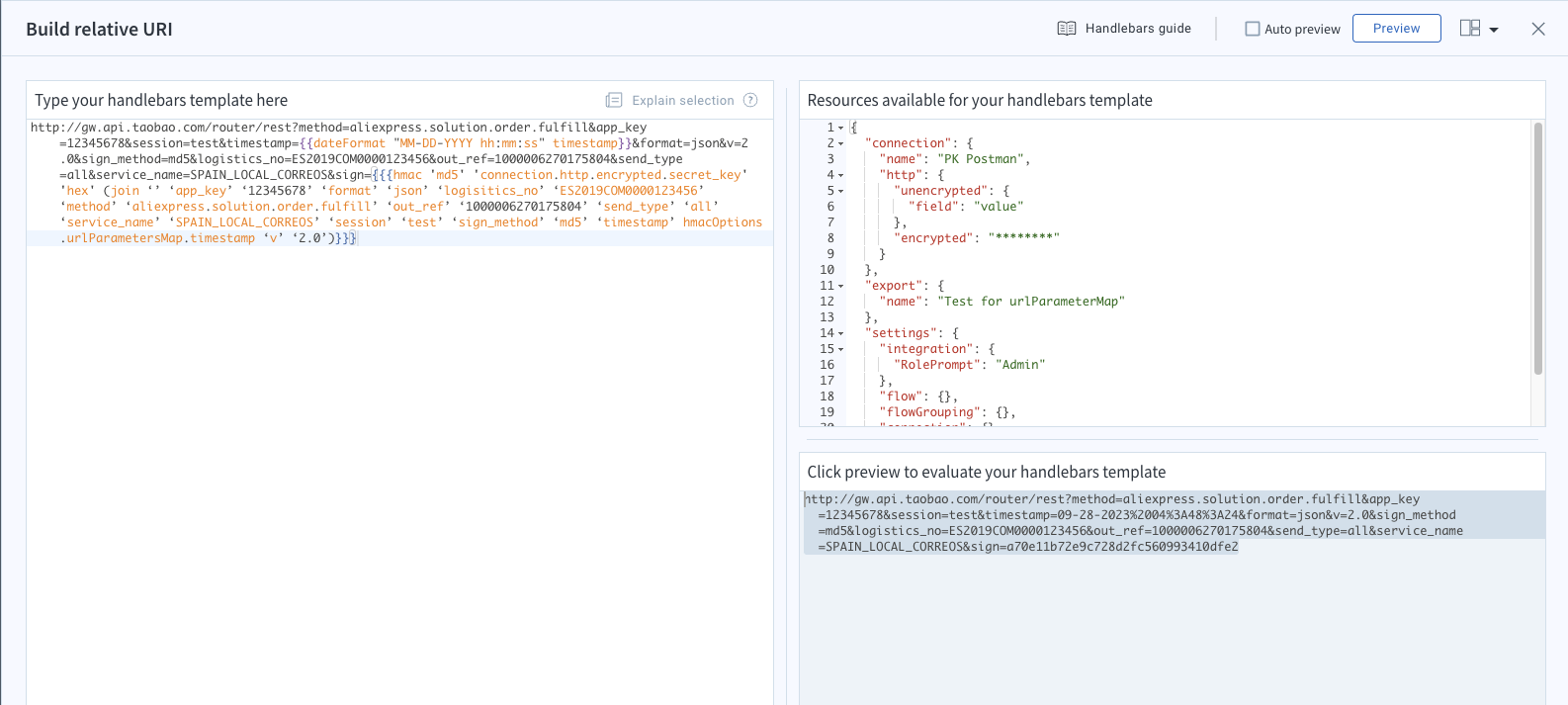

The handlebars template to build the request is as follows:
http://gw.api.taobao.com/router/rest?method=aliexpress.solution.order.fulfill&app_key=12345678&session=test×tamp={{dateFormat
"MM-DD-YYYY hh:mm:ss" timestamp}}&format=json&v=2.0&sign_method=md5&logistics_no=ES2019COM0000123456&out_ref=1000006270175804&send_type=all&service_name=SPAIN_LOCAL_CORREOS&sign={{{hmac
'md5' 'connection.http.encrypted.secret_key' 'hex' (join ‘’ ‘app_key’ ‘12345678’
‘format’ ‘json’ ‘logisitics_no’ ‘ES2019COM0000123456’ ‘method’ ‘aliexpress.solution.order.fulfill’
‘out_ref’ ‘1000006270175804’ ‘send_type’ ‘all’ ‘service_name’ ‘SPAIN_LOCAL_CORREOS’
‘session’ ‘test’ ‘sign_method’ ‘md5’ ‘timestamp’ hmacOptions.urlParametersMap.timestamp
‘v’ ‘2.0’)}}}
The above handlebars template generates the following request which includes the required signature:
http://gw.api.taobao.com/router/rest?method=aliexpress.solution.order.fulfill&app_key=12345678&session=test×tamp=09-28-2023%2004%3A48%3A24&format=json&v=2.0&sign_method=md5&logistics_no=ES2019COM0000123456&out_ref=1000006270175804&send_type=all&service_name=SPAIN_LOCAL_CORREOS&sign=a70e11b72e9c728d2fc560993410dfe2
