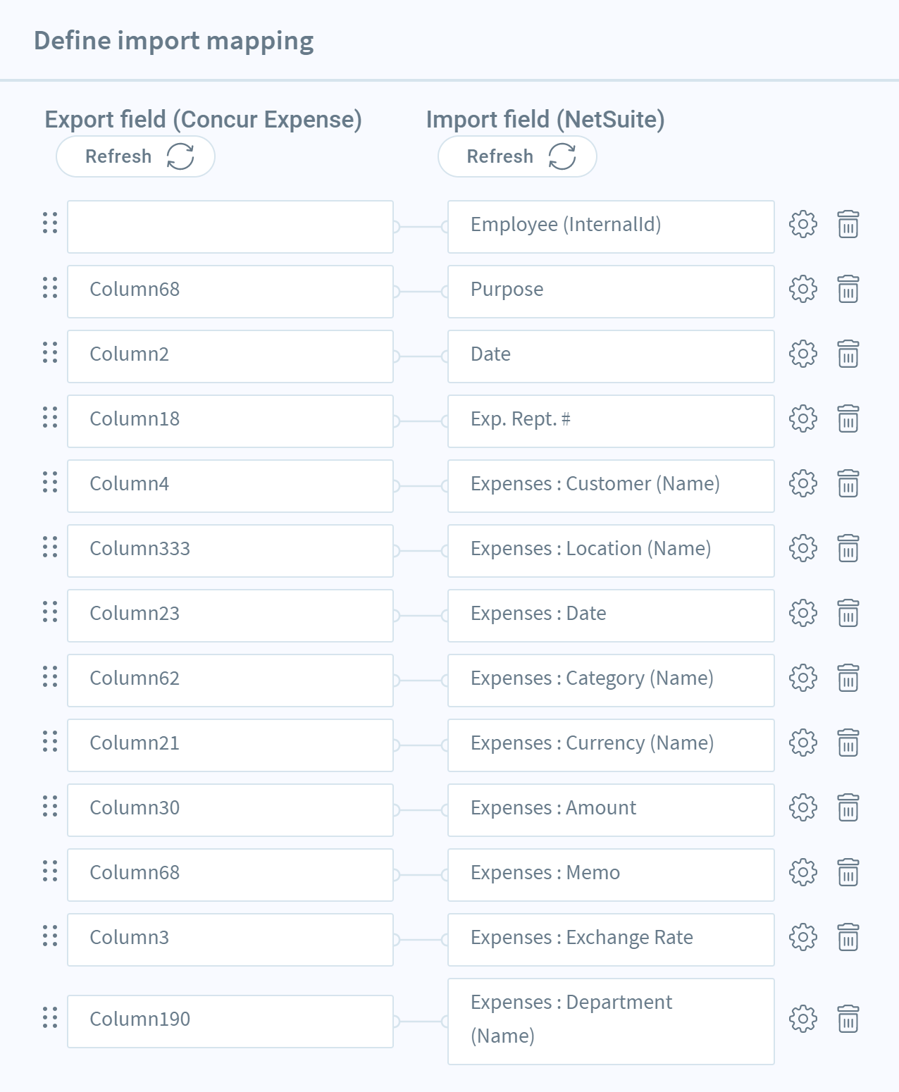

Concur expense reports to NetSuite expense reports (Enhanced)
This integration flow syncs Concur expense reports as NetSuite expense reports for Professional Concur accounts by the Extract Method.
Applies to
- Concur Expense (Enhanced) – NetSuite Quickstart integration template
Flow details
- Export source: Concur
- Import destination: NetSuite
Built-in export: Get Concur extract definition details – get Concur extract definition details for expense
- Built-in preSavePage hook: ConcurExpenseReport.js – parse links to job files
- Built-in lookup: Get Concur extract files by job ID – get extract files from Concur
- Built-in import: Import NetSuite expense reports – add (or ignore) expense reports into NetSuite with Exp. Rept. # as the lookup identifier field
Before you begin
- The NetSuite Employee FirstName and LastName and the Concur User FirstName and LastName should be the same.
- Add the Definition ID field for the Expense to NetSuite.
Setup instructions
- Configure static mapping for Category, Department, Location, and Currency in Import NetSuite expense reports.
- Add subsidiary mapping to Import NetSuite expense reports.
- Configure the dynamic map for Employee (InternalId) in Import NetSuite expense reports.

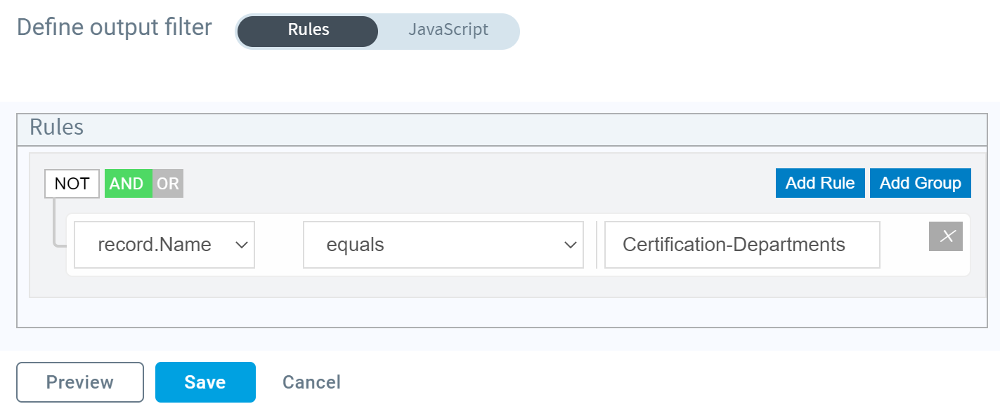

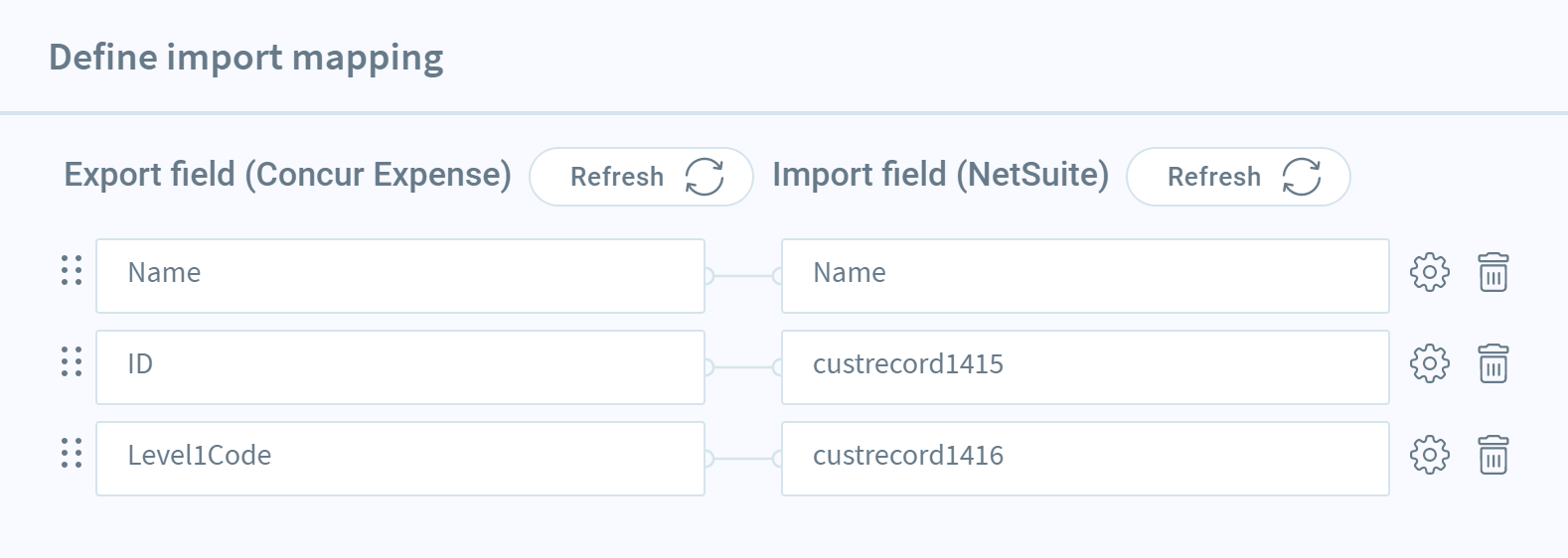

- Built-in export: Get Concur lists – get all lists from Concur
- Built-in lookup: Get concur list item by list ID – get a list item from Concur by list ID
- Built-in import: Import NetSuite departments – add or ignore departments into NetSuite with configured custom field as the lookup identifier
Setup instructions
Configure filter rules in Get Concur lists. (The record.value in the filter rule represents the name of the list created in Concur; the department records are inside the Concur list.)

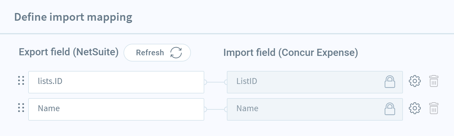

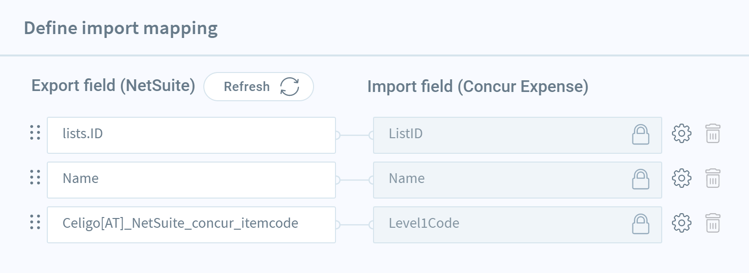

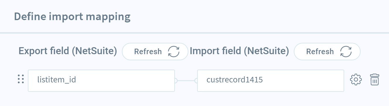

- Built-in export: Get NetSuite departments – get all departments from NetSuite
- Built-in lookup: Get Concur lists – get all lists from Concur
- Built-in import: Import Concur list items (create) – add or ignore list items into Concur with id as the lookup identifier
- Built-in import: Import Concur list items (update) – update list items into Concur with id as the lookup identifier
- Built-in import: Import NetSuite departments – update departments into NetSuite with id as the lookup identifier
Setup instructions
Configure filter rules in Get Concur lists. (The record.value in the filter rule represents the name of the list created in Concur; the department records are inside the Concur list. See What are Concur lists?, above.)
