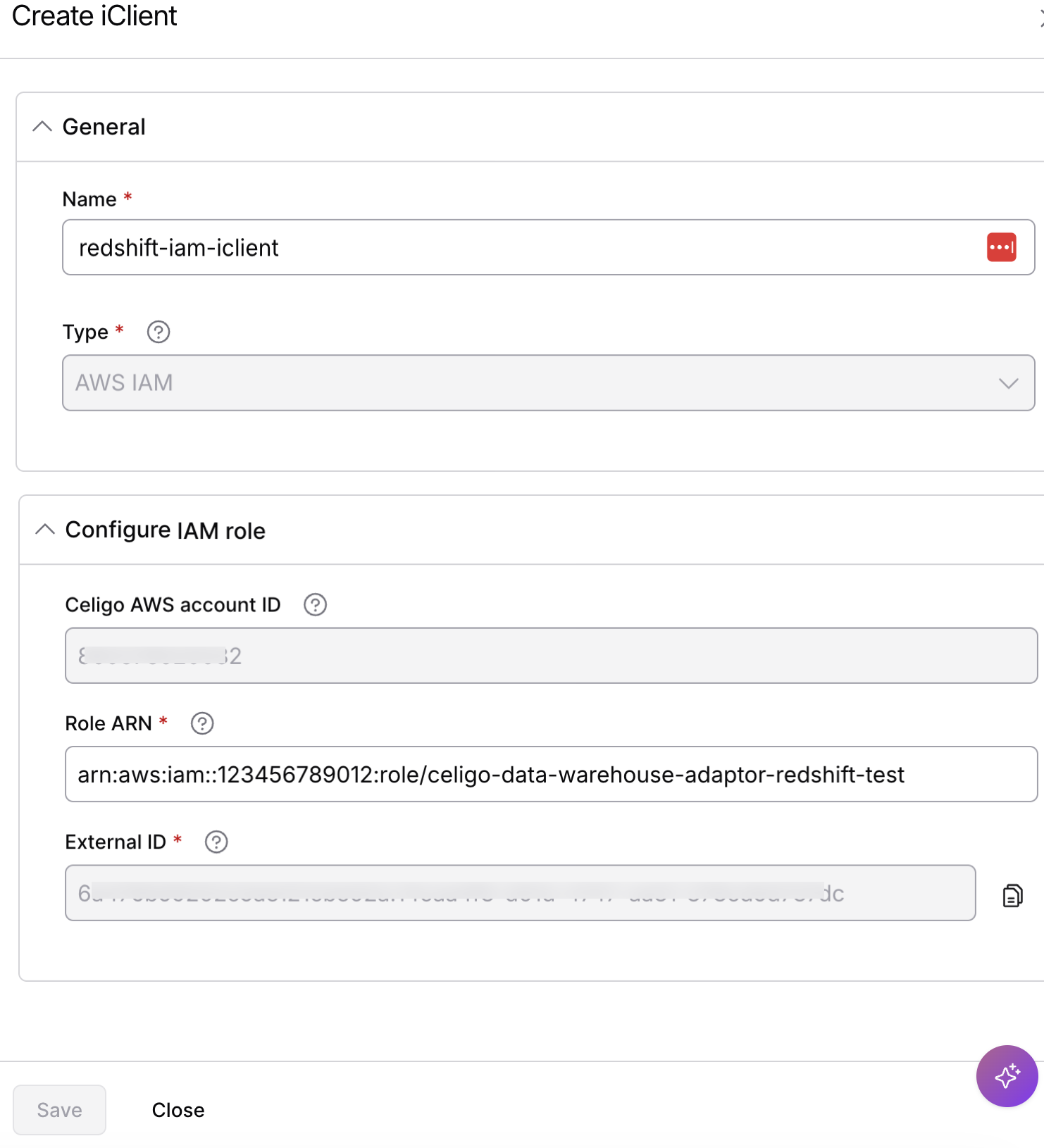

Create the AWS iClient in Celigo
  1. In Celigo, navigate to Resources > iClients.
  2. Click Create iClient.
  3. In Name, enter a clear and distinguishable name.
  4. Confirm that Type is set to AWS IAM.
  5. Copy the Celigo AWS account ID.
  6. Generate and copy the External ID.
  7. Create the IAM role in AWS.
  8. Paste the IAM role ARN into the Role ARN setting in Celigo.
  9. Save the iClient.

Setting Description
Name Enter a clear and distinguishable name. For example, s3-prod-iam-iclient or redshift-prod-iam-iclient.
Type The iClient type. For AWS IAM authentication, this is AWS IAM.
Celigo AWS account ID (read-only)
Copy Celigo’s AWS account ID. You need this value when creating the IAM role trust relationship in AWS.
Create an IAM role.
Role ARN
After creating the IAM role in AWS, copy the role ARN and paste it here. The required IAM role name prefix depends on the connector. For Amazon S3, the role name must begin with celigo-file-adaptor. For Amazon Redshift, the role name must begin with celigo-data-warehouse-adaptor
Amazon Resource Names (ARNs) uniquely identify AWS resources. ARNs should be handled carefully, but they are not secret values.
Retrieve your role's ARN.
External ID
Generate and copy the External ID unique to this iClient. Add this value to the AWS IAM role trust relationship.
