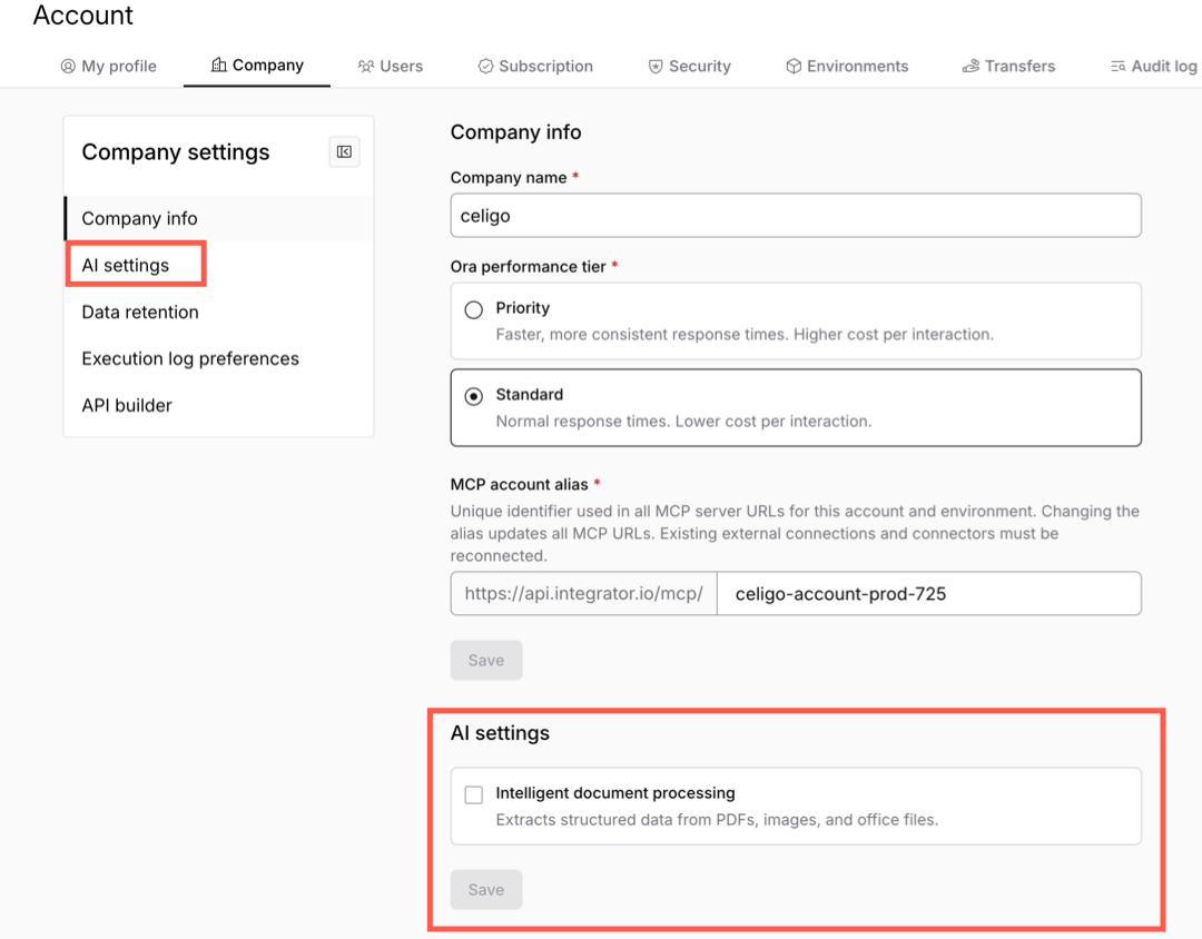

  • To process and extract data from document formats that aren't natively supported by the selected AI agent type, go to Account > Company settings > AI settings and enable Intelligent document processing.

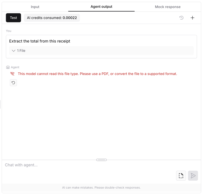

  5. Preview the agent with a sample document and verify that the extracted data matches your schema.

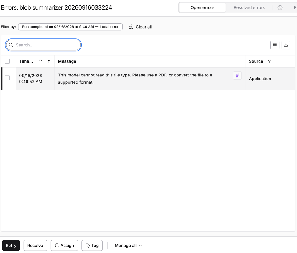

The document types available for extraction depend on the file formats supported by the selected AI agent type. If the agent doesn't support a file format, it returns the following error:
You can also view this error in Flow Builder > Run console for the failed record.
To process and extract data from document formats that aren't natively supported by the selected AI agent type, go to Account > Company > AI settings, enable Intelligent document processing, and select Save.
