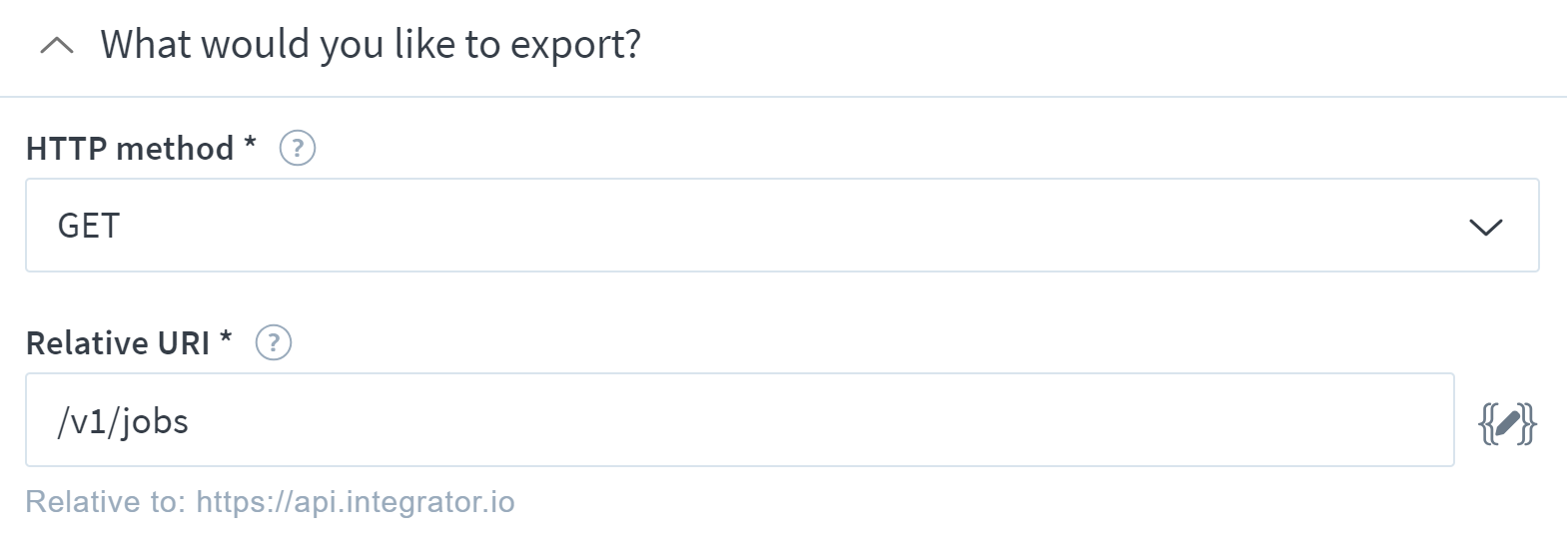

Export type of “All”
Relative URI: /v1/jobs
This allows you to get all jobs.

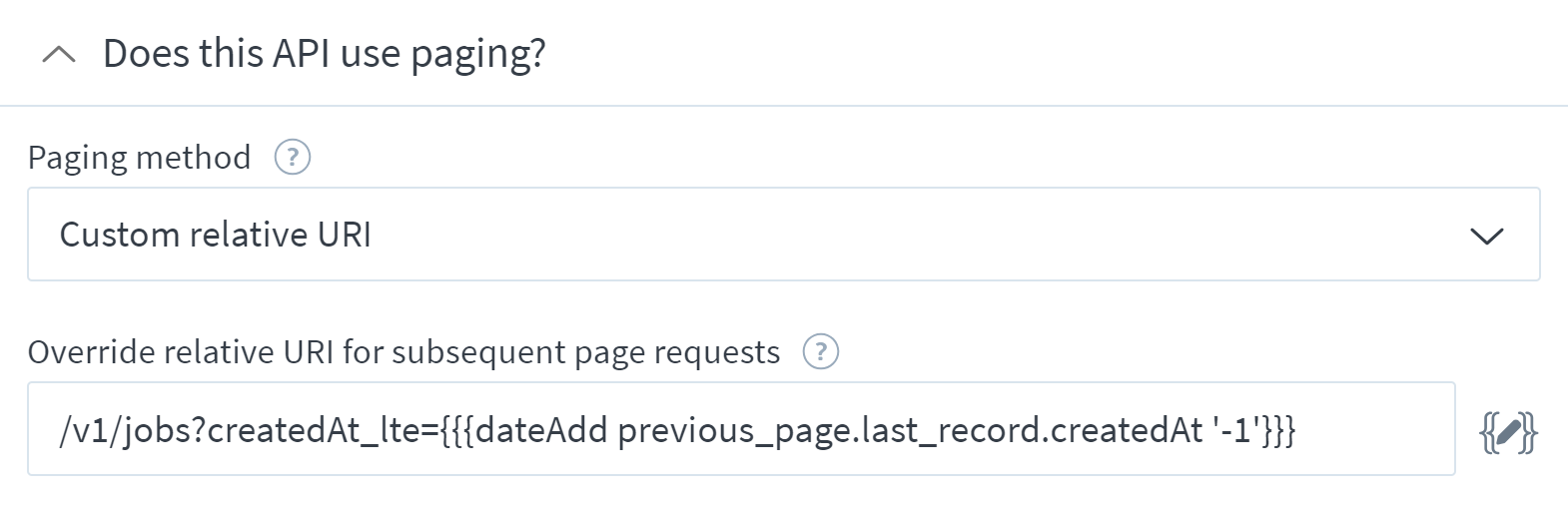

Paging Method: Custom relative URI Override relative URI for subsequent page requests: /v1/jobs?createdAt_lte={{{dateAdd previous_page.last_record.createdAt '-1'}}}
This allows you to get all previous jobs within your accounts retention policy.

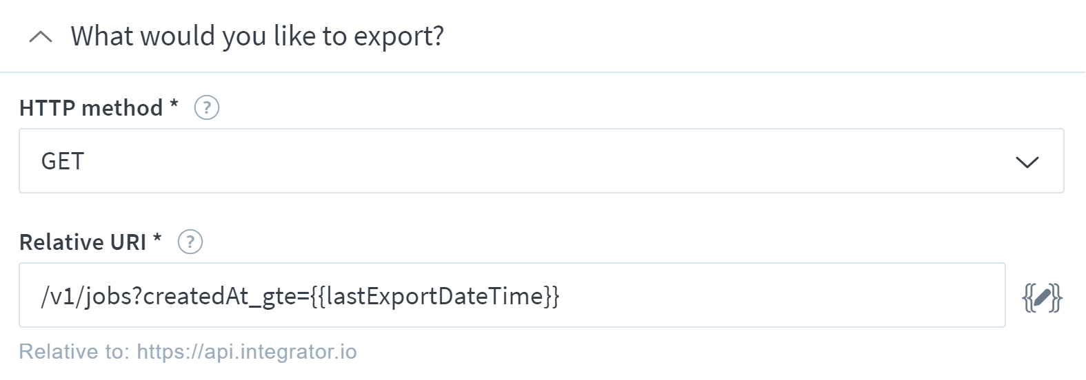

Export type of “Delta”
Relative URI: /v1/jobs?createdAt_gte={{lastExportDateTime}}
This allows you to get all jobs created since the last export.

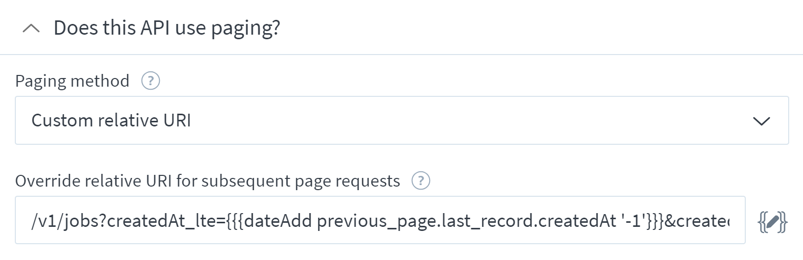

Override relative URI for subsequent page requests: /v1/jobs?createdAt_lte={{{dateAdd previous_page.last_record.createdAt '-1'}}}&createdAt_gte={{{lastExportDateTime}}}
This allows you to get all previous jobs created since the last export that fall within your accounts retention policy.
