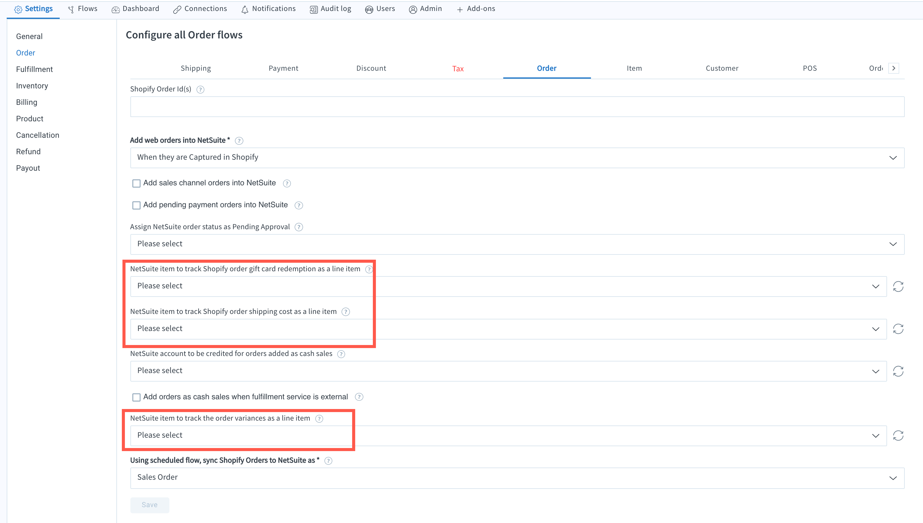

  1. Take a screenshot of all the fields in Settings that display information from NetSuite.
    Though the display of values selected for all fields in Settings within the integration app remains unaffected from the sandbox refresh, it is recommended to take a screenshot of every field where you have selected a NetSuite value. After the sandbox refresh, all the fields that display data from NetSuite must be reconfigured. Screenshots of all Setting fields are advantageous when you are reconfiguring values in the integration app after the sandbox refresh.

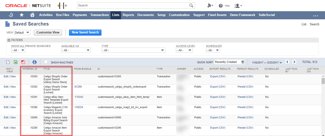

  2. Reconfigure all saved searches
    Refresh and re-select a saved search to link the saved search being displayed in the integration app with the saved search from your production account. Without refresh, the saved search displayed in the integration app always points to the internal ID of the saved search belonging to the sandbox account before the refresh. When you refresh the drop-down list for any saved search, it updates the internal IDs associated with the saved search as per the production account.
    All saved searches existing in NetSuite hold a unique internal ID with them. A saved search with the same name in production and sandbox will always have a separate internal ID associated with them.
    Refreshing the drop-down list ensures that the saved search being used in the integration app refers to the internal ID of the saved search in a production environment.
    To ensure the right saved search is being used, you are required to perform the following steps:
    1. In Settings, click the Refresh icon against the saved search drop-down list.
    2. Select the appropriate saved search from the saved search drop-down list.
    3. Click Save.
    4. Repeat the above steps for all the saved searches present in the Integration App.

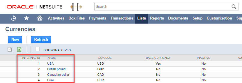

  3. Reconfigure all the fields in Settings that display information from NetSuite.Any field in the integration app that displays information from NetSuite, needs to be refreshed before executing the flow. When you select a NetSuite value in the integration app, the integration app always refers to the internal ID of the selected value.
    For example, assume the currency information and associated internal IDs in NetSuite are stored in the following manner:
    When you select the USA from the drop-down list and run a flow, the integration app will always refer to the internal ID 1 that is listed against currency: USA.
    Now, assume that the currency information in the NetSuite production account is stored in the following manner:
    Internal ID
    Name
    4
    USA
    3
    British pound
    2
    Canadian dollar
    1
    Euro
    After sandbox refresh, if you do not refresh and reselect the value in the field, the integration app will read the currency to be processed as Euro instead of USA because the internal ID 1 in the production account points to Euro. When you refresh the field, all internal IDs are remapped against the value displayed in the field. So, after the refresh when you reselect the value as the USA, the integration app refers to the internal ID of the USA which is 4.
    Perform the following steps to refresh and reselect the value:
    1. In Settings, click the Refresh icon against the field.
    2. Select the appropriate value from the drop-down list.
      You can refer to the screenshots you have taken in step 1 of the Required steps before a sandbox refresh section to identify the value that you need to select from the drop-down list.
    3. Click Save.
    4. Repeat the above steps for all the saved searches present in the integration app.

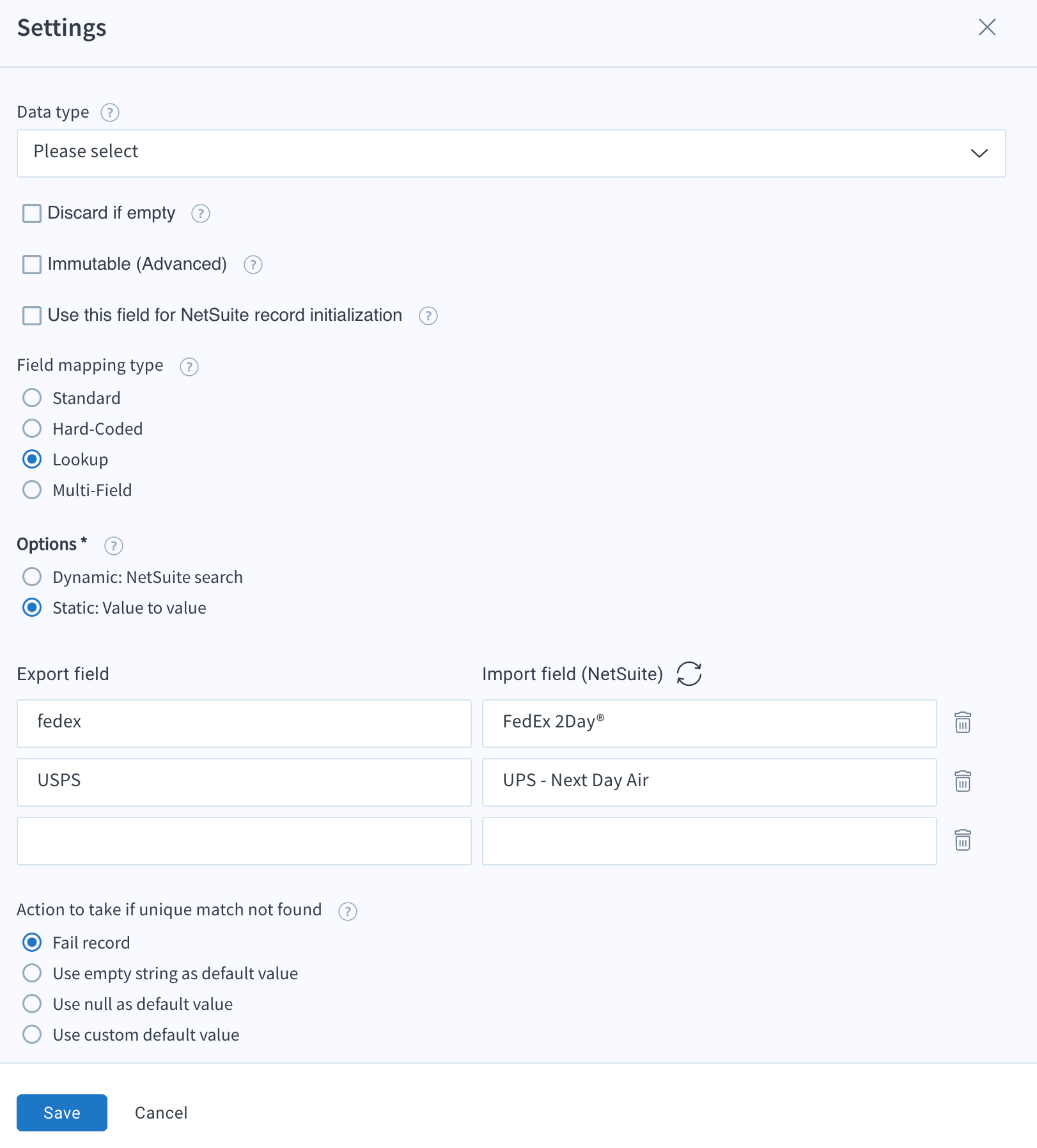

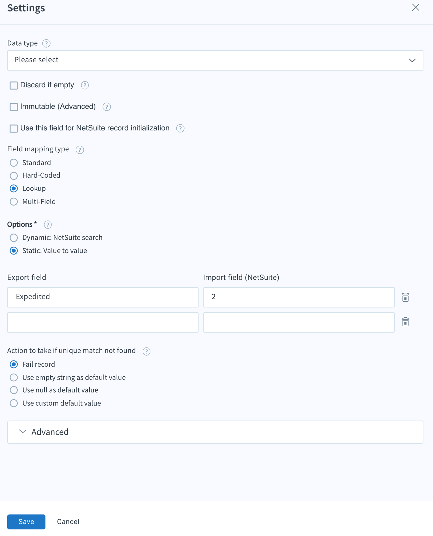

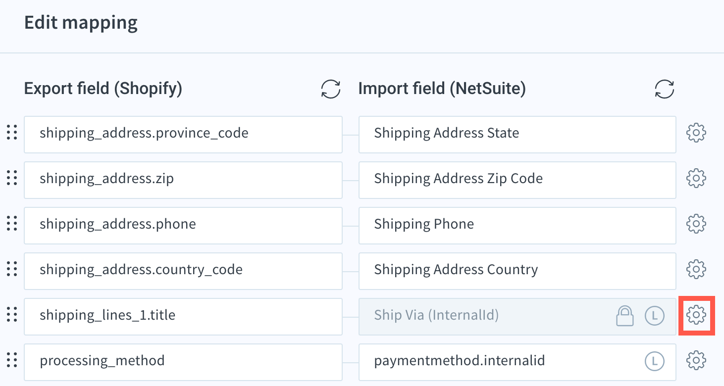

  4. Re-configure Field Mappings with values in the Hard-Coded and Lookup field.You are required to reselect the value in the Hard-Coded or Lookup field from the Settings window for all the Field Mappings against all flows where you have defined value in the Hard-Coded and Lookup field.
    1. Click the Field Mappings icon against integration flow. The Mappings window is displayed.
    2. Click the Settings icon against the mapping to open the Settings window.
    3. Select Hard-Coded or Lookup field.
    4. From the Import Field (NetSuite) drop-down list, reselect the value you wish to assign against Export Field.
      You can refer to the screenshots you have taken in step 2 of the Required steps before sandbox refresh section to identify the value that you need to select from the drop-down list.
    5. Click Save.
    6. Repeat the above steps for all similar field mappings.
