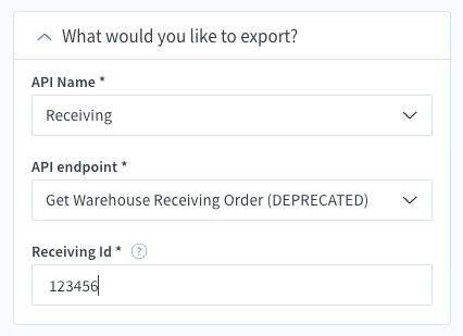

Path parameters used in the deprecated operation
For each export that is using a deprecated API, find its corresponding replacement API in the chart below, and select the new API name and operation.

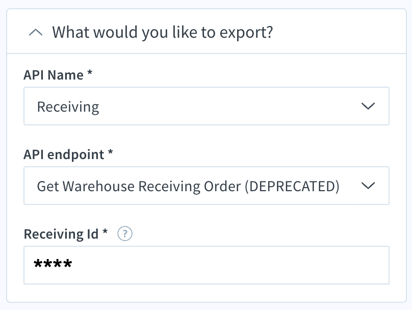

Find each export of the flows that use a ShipBob connection; if it has the endpoint mentioned [Deprecated] follow the steps and update accordingly:
If the existing export is configured as follows:
API name: Receiving
Operation: Get Warehouse Receiving Order(DEPRECATED)
Export used in the deprecated operation

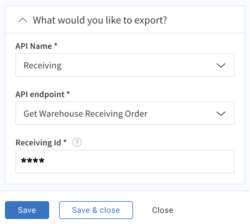

Then, convert it according to the above table, as follows, and as shown in the images below:
API name: Receiving
Export used in the replacement operation
