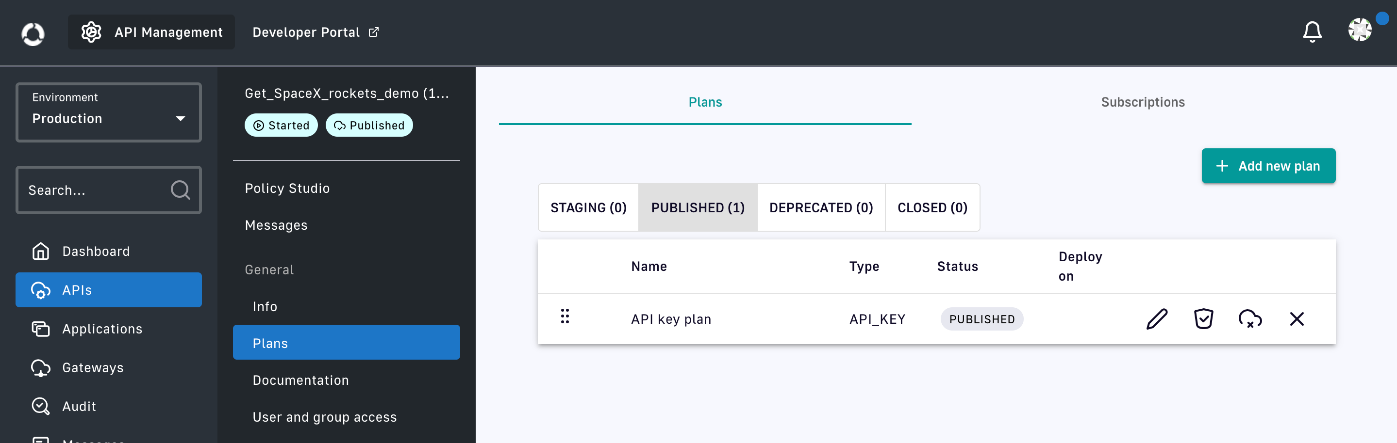

Publish your API plan
You must publish your API plan before anyone can subscribe to it. Don't forget to deploy your plan first to send the latest changes. To publish:
  1. Navigate to Consumers → Plans and select the Staging tab (v4), or Plans → Staging (v2).
  2. Select the publish icon (cloud with an arrow) for the plan.
  3. Confirm that you want your plan to be published.
In v4, published plans move to the Published tab.
Deprecate your plan
To deprecate your plan, select the deprecate icon (cloud with an X) for the plan and confirm that you want to deprecate the plan. In v4, deprecated plans move to the Deprecated tab.

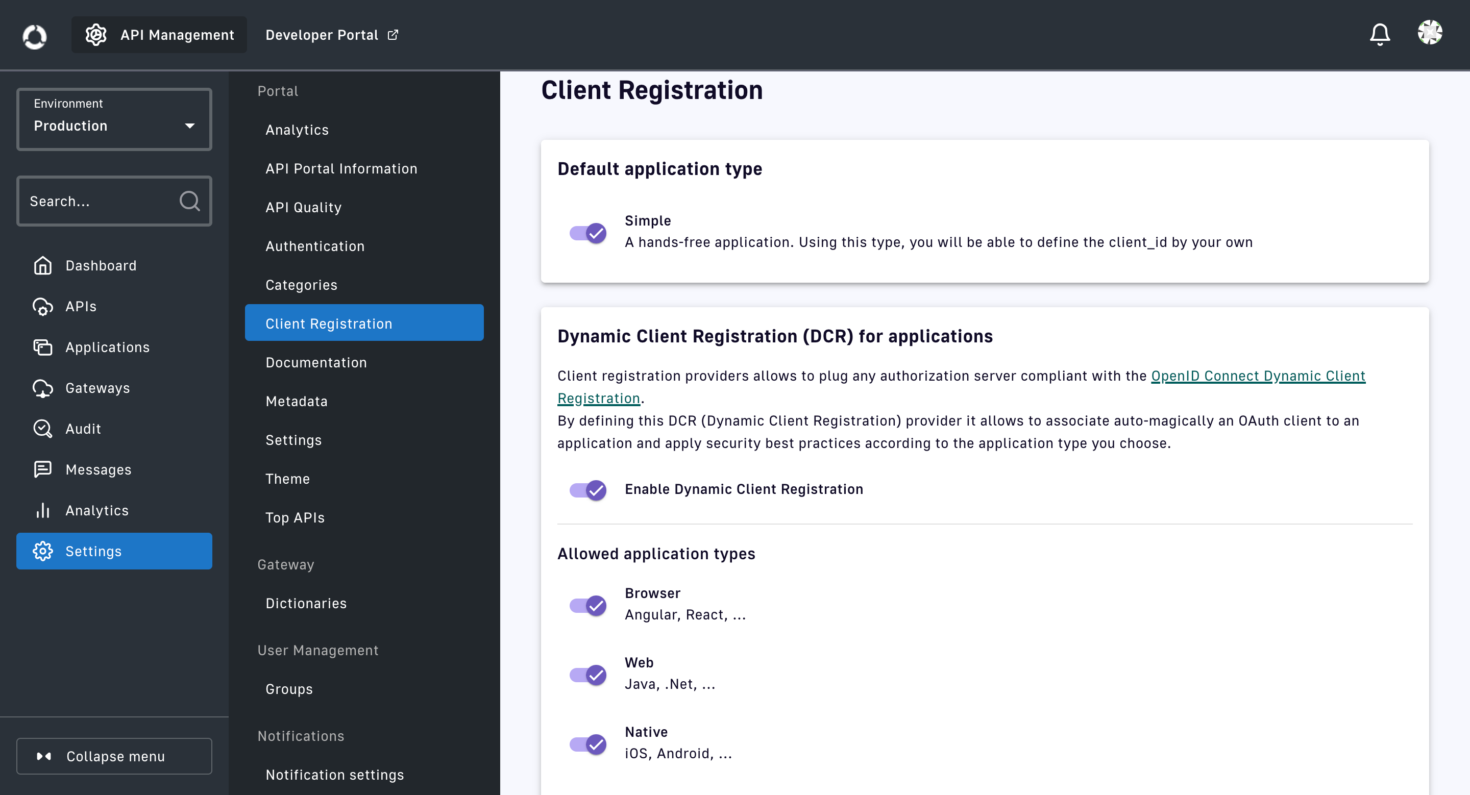

Configure your application types
Before you or your users can create an application, you must configure your allowed application types.
  1. Navigate to Settings → Client Registration.
  2. Configure the Default application type.
  3. Under Allowed application types, turn on the types users can create: Browser, Web, Native, or Backend-to-Backend.
  4. Optionally, turn on Enable Dynamic Client Registration and add a provider.

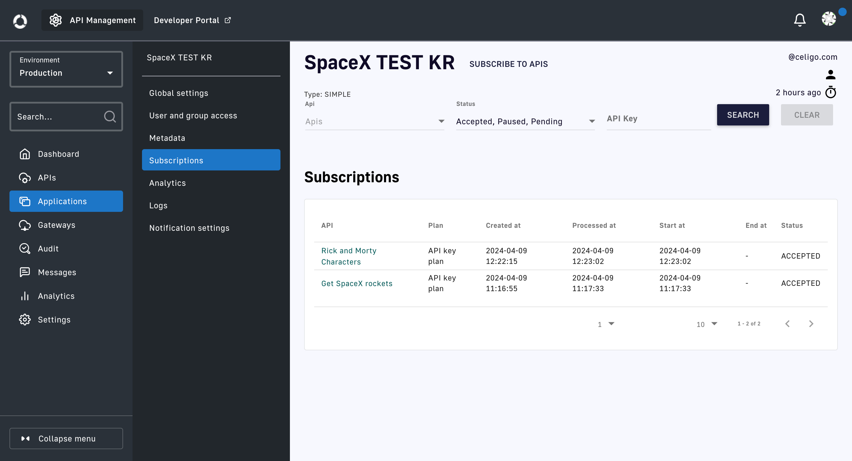

Manage subscriptions
When you create new plans, you can specify auto-validation of subscriptions so API consumers can access the API as soon as they subscribe to the plan. If you use manual approval, you must manually approve all subscriptions.
For v4 APIs, manage a specific API's subscriptions at Consumers → Subscriptions, where you can filter by plan, application, status, or API key, export the list as a CSV, or create a subscription on a consumer's behalf.
