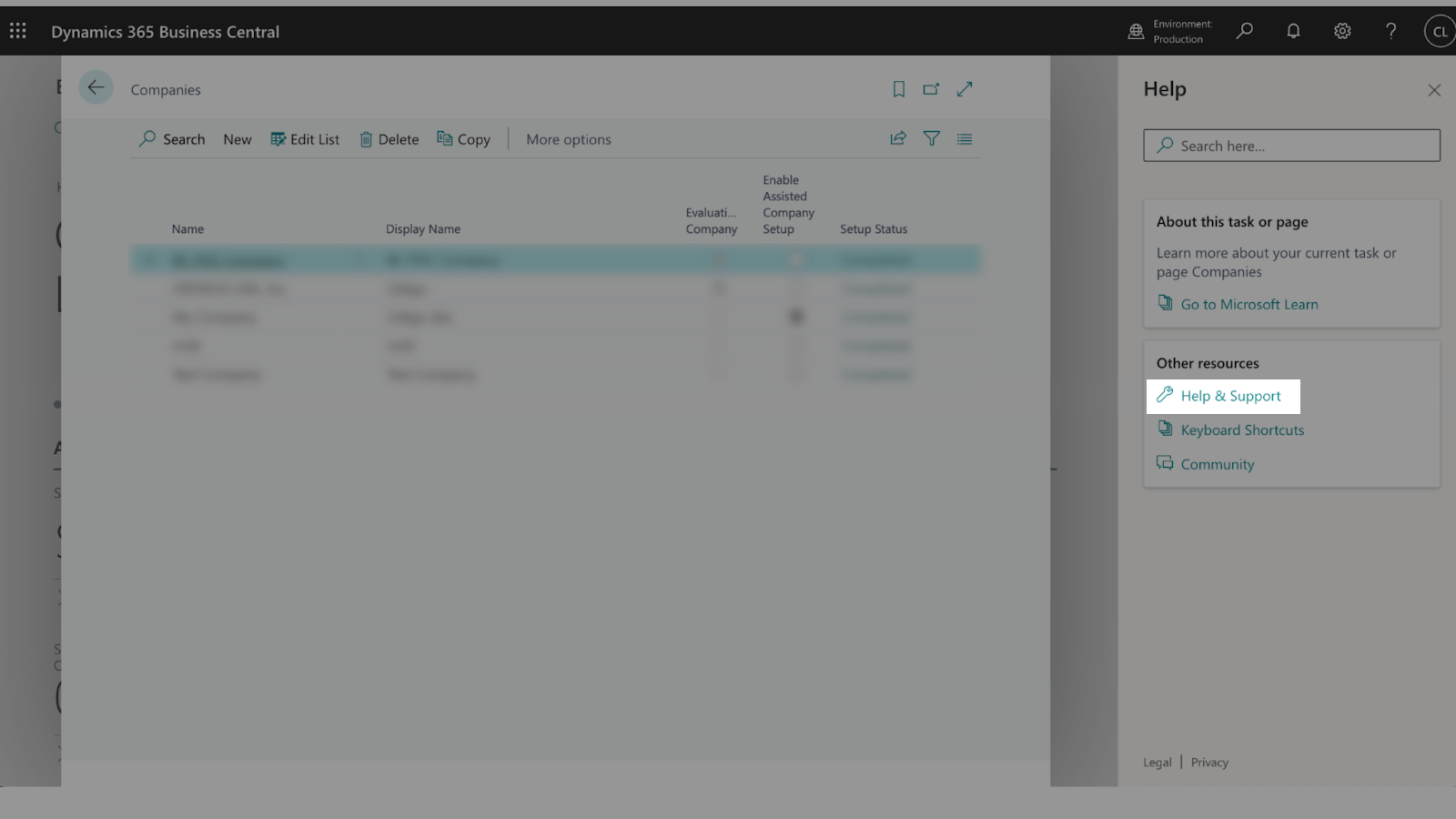

- Navigate to your company in Microsoft Dynamics 365 Business Central.
Select the “?” on the top of the page and select Help and Support on the right-hand side of the page.

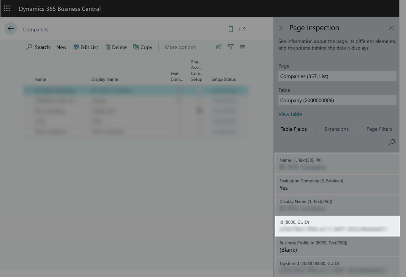

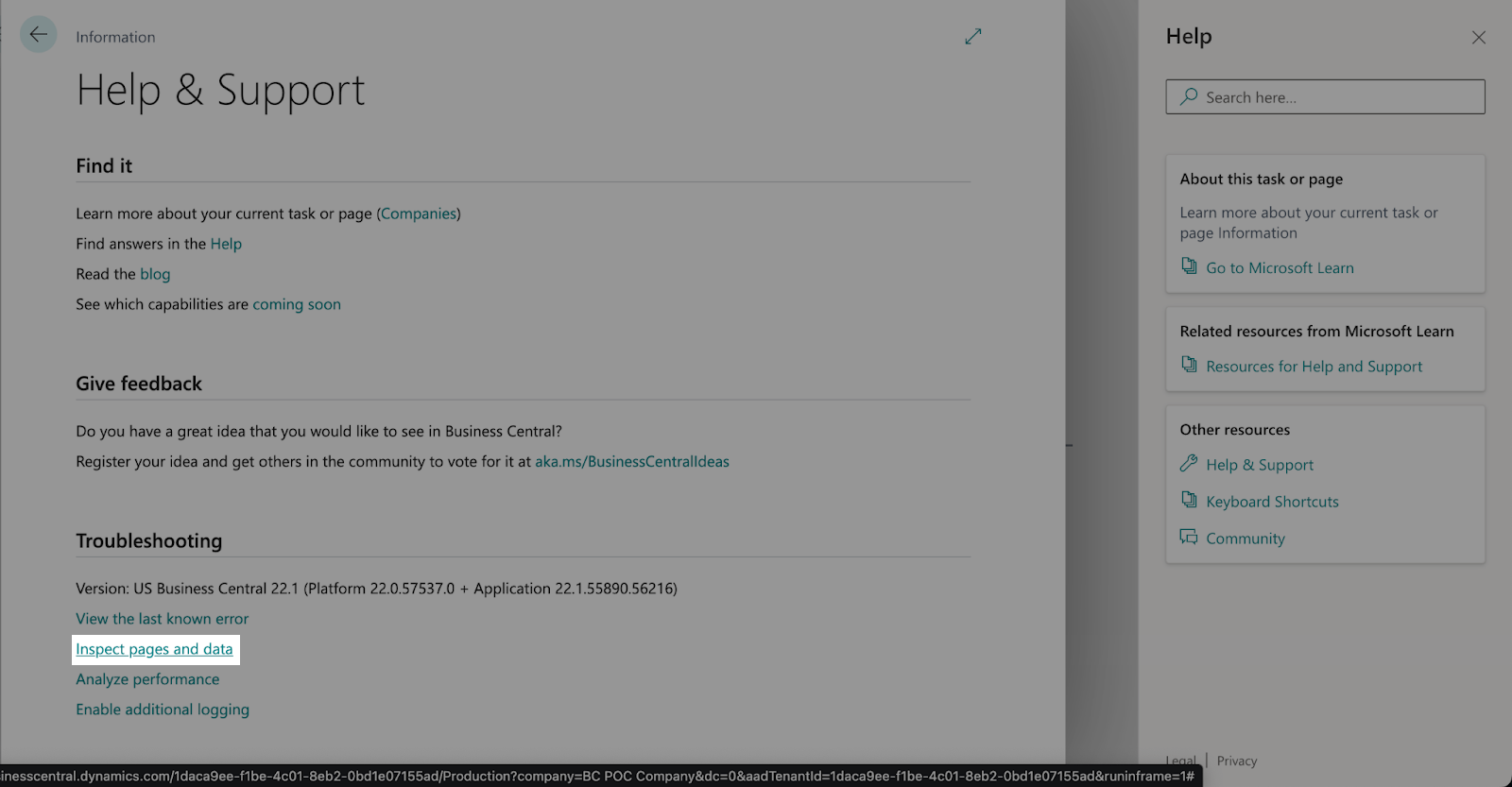

Select Inspect pages and data.
Find the internal ID, labeled id or guid, on the right-hand side of the page.
