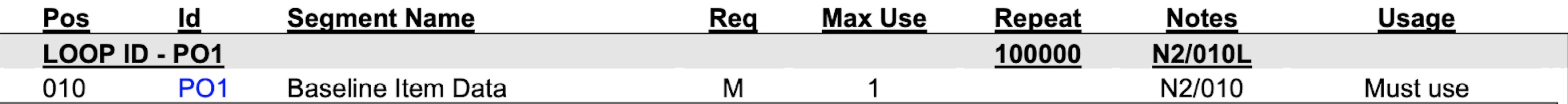

Loops
A loop is a logical group of segments that can have sub-loops with other groups of segments. Loops can have mandatory and optional segments. The first segment listed in the loop is mandatory.
EDI spec for Loop
Each Loop can contain one or more types of segments
Example of Loop rule structure for X12
"name": "PO1",
"maxOccurrence": 100000,
"container": true,  "children": [
      "skipRowSuffix": true,
      "required": true,
      "elements": [
          "name": "PO1",
          "value": "PO1"
          "name": "Assigned Identification",
          "value": "PO101",
          "maxLength": 5,
          "minLength": 1,
          "type": "String",
          "required": true

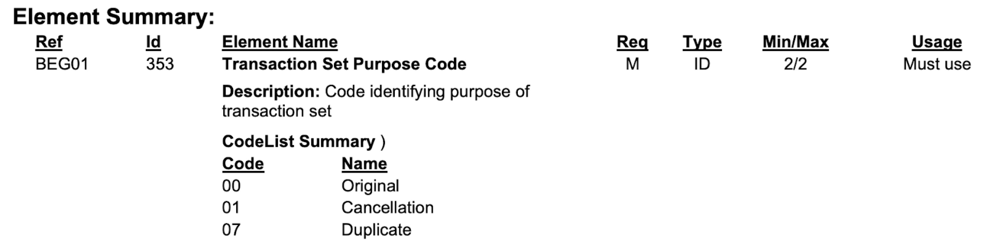

Codelist
An array of objects holds the possible set of values permitted for a field. The enum field includes the expected set of values to be validated against.
EDI spec for Codelist
Example of Codelist rule structure for X12
  "name": "Entity Identifier Code",
  "value": "BEG01",
  "type": "String",
  "maxLength": 5,
  "minLength": 1,
  "required": true,
  "enum":
         "00",
         "01",
         "07"
