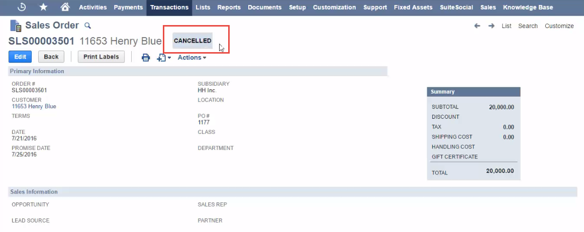

To export fully canceled orders from NetSuite to Shopify:
- In NetSuite, cancel the desired Shopify order.
- Go to the Flows tab of your Shopify - NetSuite Integration App; then click Cancellation.
- Click the Run button corresponding to the NetSuite Cancellation to Shopify Cancellation Add flow.
The fully canceled Shopify orders are fetched from NetSuite based on the criteria defined in the NetSuite Saved Search that is present as a drop-down list box (NetSuite Saved Search for syncing order cancellations) under the Settings > Cancellation section and sent to Shopify. Thus, keeping NetSuite and Shopify in sync.
Note: Once the selected order is closed, the Closed statuses of all the line items are moved to YES.
Once you have configured the flow correctly, on execution, all the canceled orders will be fetched from NetSuite and synced to Shopify. The status of the flow appears on the integration dashboard.
Note: The ETAIL CANCELLED ORDER EXPORTED checkbox under the eTail tab gets selected when the canceled order is fetched from NetSuite to Shopify.
