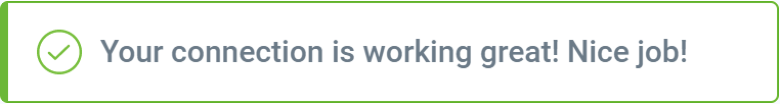

After configuring the settings, click Test Connection. When the connection is verified, you will receive the following message:
The connection is now added to your account. You can see it listed under Resources → Connections. If a connection is part of an integration, you can see it listed under Home → Integration name → Connections, and you may proceed to register the connection.
