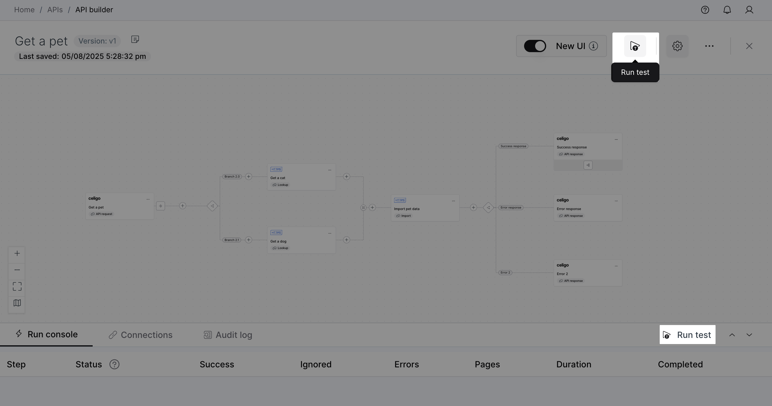

To run a test, select Run test in either of these places:
  • The API builder toolbar
  • The Run console panel
Run test button in the API builder toolbar and in the Run console panel

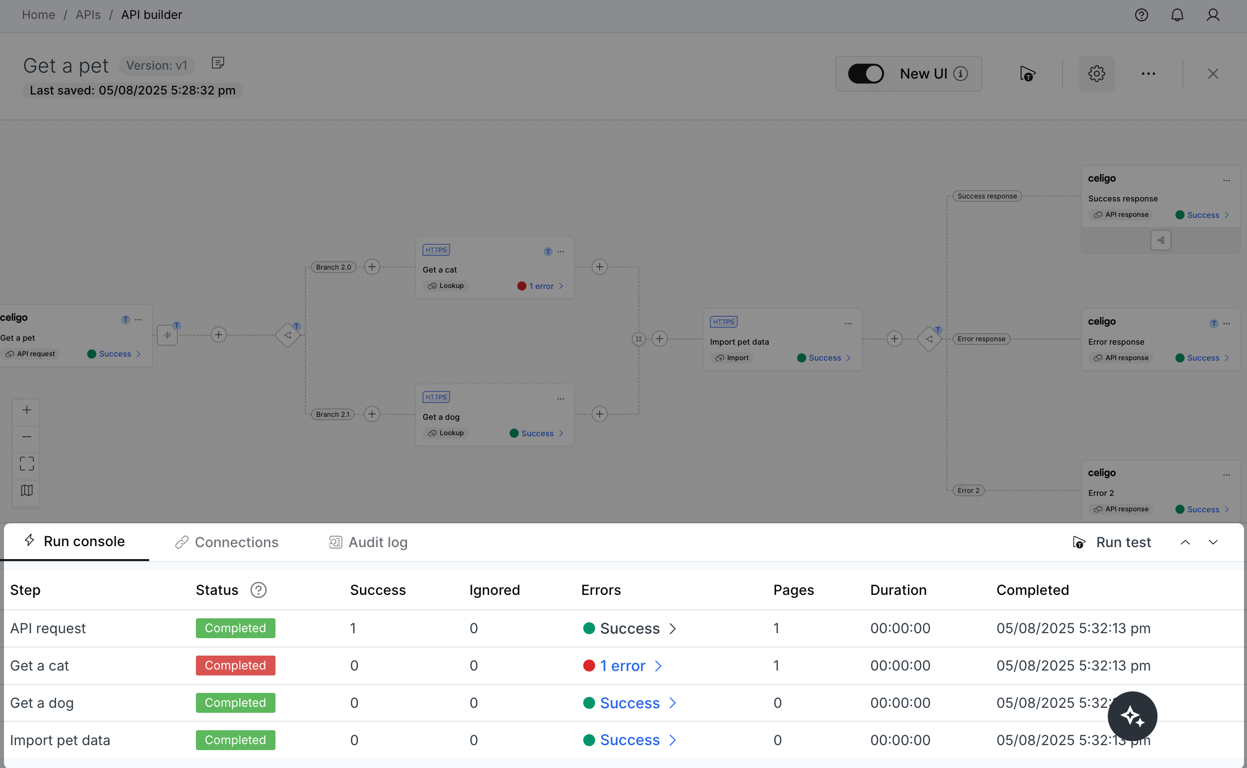

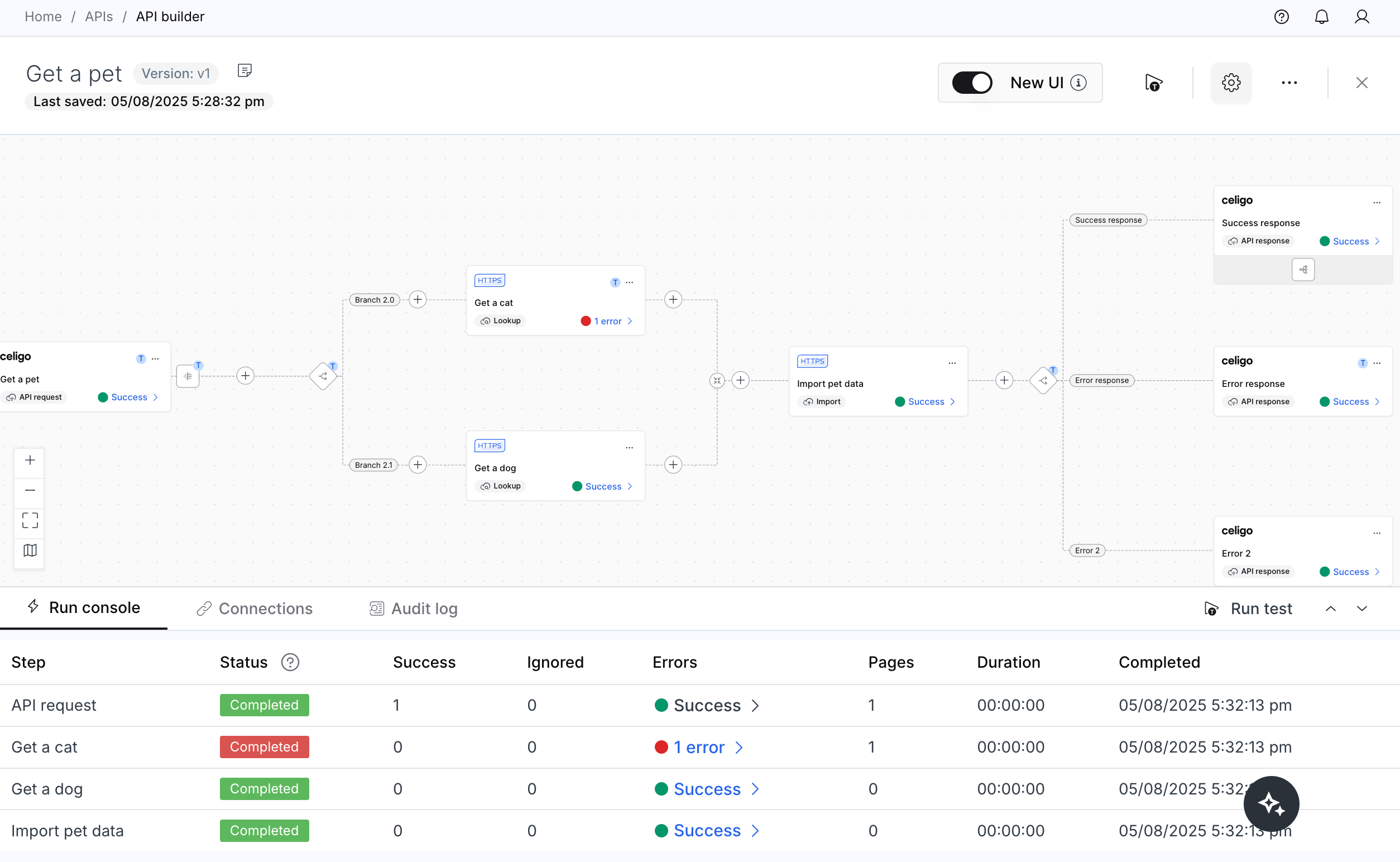

The Run console, the first tab under the API canvas, shows each step's status and errors as your API runs, even before the run finishes.
The Run console reflects the status of the most recent run or the run currently in progress. Error counts don't change when you start resolving errors.
Run console showing the status, errors, and duration of each step

  2. When the test finishes, review the Run console to see where errors occurred.
    Run console with a step showing 1 error

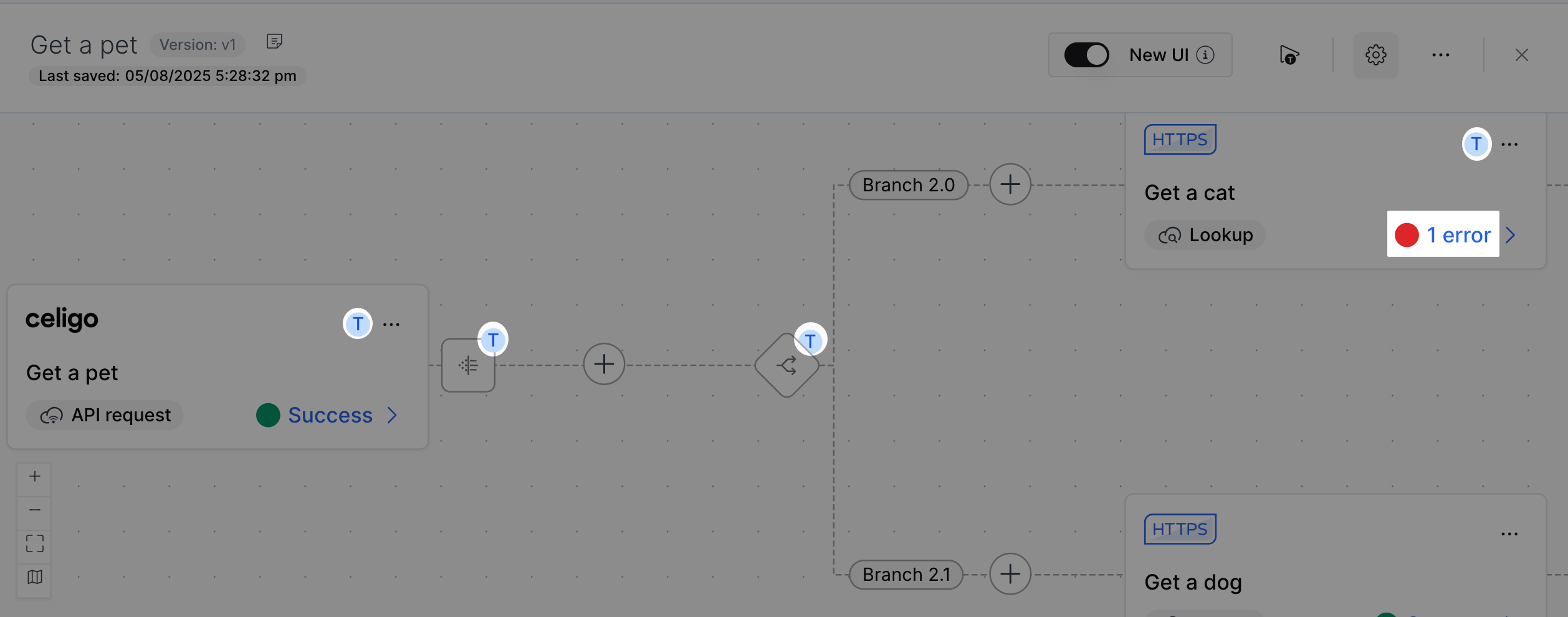

  3. Select the error indicator or the blue T on the step to open the Test run errors window. If a step shows only the blue T, open the step, then select View debug logs.

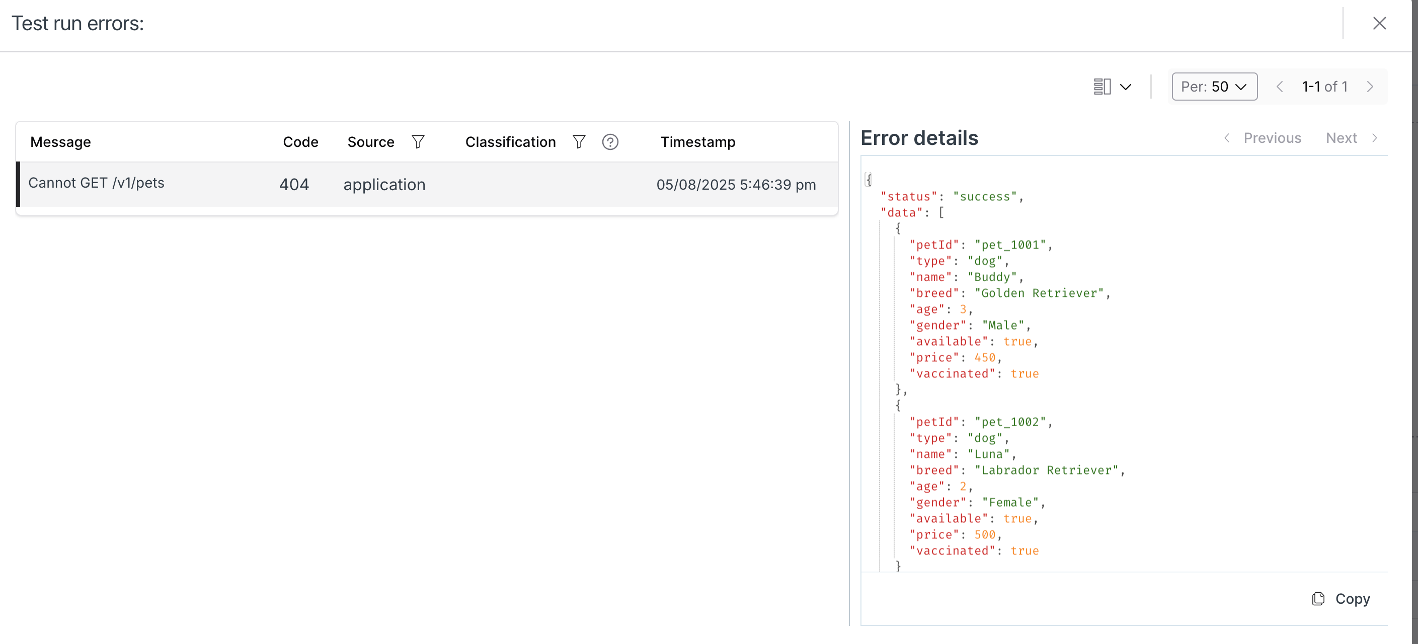

  4. Review the message, code, and source for each error, then select an error to see its details.
    Test run errors window with the error message, code, and error details

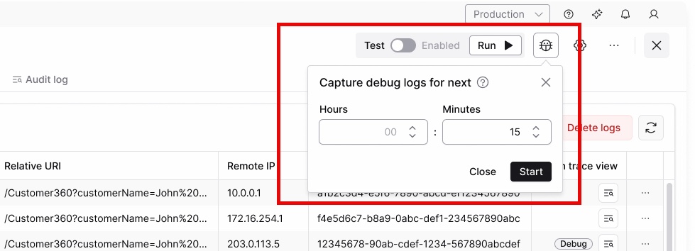

To enable debug mode:
  1. In API builder, select Enable debug mode in the toolbar.
  2. In the Capture debug logs for next panel, enter a duration in hours and minutes.
  3. Select Start.
Capture debug logs for next panel with hours and minutes fields and a Start button
Debug mode takes effect immediately, and every request received during the active window is logged at the Debug level. To view the captured logs in the Request history tab, see View API request and execution logs in API builder.
