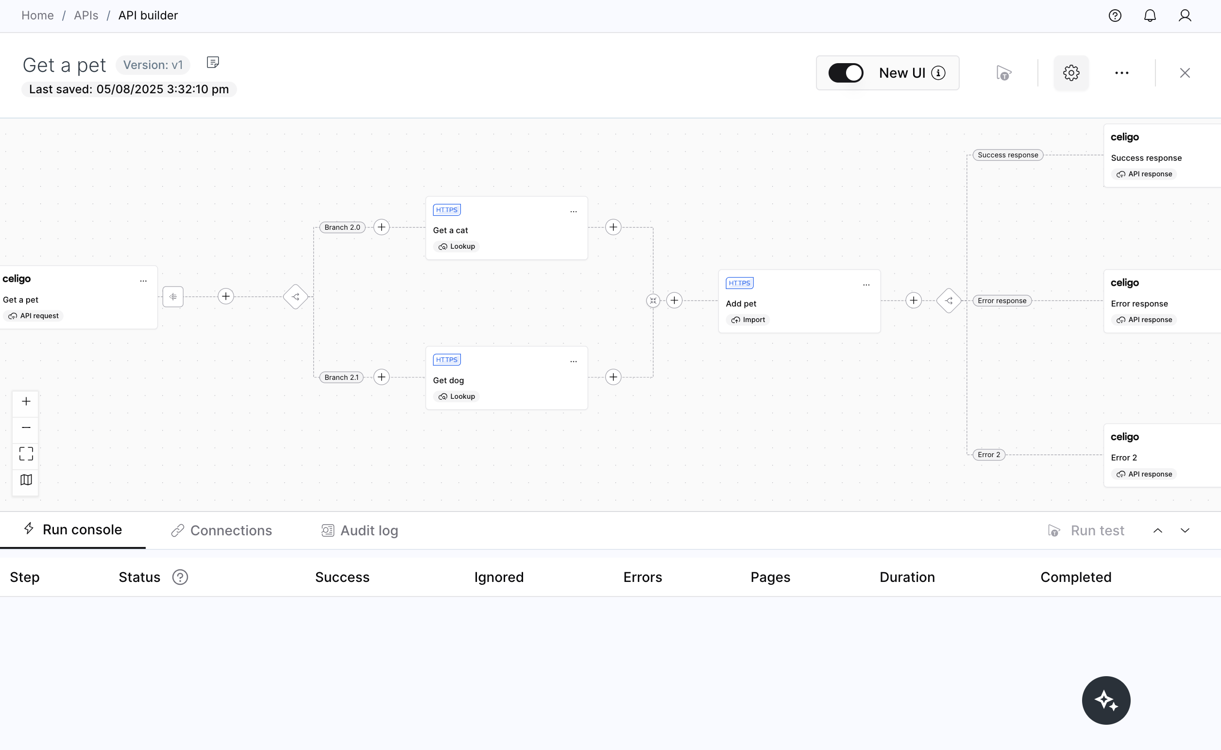

Add a step
  1. Go to Build build-icon.png, and then select APIs. Open your API. If you haven't created one, see Create and manage APIs using API builder.

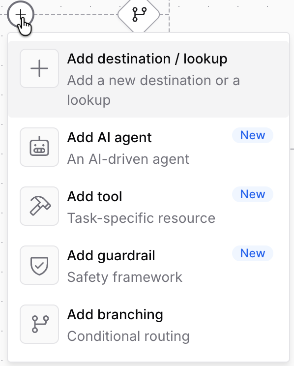

  2. On the canvas, select + to the right of the API request or after the step where the new step belongs.
  3. Select Add destination / lookup, Add AI agent, Add tool, or Add guardrail.
    The step menu in API builder
  4. Create a new step, or reuse an existing one.

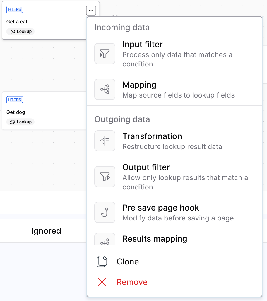

Each step has a menu with the following components. Select a component to configure it. A component that is already configured is marked in the menu.
Menu item Available on What it does
Input filter Imports, lookups, AI agents Processes only records that match a condition.
Pre map hook Imports, AI agents Runs a script before mapping.
Mapping Imports, AI agents Maps source fields to destination fields. See Mapping data in API builder.
Post map hook Imports, AI agents Runs a script after mapping.
Post submit hook Imports, AI agents Runs a script after records are submitted.
Transformation Imports, lookups, AI agents Restructures the result data.
Output filter Lookups Keeps only lookup results that match a condition.
Pre save page hook Lookups Runs a script before the lookup results are saved.
Response mapping Imports, AI agents Adds the import response to the records. See Mapping data in API builder.
Results mapping Lookups Merges the lookup results into the records. See Mapping data in API builder.
Post response map hook Imports, lookups, AI agents Modifies data after response or results mapping.
Error handling Imports, lookups, AI agents Defines what happens to a record that fails. See Failed records.
