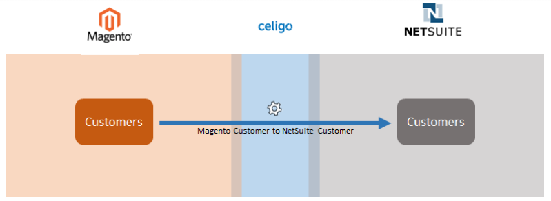

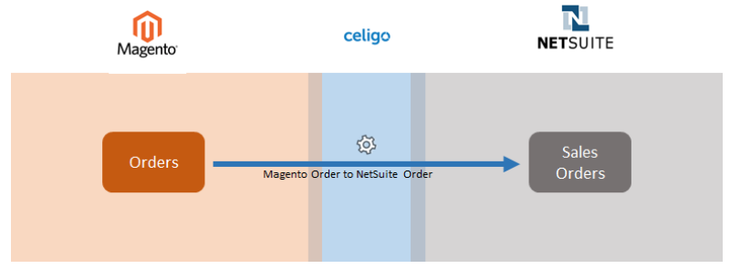

Sync your Magento orders
You can sync your Magento orders to NetSuite sales orders using the "Magento Order to NetSuite Order" flow. When the order is synced to NetSuite, the Magento order ID is present in the PO# field in the NetSuite sales order.
If the customer associated with the order is absent in NetSuite, the flow triggers the "Magento Customer to NetSuite Customer" flow to sync the Magento customer name to NetSuite customer.
Configure and run the order flow for tax-exclusive store
  2. Click the Magento 2 - NetSuite Integration App tile.
  3. Go to Flows > Order .
  4. Enable the "Magento Order to NetSuite Order" flow and the "Magento Customer to NetSuite Customer" flow.
  5. Click Run (Run_flow.svg), to the right of the "Magento Order to NetSuite Order" flow.
If everything is configured correctly, Magento order will be synced to NetSuite customers whenever you create a new order. You must schedule the flow so that the flow runs at regular intervals to fetch newly created orders.

Sync your Magento customers
You can sync your Magento customers to NetSuite customers using the "Magento Customer to NetSuite Customer" flow. This flow helps you sync both new as well as existing customer updates to NetSuite. By default, the flow syncs customer details, billing, and shipping address. If you want to sync any additional details, you can modify the field mappings of the flow.
When the sync is successful, the "Celigo Magento 2 Customer Id Map List" record stores the ID maps of the customers synced.
