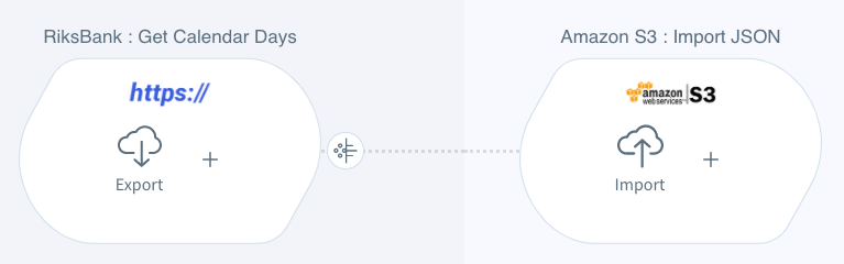

In this section, we'll build the flow to take calendar details from RiksBank, convert the payload to JSON, and put that into a file on S3.
Below is a visual representation of the final result of the flow:
Pay close attention to the Resource Path as it is the key part that tells the platform how to convert the response XML to an equivalent (basic) JSON payload. For an example of what the response looks like in XML, see RiksBank documentation.

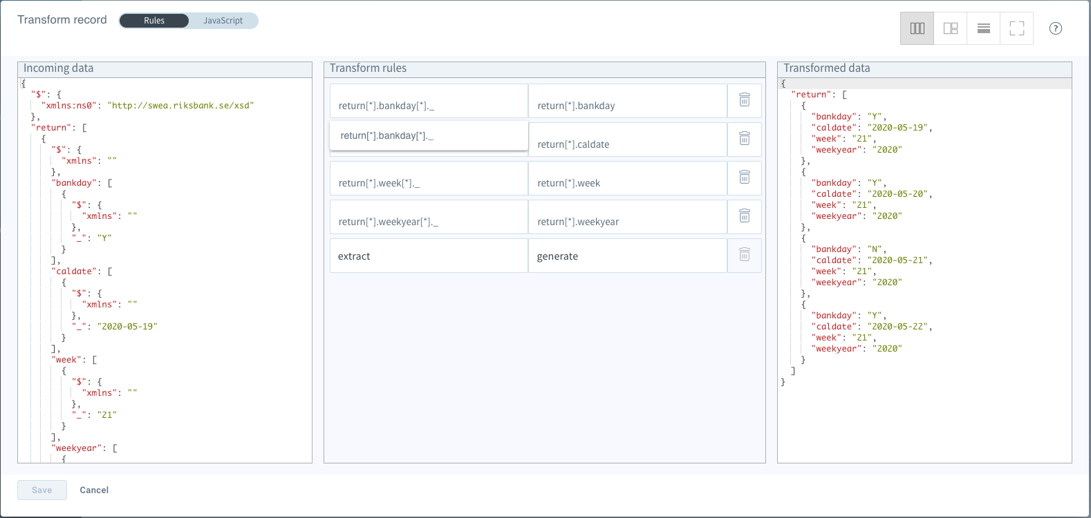

This step defines how integrator.io cleans (or transforms) the basic JSON payload (from step 1) into a more human-friendly structure. Below are the details of the transformation.
Export |
Import |
return[*].bankday[*]._ |
return[*].bankday |
return[*].caldate[*]._ |
return[*].caldate |
return[*].week[*]._ |
return[*].week |
return[*].weekyear[*]._ |
return[*].weekyear |
Here's an example of what your end result should look like.
