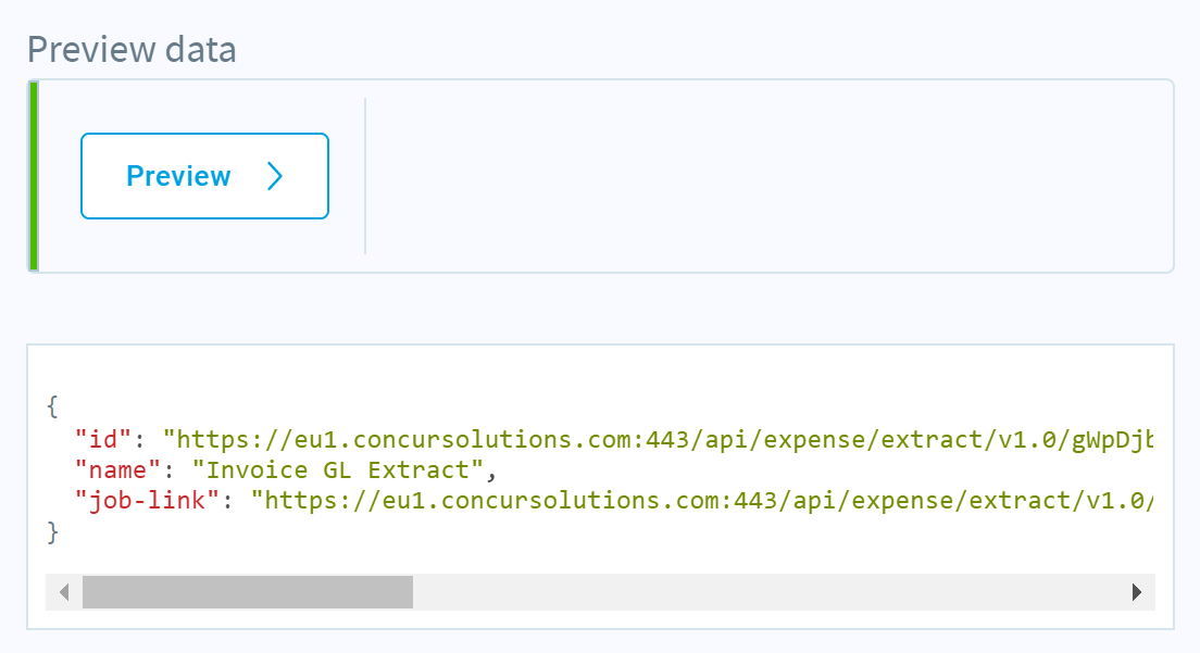

    1. Create an export using one of the built-in template connections.
    2. Select Common: Extracts for the API name, and select GET a list of extract definitions for its Operation.
    3. Click Preview to view the sample data.
    4. Copy the definition ID, which is related to the payment request or expense report in your Concur account, after v1.0/ in the id field. For example, in the following JSON value, the ID is in boldface:
      "id":
      "https://eu1.concursolutions.com:443/api/expense/extract/v1.0/gWpDjbSfrnRKh$pezIz45jgKb0Wc8iUYBBqg"

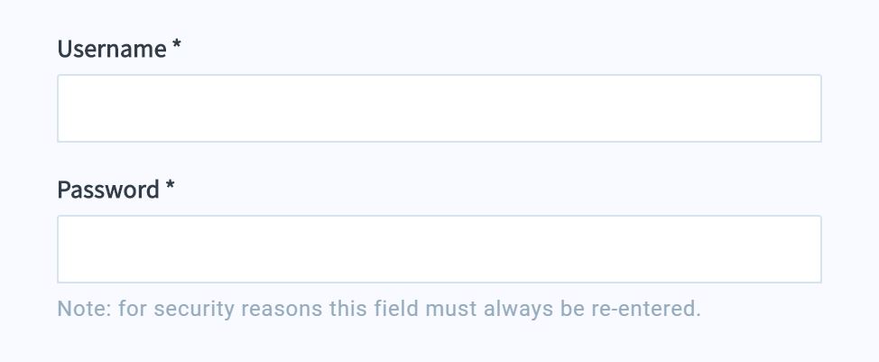

      Q2. My regular Concur account username and password aren’t working for the template connection. How can I set up the connection?
      A. In this case, the Username and Password are not those that you use to sign in to your Concur account.

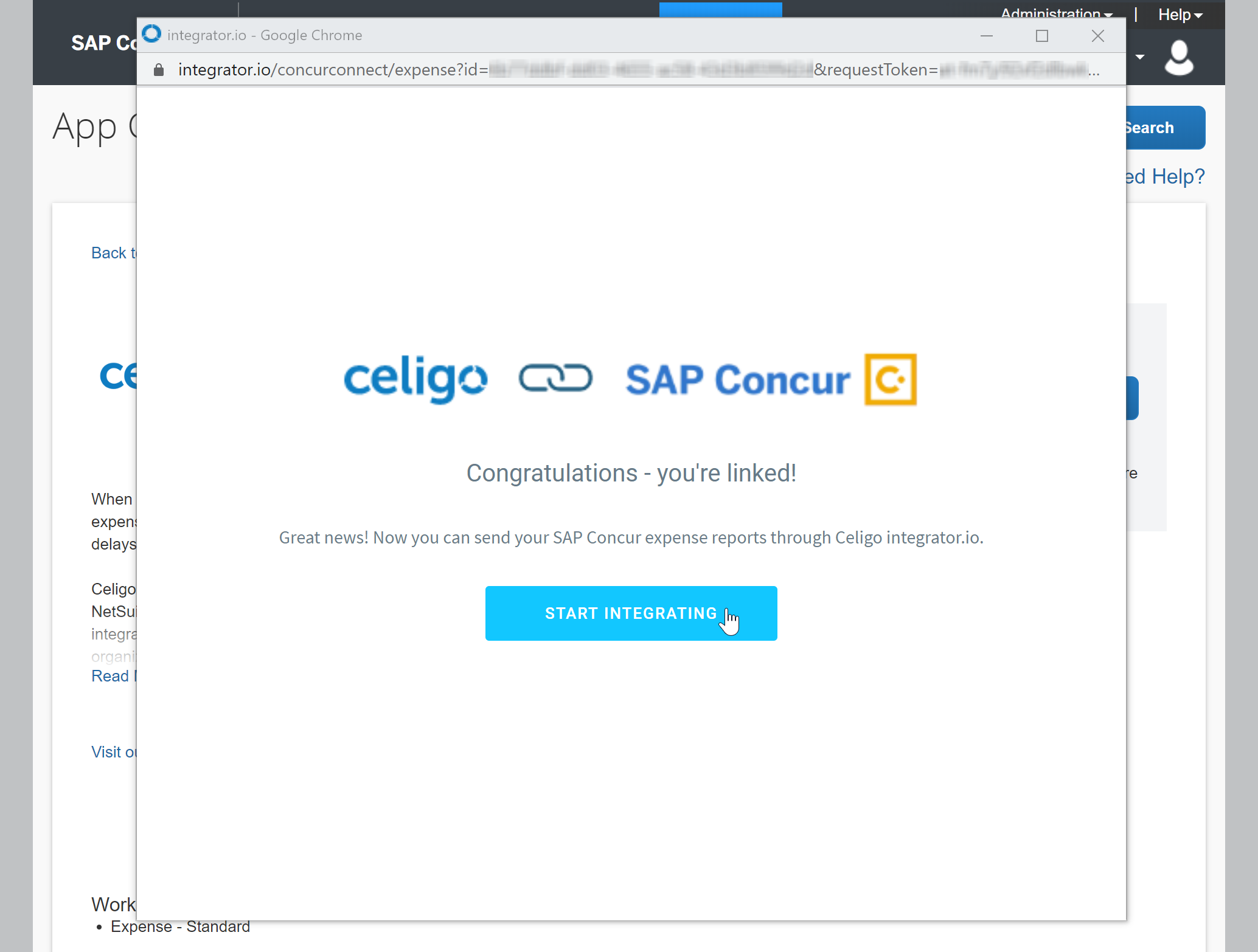

      These values refer to step 6 of the Concur template installation instructions, in which you began the process by selecting an ERP app at the SAP Concur App Center.
      Copy the URL from this confirmation page that appeared when you were asked to sign in to integrator.io upon agreeing to Concur’s terms. You will need the id= and requestToken= values below in order to establish your Concur connection’s username and password.

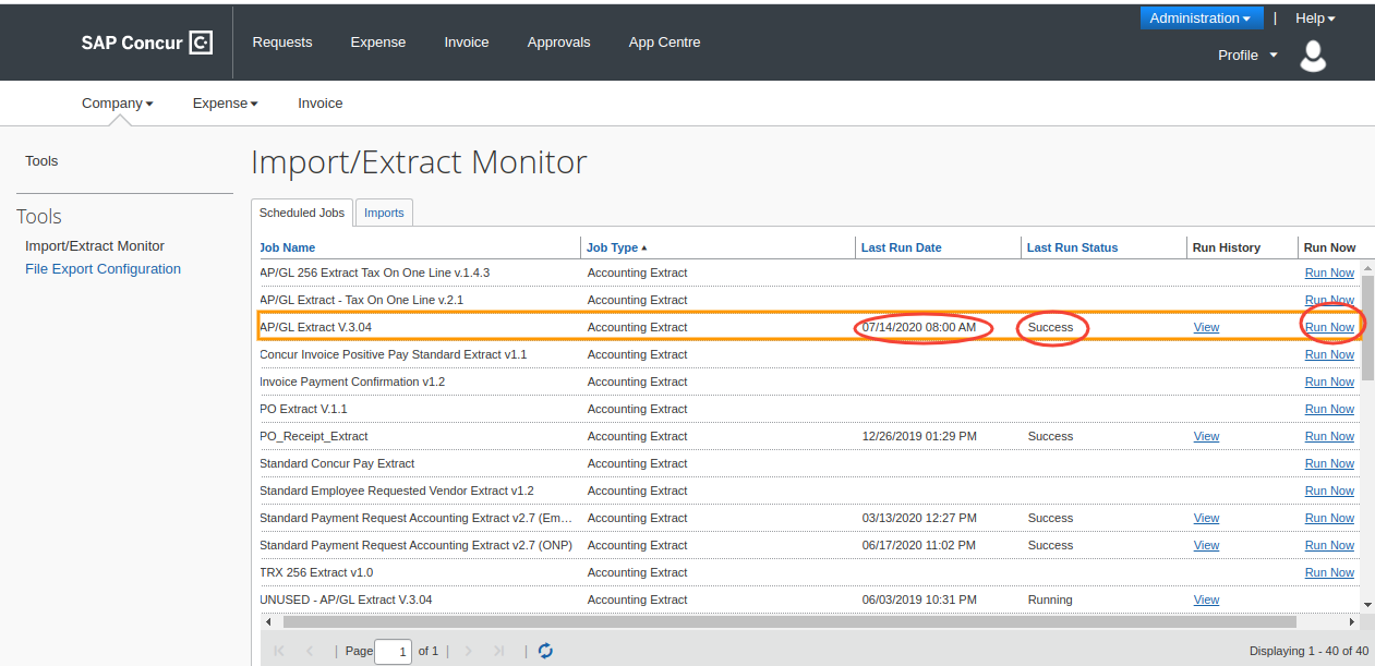

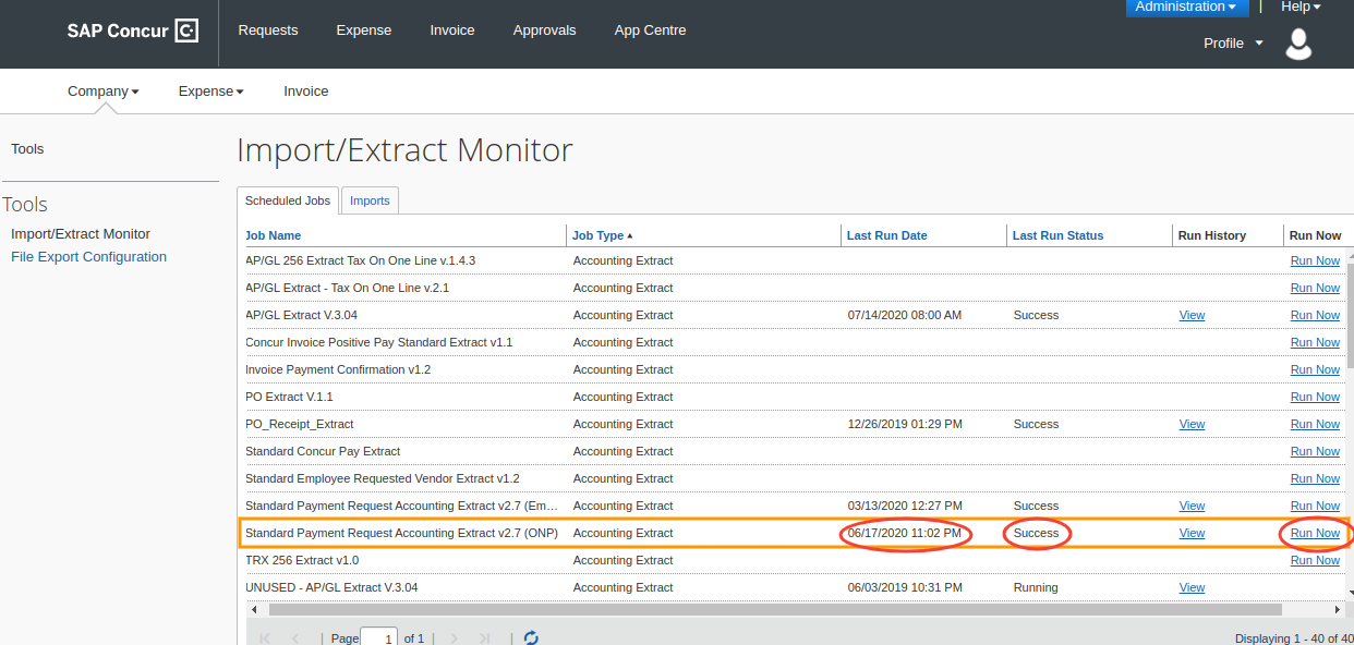

      First follow these steps to run a Payment request job in Concur:
      1. Sign in to your Concur account.
      2. Go to Administration > Company > Tools.
      3. Under Import/Extract monitor, select the job related to the payment request.
      4. Click Run now
      5. Verify that the Definition for the payment request or expense report is enabled, reporting Success:
      For expense reports
      For Invoice payment requests
      Note: The jobs shown above are for example purposes only, corresponding to a payment request in a Celigo account. The names will vary for your Concur configuration.
