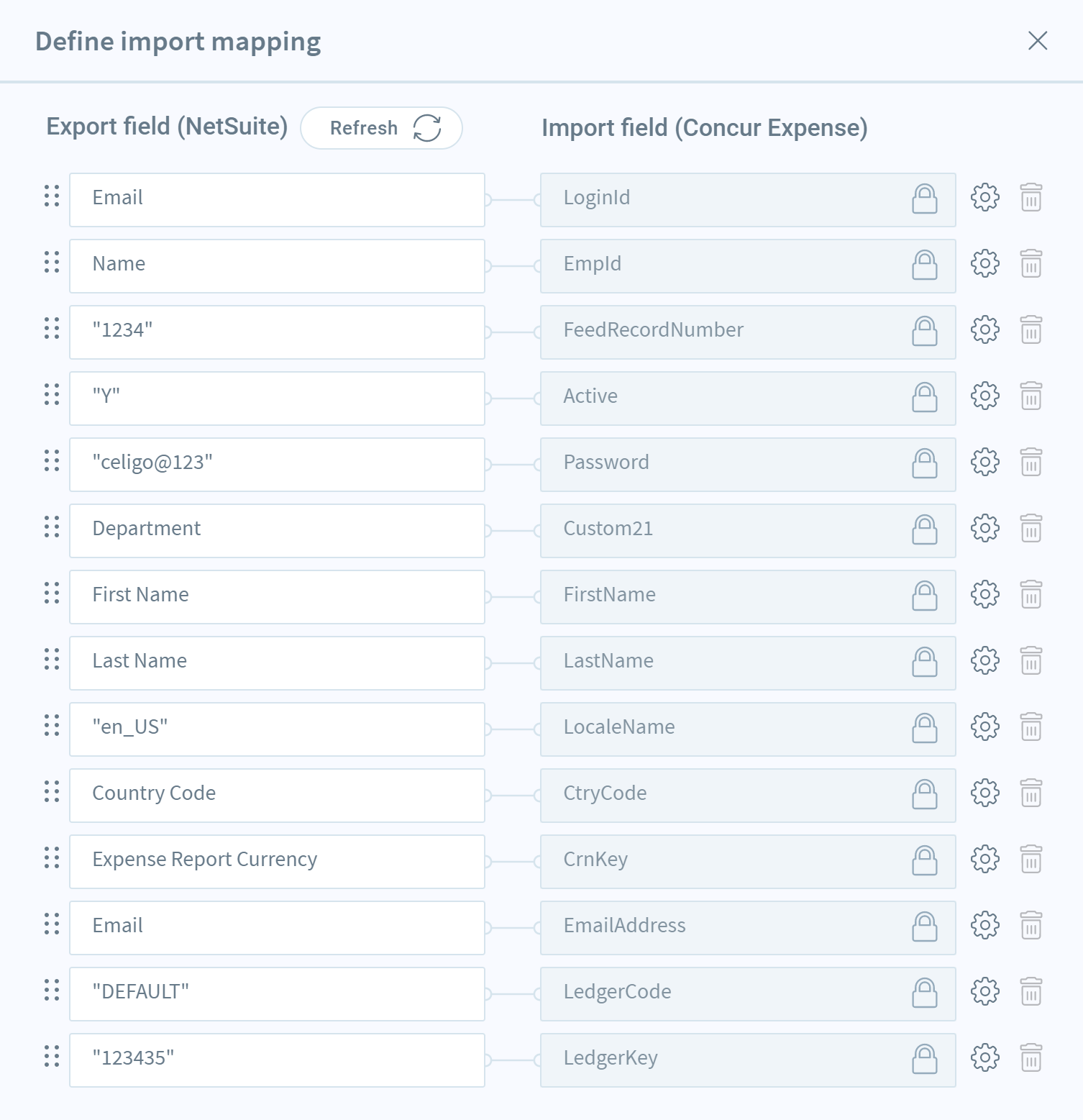

NetSuite employees to Concur users
This integration flow syncs NetSuite employees as Concur users.
Applies to
  • Concur Invoice (Enhanced) – NetSuite Quickstart integration template
  • Concur Invoice (Best Practice) – NetSuite Quickstart integration template
Flow details
  • Export source: NetSuite
  • Import destination: Concur
  • Built-in export: Get NetSuite employees – get all employees from NetSuite that have been modified since this flow last ran
  • Built-in lookup: Get Concur Invoice user by email – get user from Concur Invoice using email as an identifier
  • Built-in lookup: Import Concur Invoice user by email – Get user roles for existing user in Concur Invoice using user id as identifier
  • Built-in import: Import Concur users – add or update users into Concur
Before you begin
The NetSuite department name should be the same as the Concur List item name.
Setup instructions
  1. Configure hard coded mapping for Active, Value, Type, Entitlements, and CompanyID in Import Concur users.
  2. Configure static map for CtryCode in Import Concur users.
