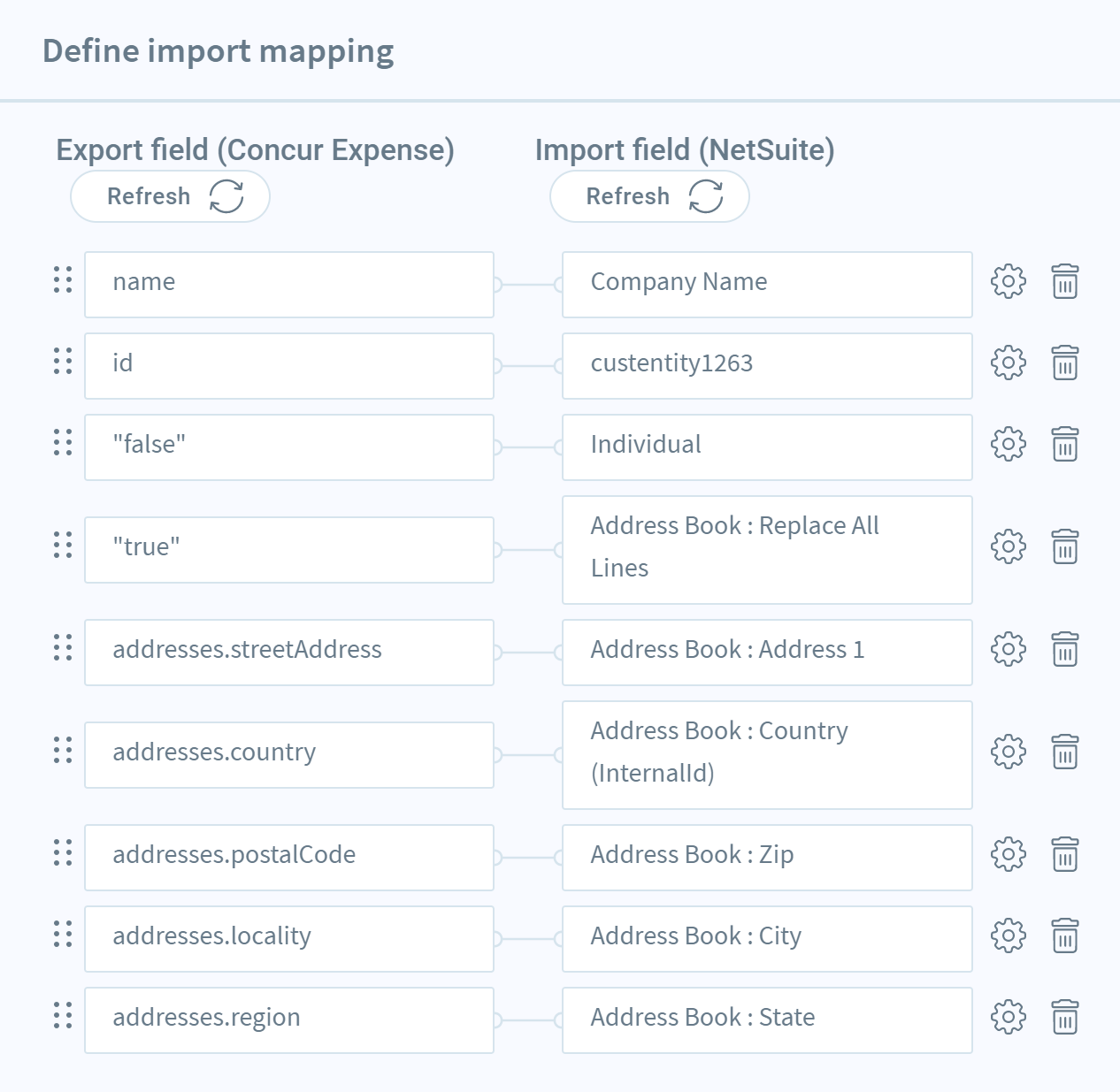

  1. Add subsidiary mapping to Import NetSuite customer.
  2. Configure mapping for Individual and Address Book: Replace All Lines in Import NetSuite customer.
Field mappings: Import NetSuite customer

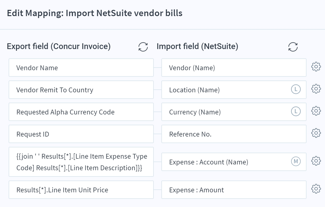

Concur invoices to NetSuite vendor bills (Best Practice)
This integration flow syncs Concur invoices with NetSuite as vendor bills for Standard Concur accounts.
Applies to
  • Concur Invoice (Best Practice) – NetSuite Quickstart integration template
Flow details
  • Export source: Concur
  • Built-in export: Get Concur definition details – get definition details from Concur that have been modified since this flow last ran
    • Built-in preSavePage hook: ConcurPaymentRequest.js – parse links to job files
  • Built-in lookup: Get Concur invoice details by job ID – get all invoice details from Concur
  • Built-in import: Import NetSuite vendor bills – add (or ignore) vendor bills into NetSuite with Reference No. as the lookup identifier
Before you begin
  1. The NetSuite vendor name and the Concur vendor name should be the same.
  2. The NetSuite Expense Account Name and the Concur Expense Type should be the same.
  3. The NetSuite Expense Account Number and the Concur Expense Type ID should be the same.
  4. Add the Definition ID of your Invoice Definition to NetSuite.
Setup instructions
Configure static mapping for Location and Currency in Import NetSuite vendor bills.
Field mappings: Import NetSuite vendor bills

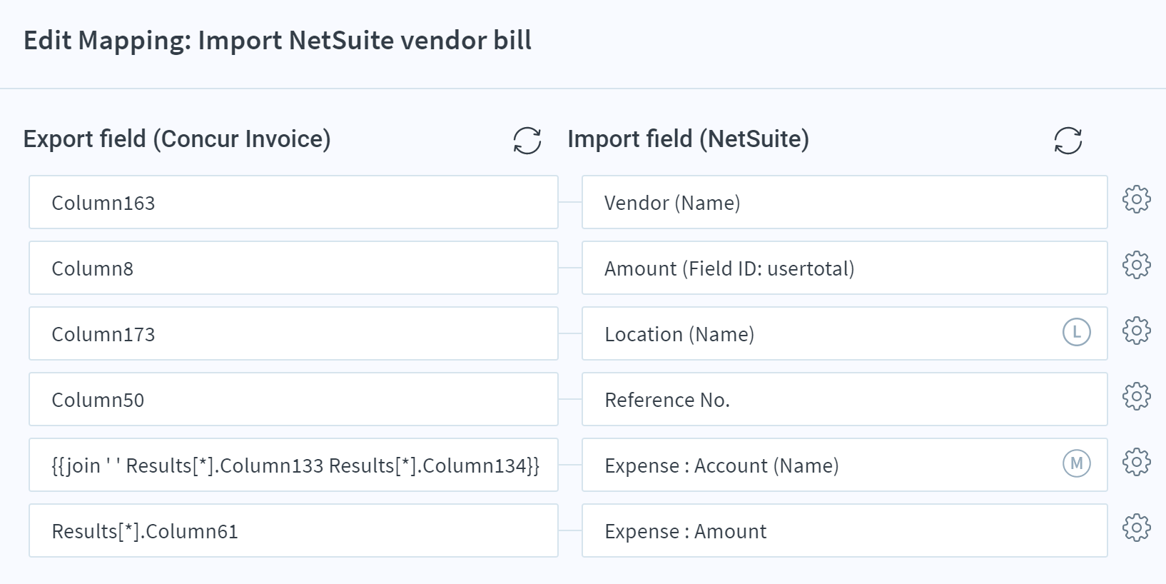

Concur invoices to NetSuite vendor bills (Enhanced)
This integration flow syncs Concur invoices with NetSuite as vendor bills for Professional Concur accounts.
Applies to
  • Concur Invoice (Enhanced) – NetSuite Quickstart integration template
Flow details
  • Built-in export: Get Concur definition job details – Get all job details from Concur that have been modified since this flow last ran
  • Built-in import: Import NetSuite vendor bills – add (or ignore) vendor bill into NetSuite with Reference No. as the lookup identifier
Before you begin
Setup instructions
Configure static mapping for Location in Import NetSuite vendor bills.

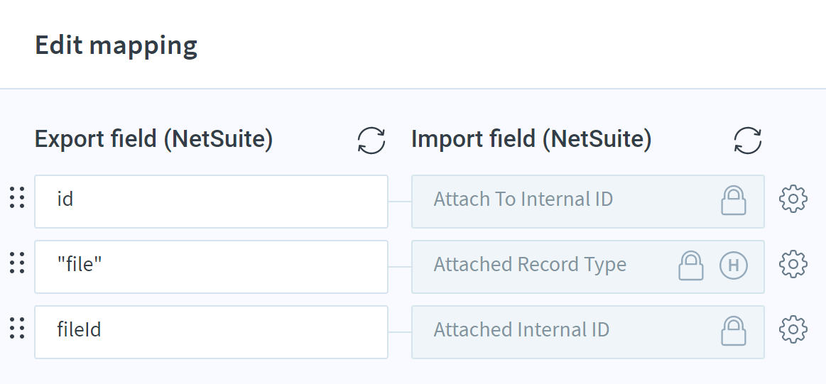

Concur invoice images to NetSuite vendor bill images
This integration flow adds Concur invoice images into NetSuite as vendor bill images for Professional and Standard Concur accounts.
Applies to
Flow details
  • Built-in export: Get NetSuite bills – get all bills from NetSuite that have been created since this flow last ran
  • Built-in lookup: Get Concur invoice image by request id – get invoice image from Concur by request id
  • Built-in file transfer (download): Get Concur invoice image by image url – get all invoice images from Concur by image url
  • Built-in file transfer (upload): Import NetSuite images as File Cabinet – add images into NetSuite
  • Built-in import: Import NetSuite images into bills – attach images into NetSuite bills
Before you begin
  1. Expense reports should be the same in Concur and NetSuite.
  2. The Concur expense report ID should be stored as a Reference number in NetSuite expense reports.
Setup instructions
Configure mapping for Attached Record Type in Import NetSuite images into bills according to your Concur setup.
Field mappings: Import NetSuite images into bills

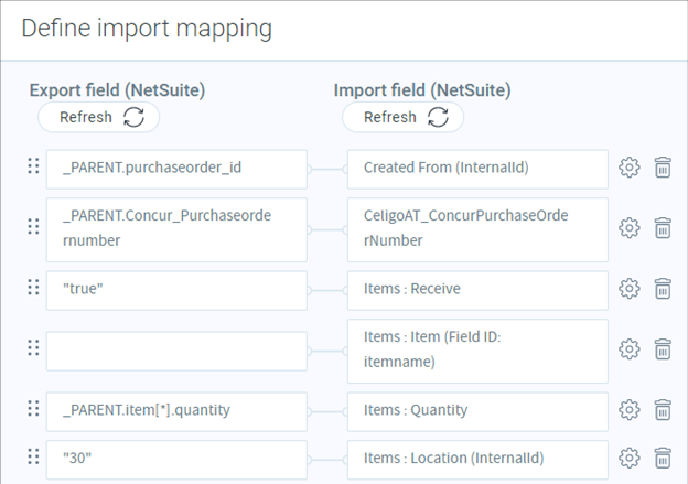

  1. Configure mapping for Items : Receive and Items : Location (InternalId) in Import NetSuite item receipts.
  2. Configure a dynamic map for Items : Item (Field ID: itemname) in Import NetSuite item receipts.
Field mappings: Import NetSuite item receipts

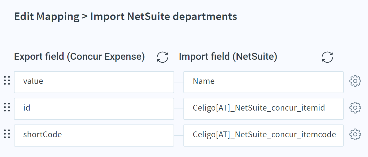

Concur lists to NetSuite departments
This integration flow syncs Concur lists as NetSuite departments.

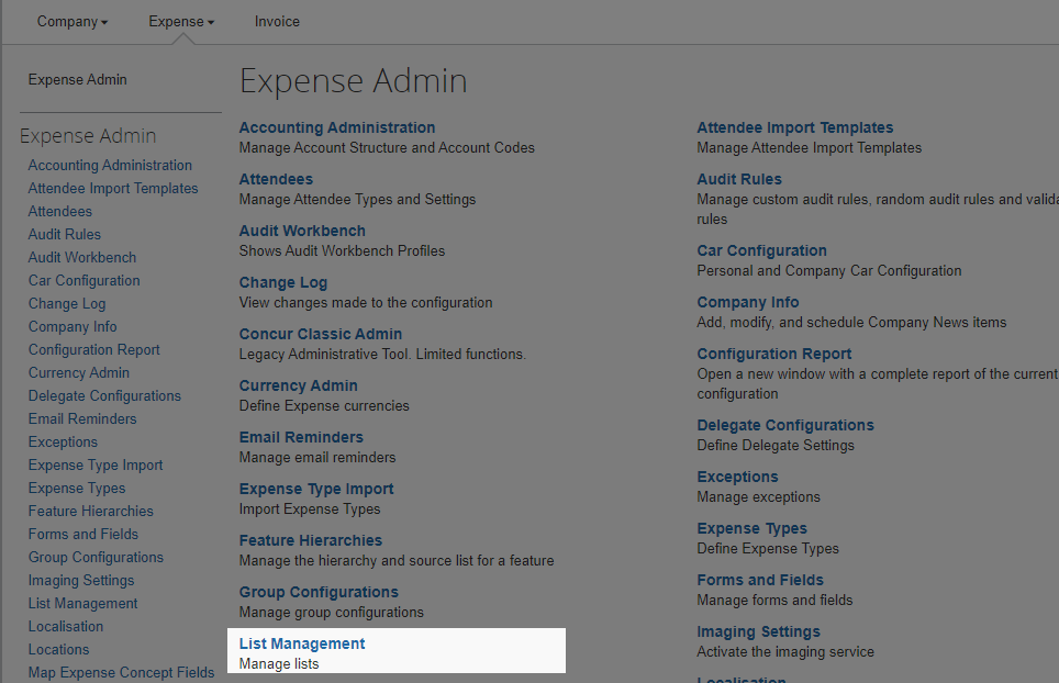

Lists are custom entities, or records, that you set up in Concur. You can create any corresponding NetSuite departments as lists and then associate them with your expenses. To build a list:
  1. Sign in to SAP Concur.
  2. From the Administration menu, select Expense > Expense admin.
  3. On the Expense admin page, click List management.
  1. At the List management page, you can add, update, or delete a list.
Applies to
Flow details
  • Built-in export: Get Concur lists – get all lists from Concur
  • Built-in lookup: Get concur list item by list ID – get a list item from Concur by list ID
  • Built-in import: Import NetSuite departments – add or ignore departments into NetSuite with configured custom field as the lookup identifier
Setup instructions

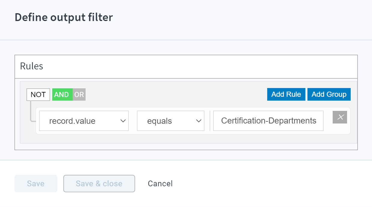

Configure filter rules in Get Concur lists. (The record.value shown below represents the name of the list created in Concur; the department records are inside the Concur list.)
Export filter: Get Concur lists
Field mappings: Import NetSuite departments

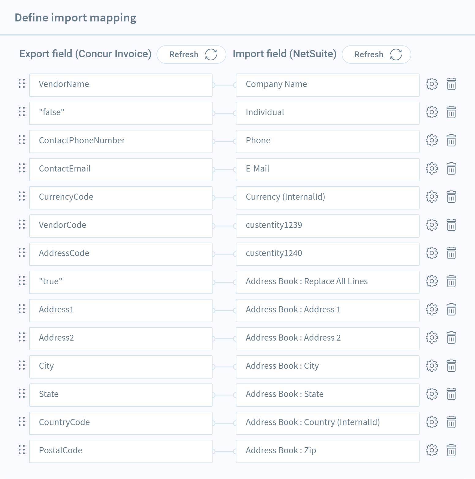

  1. Configure static map for Currency in Import NetSuite vendors.
  2. Add subsidiary mapping in Import NetSuite vendors.
  3. Configure mapping for Address Book: Replace All Lines and Individual in Import NetSuite vendors.
    Field mappings: Import NetSuite vendors

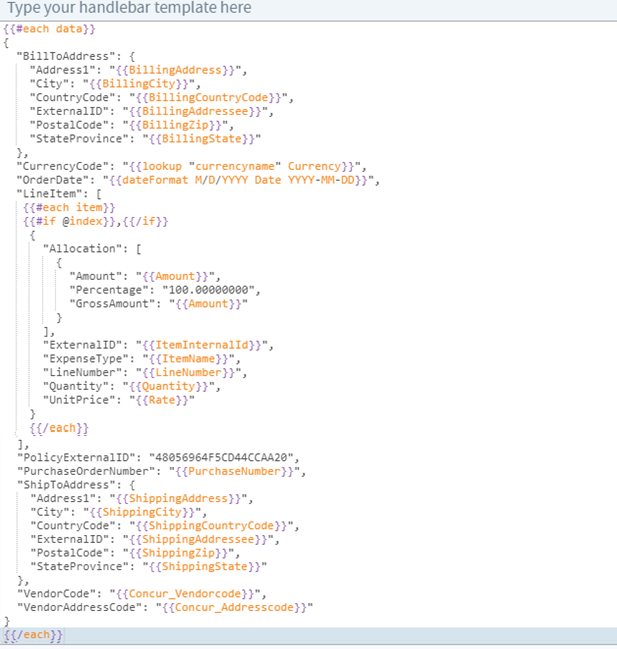

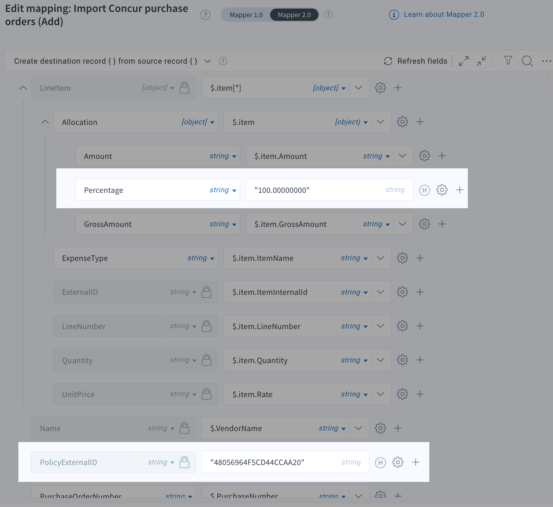

  1. Configure static mapping for Currency in Import Concur purchase orders (Add) and Import Concur purchase orders (Update).
  2. Configure mapping for Percentage and PolicyExternalID in Import Concur purchase orders (Add).
    1.pngField mappings: Import Concur purchase orders (Add)

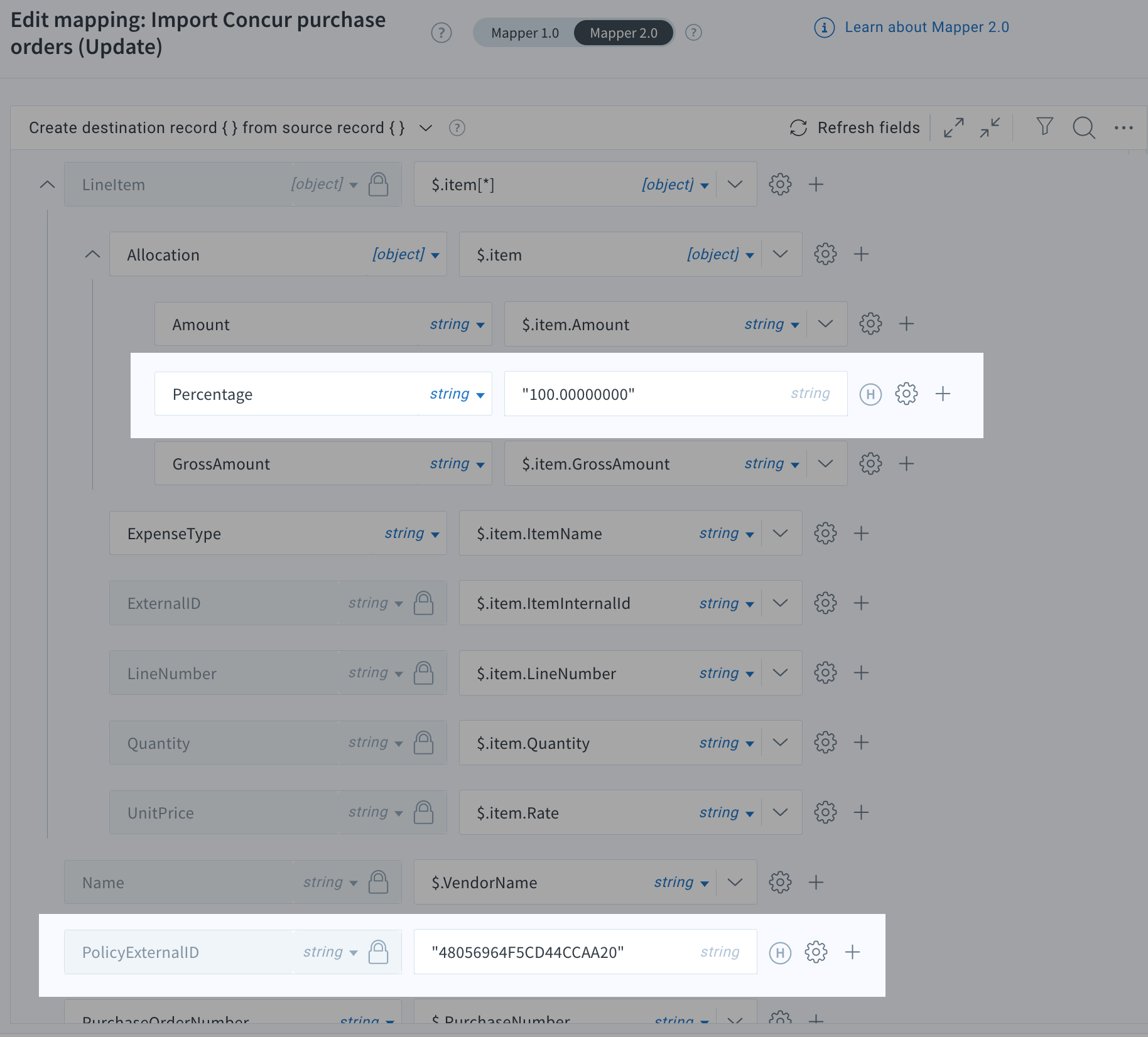

  3. Configure mapping for Percentage and PolicyExternalID in Import Concur purchase orders (Update).
    2.pngField mappings: Import Concur purchase orders (Update)

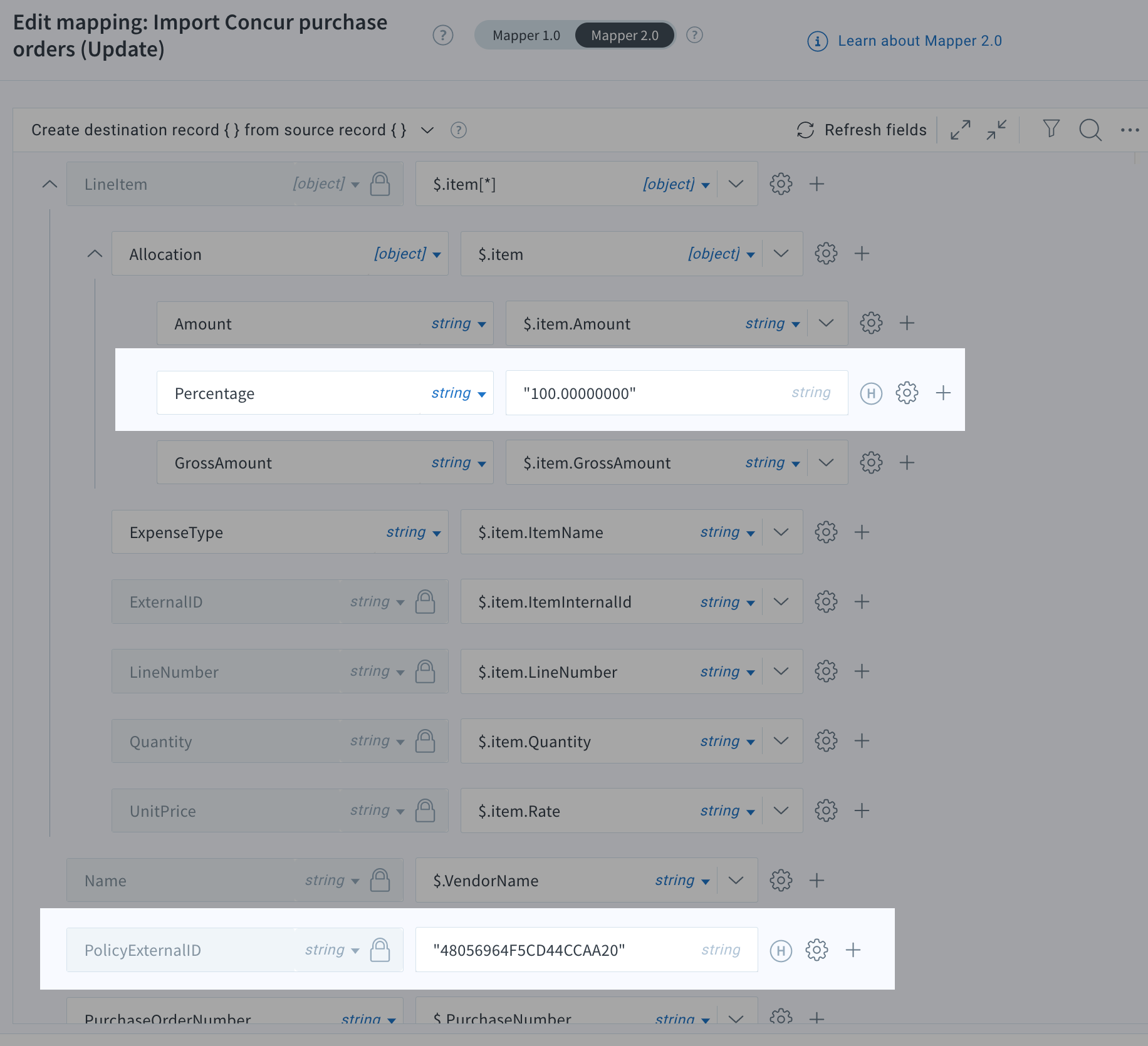

    3.pngField mappings: Import Concur purchase orders (Add)
    4.pngField mappings: Import Concur purchase orders (Update)

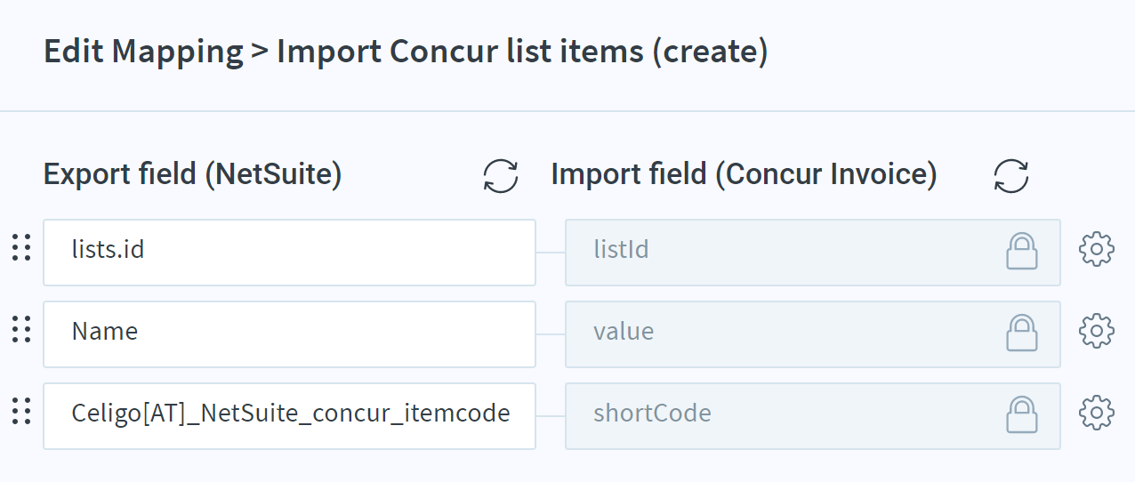

This integration flow syncs NetSuite departments as Concur list items.
Applies to
Flow details
  • Export source: NetSuite
  • Import destination: Concur
  • Built-in export: Get NetSuite departments – get all departments from NetSuite
  • Built-in lookup: Get Concur lists – get all lists from Concur

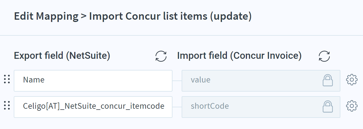

  • Built-in import: Import Concur list items (create) – add or ignore list items into Concur with ID as the lookup identifier
  • Built-in import: Import Concur list items (update) – update list items into Concur with ID as the lookup identifier

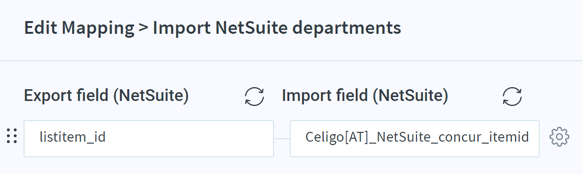

  • Built-in import: Import NetSuite departments – update departments into NetSuite with ID as the lookup identifier
Setup instructions

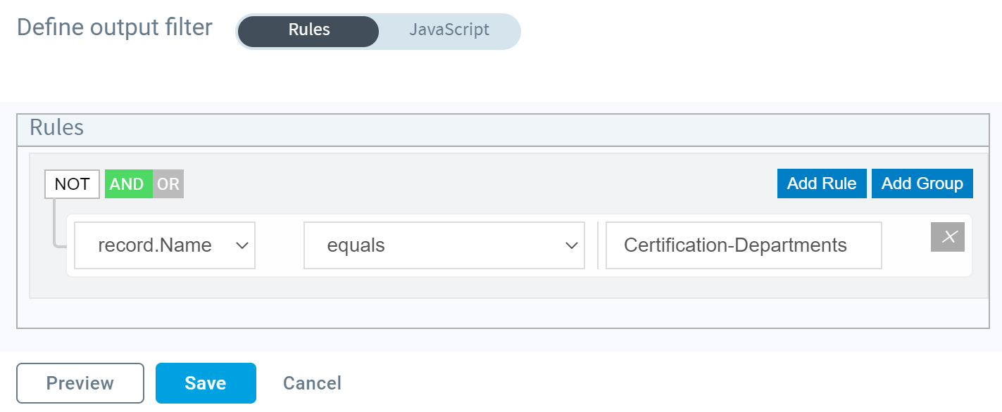

Configure filter rules in Get Concur lists. (The record.value shown below represents the name of the list created in Concur; the department records are inside the Concur list. See What are Concur lists?, above.)

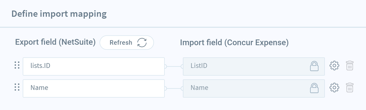

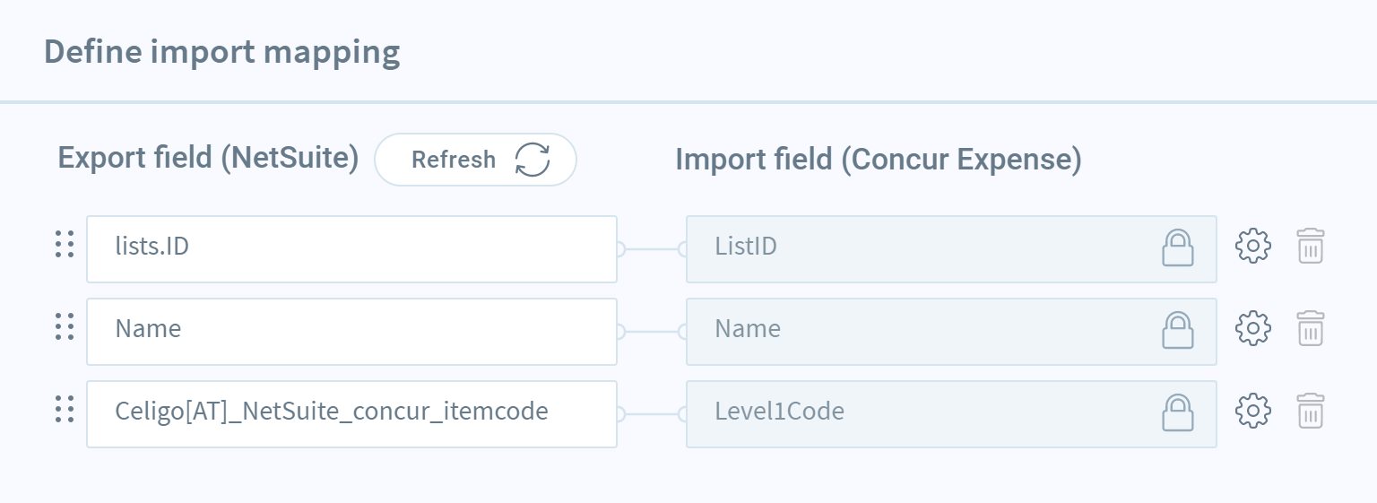

Field mappings: Import Concur list items (create)
Field mappings: Import Concur list items (update)

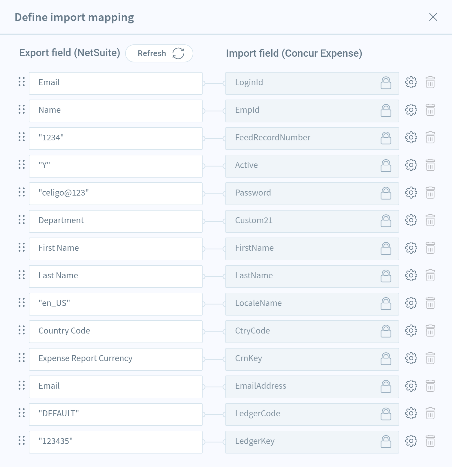

NetSuite employees to Concur users
This integration flow syncs NetSuite employees as Concur users.
Applies to
Flow details

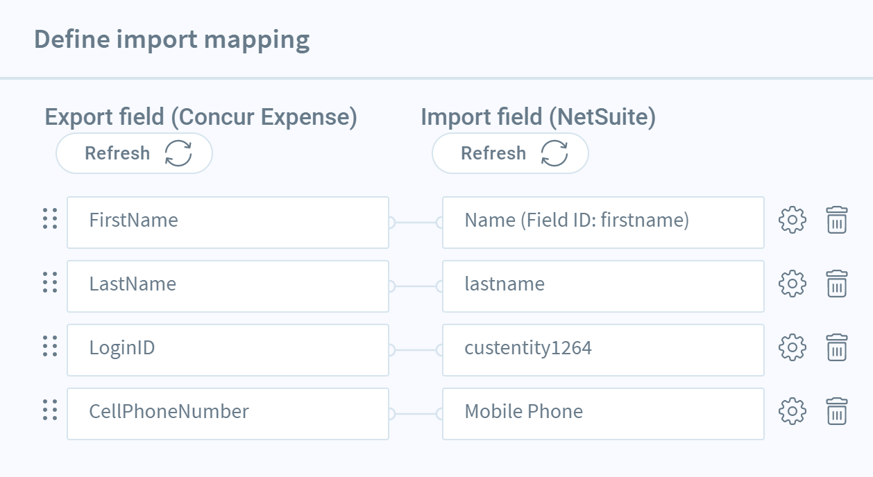

  • Built-in export: Get NetSuite employees – get all employees from NetSuite that have been modified since this flow last ran
  • Built-in lookup: Get Concur Invoice user by email – get user from Concur Invoice using email as an identifier
  • Built-in lookup: Import Concur Invoice user by email – Get user roles for existing user in Concur Invoice using user id as identifier
  • Built-in import: Import Concur users – add or update users into Concur
Before you begin
The NetSuite department name should be the same as the Concur List item name.
Setup instructions
  1. Configure hard coded mapping for Active, Value, Type, Entitlements, and CompanyID in Import Concur users.
  2. Configure static map for CtryCode in Import Concur users.

  • Built-in export: Get NetSuite vendors – get all vendors from NetSuite that have been modified since this flow last ran
  • Built-in import: Import Concur vendors – add or update vendors into Concur with the Vendor Code and Vendor Name as the lookup identifier in mapping
Before you begin
  1. The NetSuite vendor name should be the same as the Concur vendor name.
  2. Set Concurrency level to 1 for your connection, either
    Concur Connect-EU-377-Celigo (Std) invoice or
    Concur Connect-377-Celigo (Pro) invoice.
Setup instructions
Configure static map for Currency in Import Concur vendors.
Field mappings: Import Concur vendors
