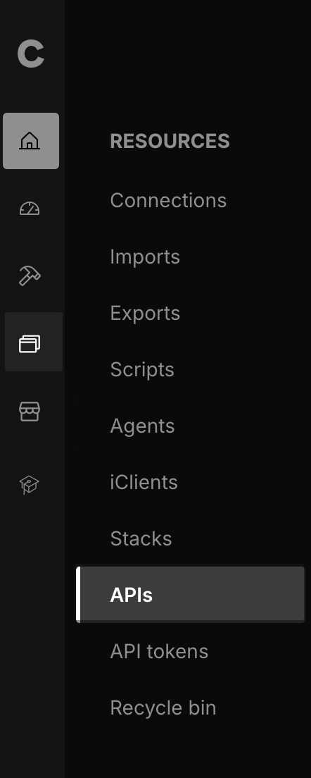

You must be an  account owner or administrator. Then, you can create, modify, or delete the JavaScript API in the Resources menu.

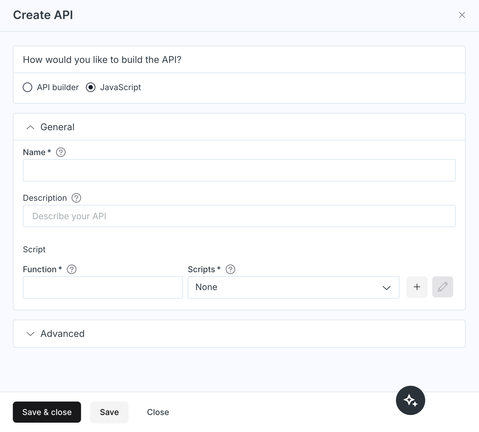

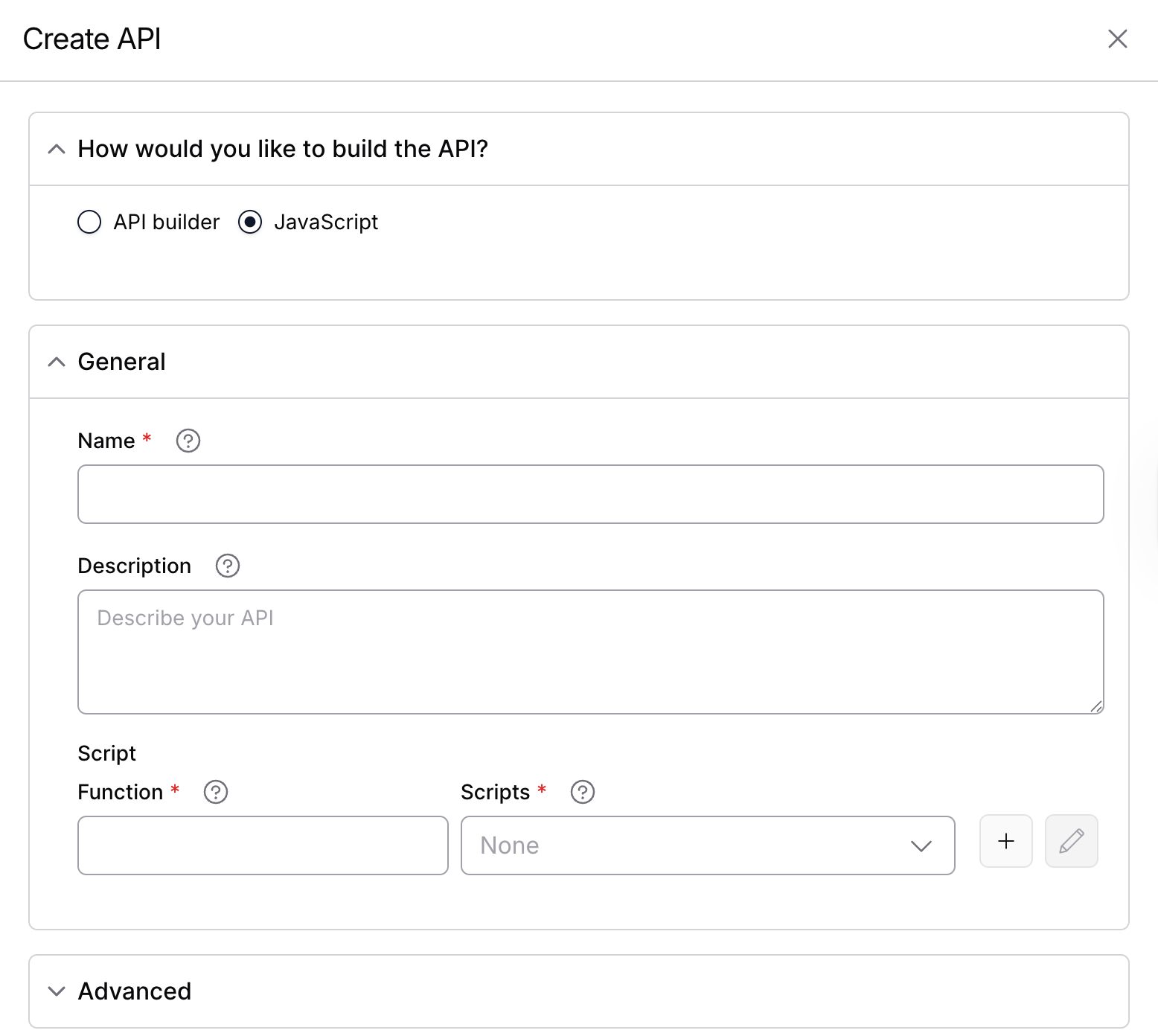

To create a JavaScript API(s):

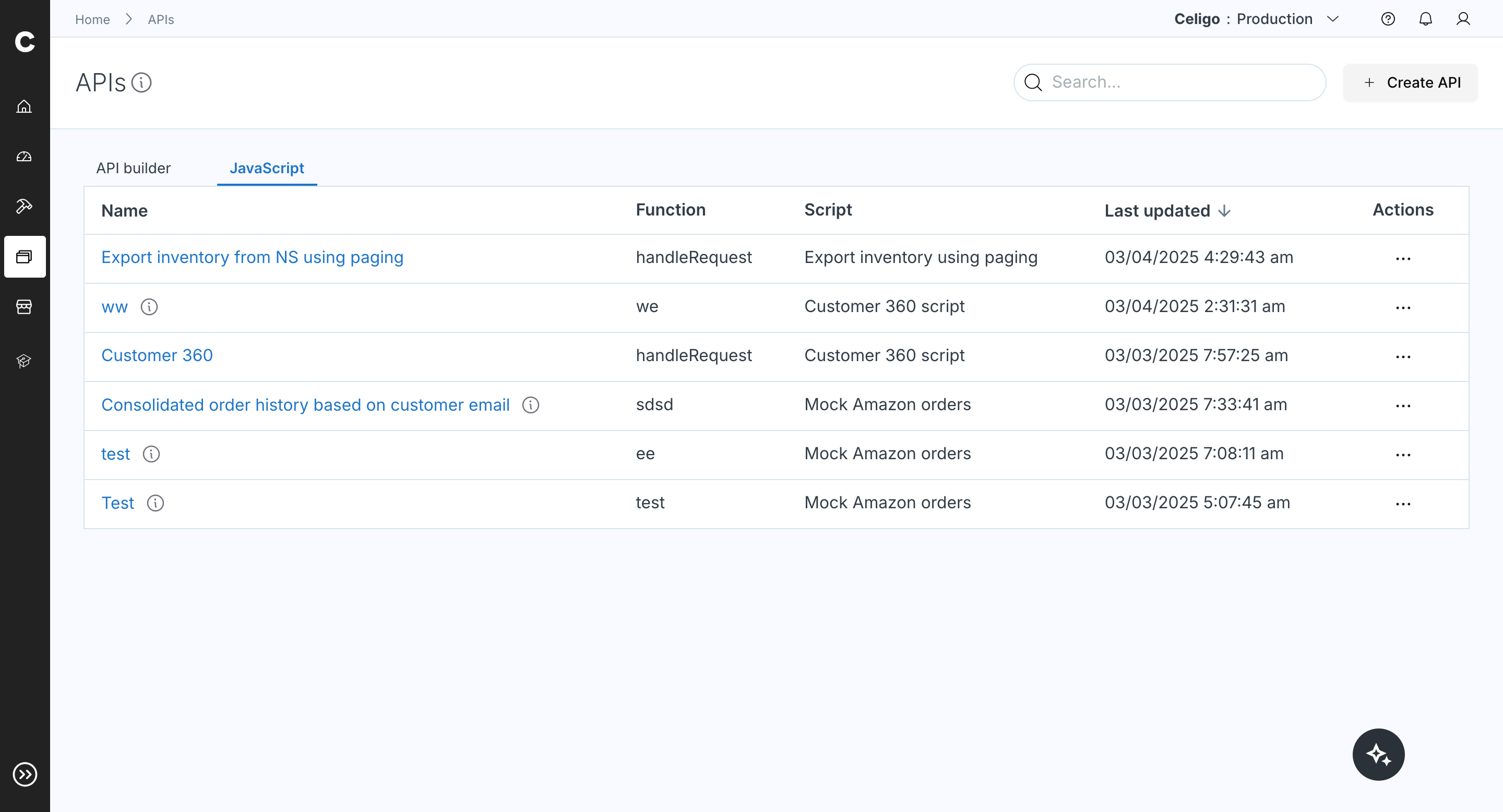

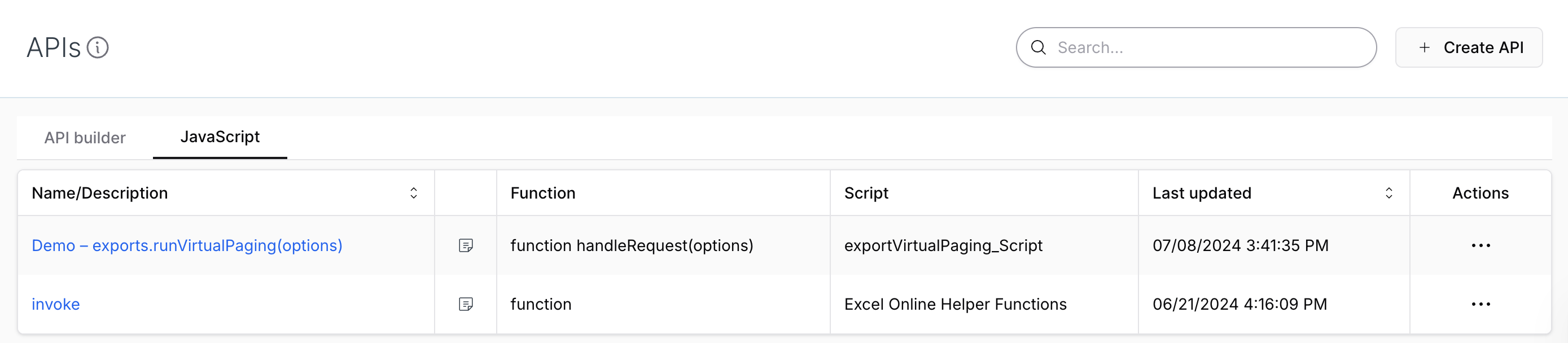

  1. Navigate to ResourcesAPIs.
  2. Click JavaScript tab+ Create APIJavaScript on the upper right-hand side of the screen.
  3. Enter a unique Name and detailed Description of how the JavaScript API works. Be sure to highlight any nuances you or another user making changes might want to know later.
Scripts (required)

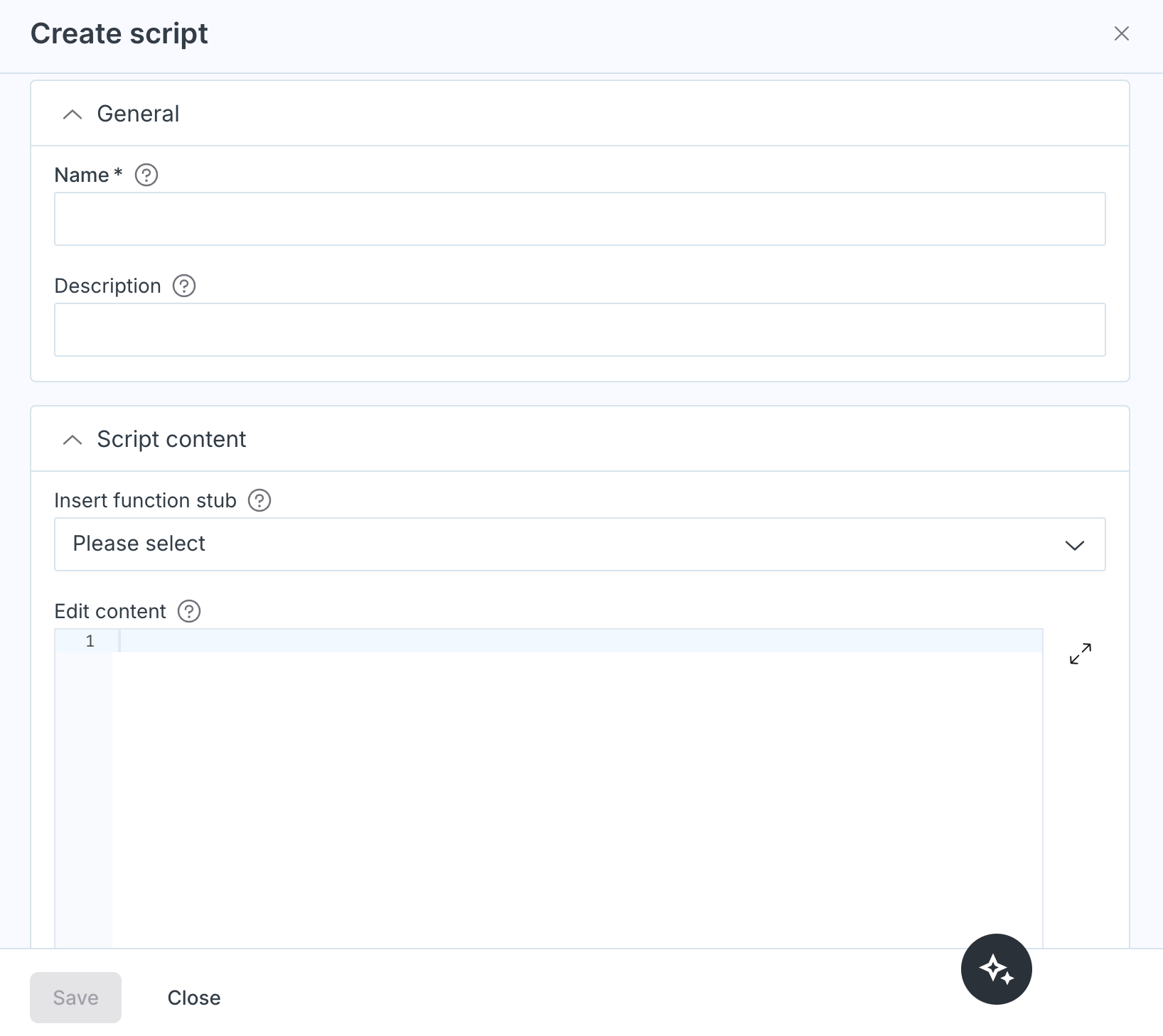

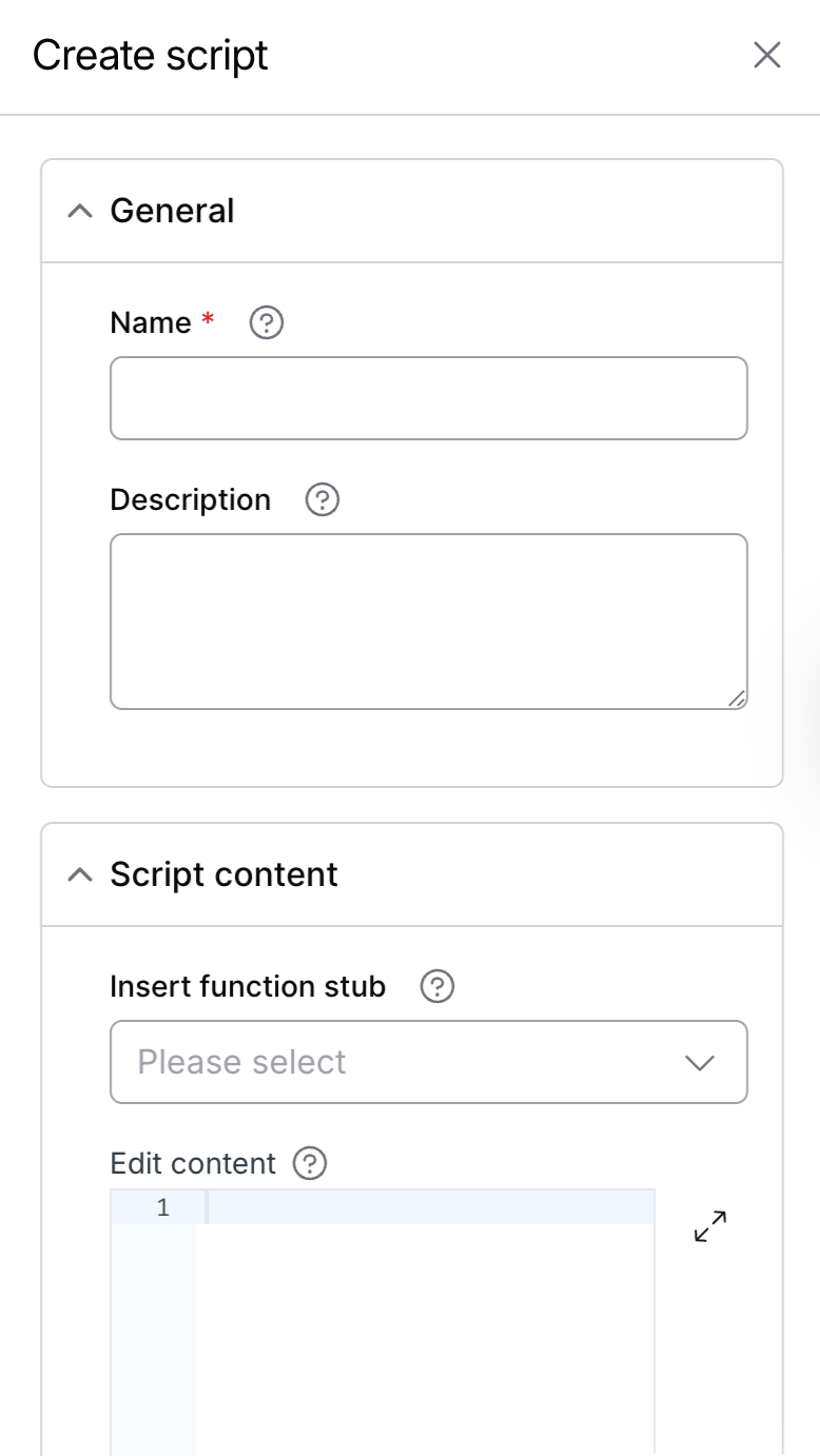

Select a script from the list that you’ve already written, click the + icon to start writing your own code in the Create script form, or modify an existing script using the pencil (pencil.svg) icon. If you’re starting from scratch, insert a function stub that provides all the required fields for the request and response. Note that if you modify a script in one location, it is modified everywhere.
Within your script logic, you can support any content type (like  JSON  or XML), any HTTP request method (GET, PUT, POST, etc.), and you can invoke any number of external APIs. The built-in  JS runtime module contains several objects and functions you can script and automate everyday integrator.io tasks.
Function (required)
Enter the name of the function. This is the function name that gets called when a request is sent to JavaScript API(s); although you can write as much code as you need, only the single entry point specified here is initially called and receives any data passed in the HTTP header and body.
The name of the function in the default Handle request stub is handleRequest. If you used a different name, you may find it easiest to click the pencil.svg icon to open the script for editing and copy the exact name (without parentheses) for this Function setting.

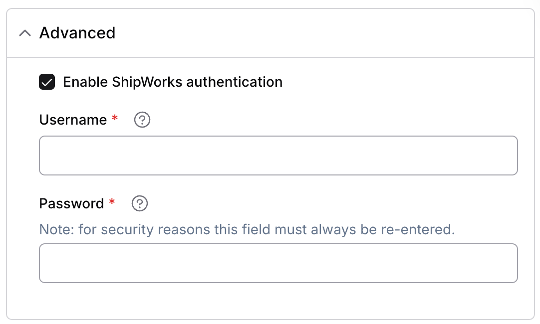

Continuing in the Create API pane: Advanced settings

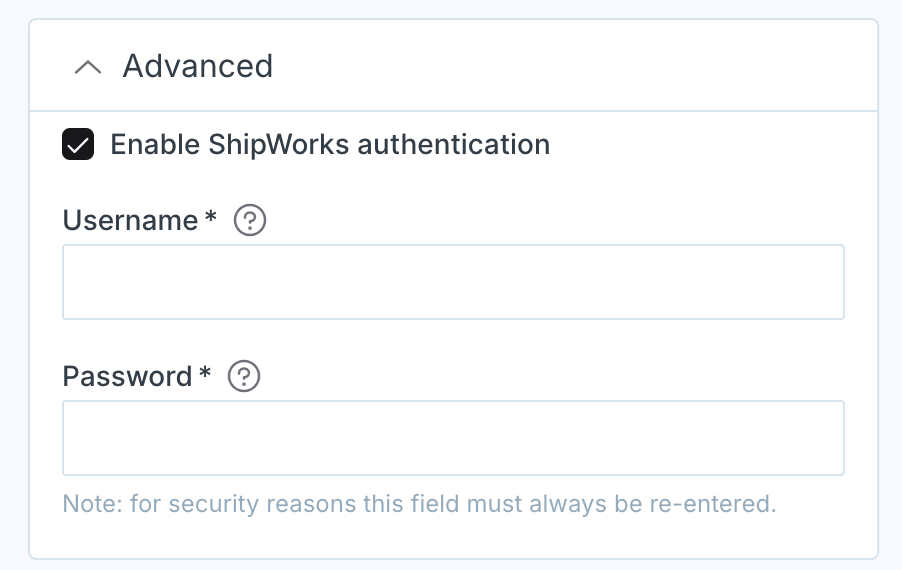

  • Enable ShipWorks authentication (optional): Check this box if you will be receiving HTTP requests from ShipWorks, so that integrator.io provides the required login credentials.
    1. Username (enabled & required, only for authentication): Enter the ShipWorks username you provided during the store setup.
    2. Password (enabled & required, only for authentication): Enter the ShipWorks password you provided during the store setup. Multiple layers of protection are in place, including AES 256 encryption, to keep your password secure. When editing this form later, you must enter this password again; it is stored only for a saved JavaScript API.

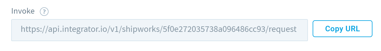

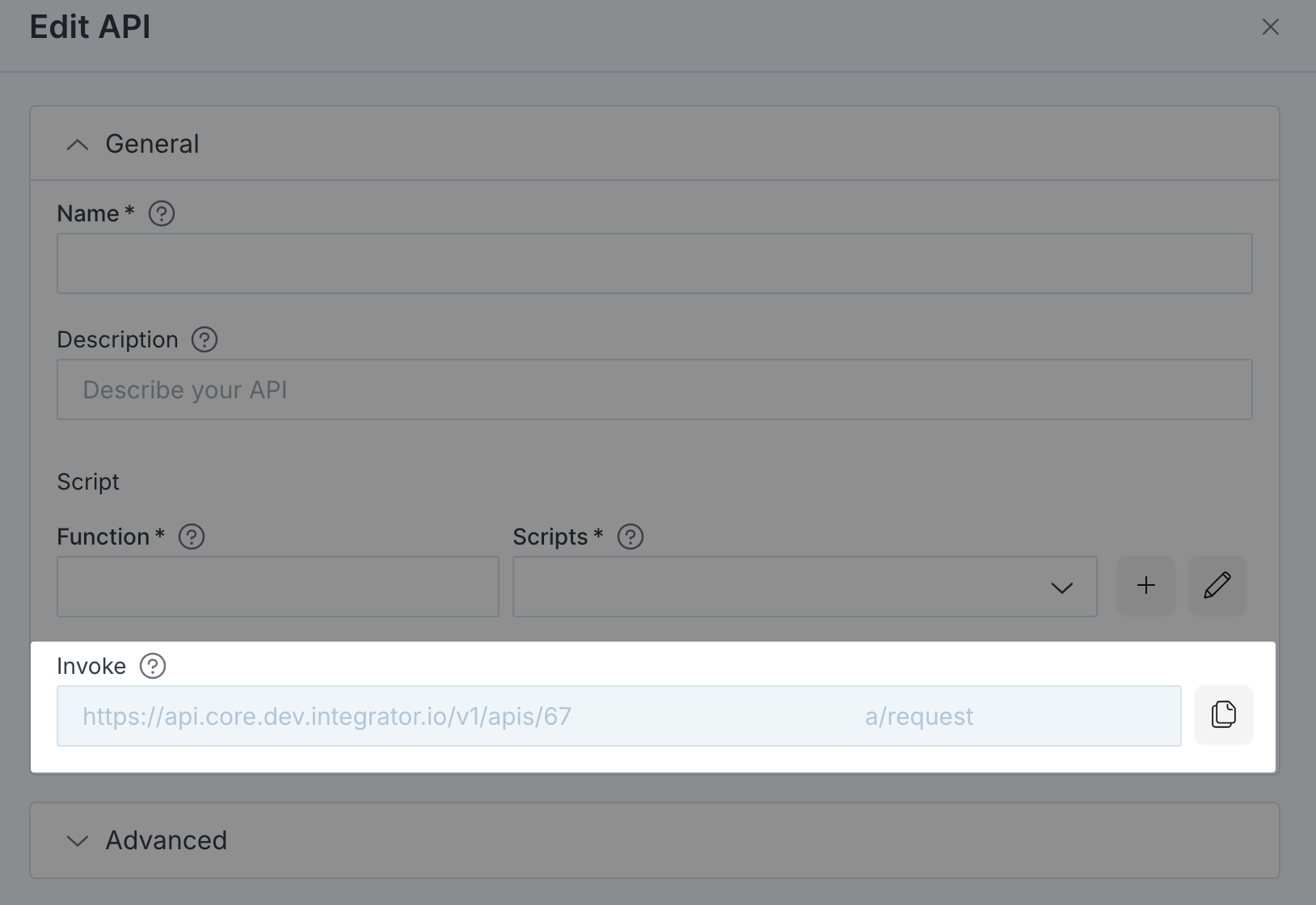

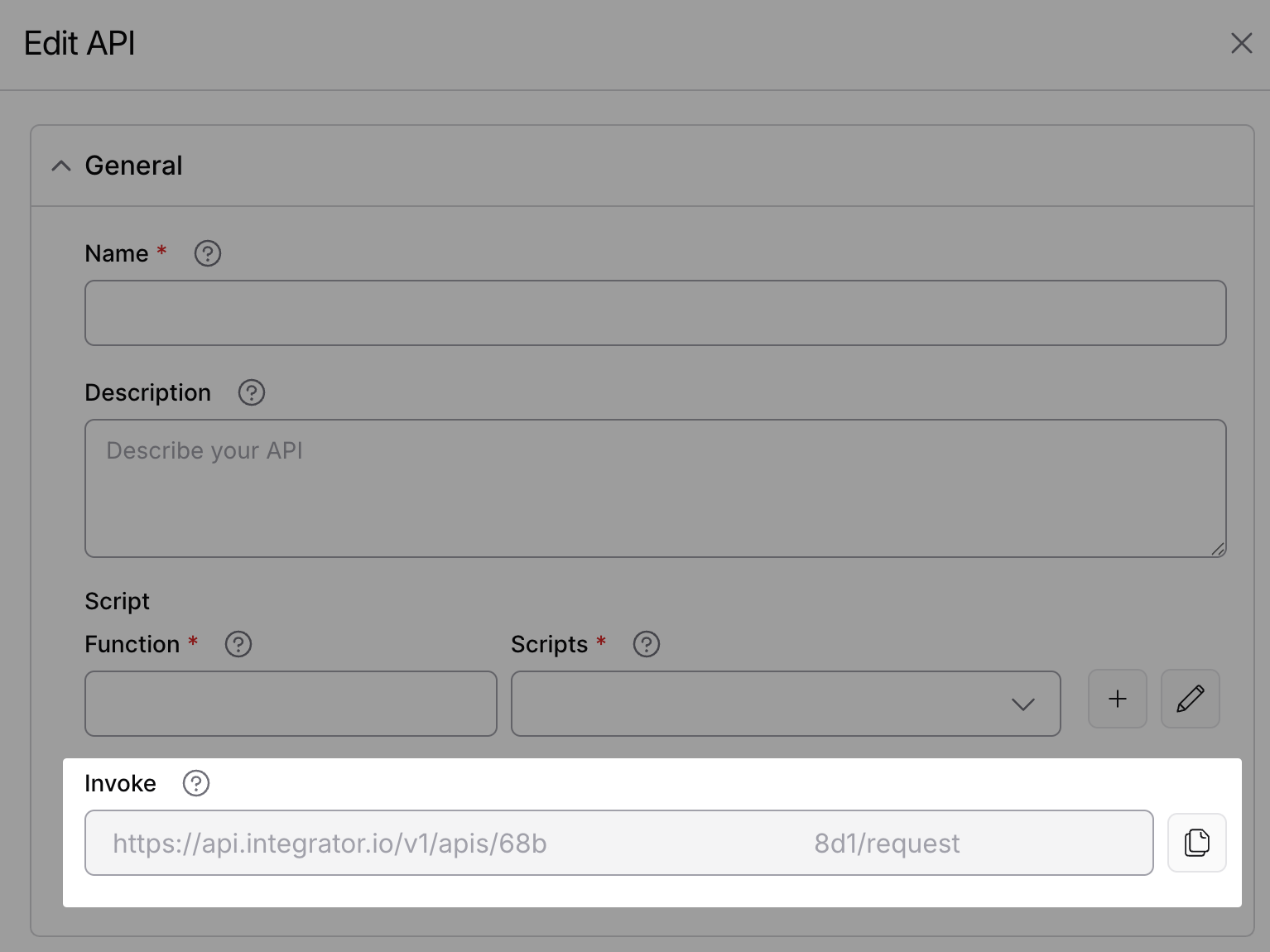

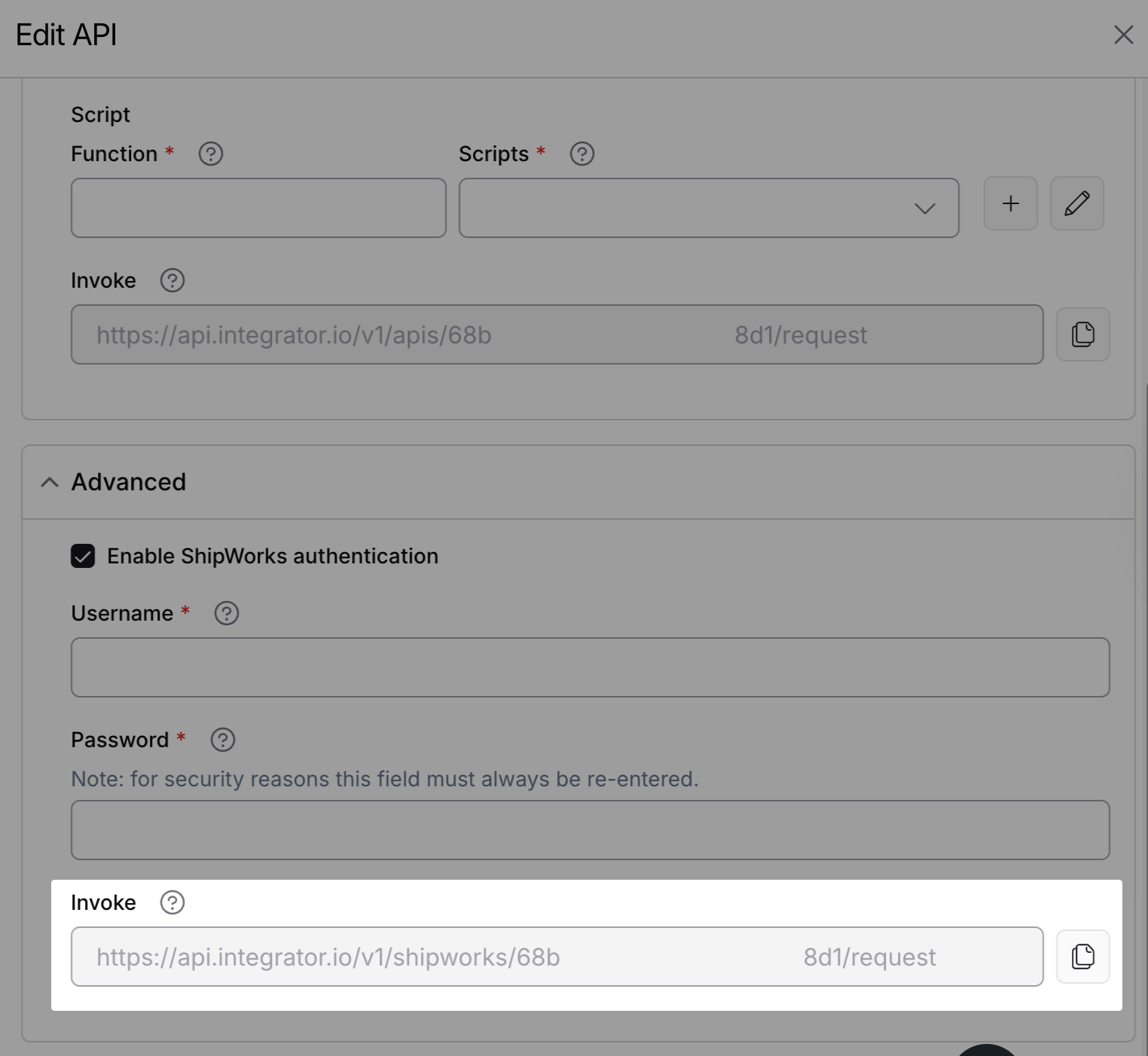

Copy your unique endpoint URI
Click the name of a JavaScript API in the list or choose Actions (...)Edit JavaScript API. Then, click Copy URL to add the contents to your clipboard.
These values are displayed earlier when you click Save in the Create API pane, instead of closing when done.
Sample unique JavaScript API endpoint
Sample unique JavaScript API endpoint, optional ShipWorks variant Provide the username and password in your request for authentication – no bearer token is required
