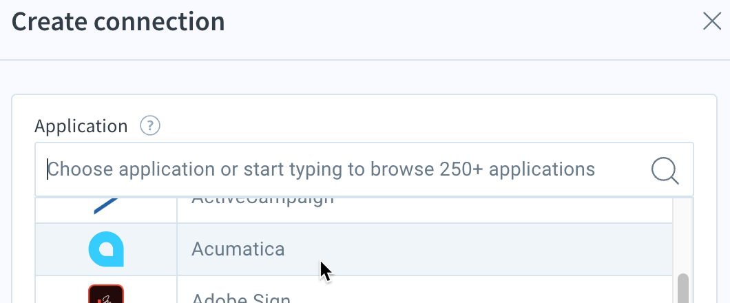

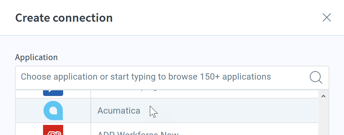

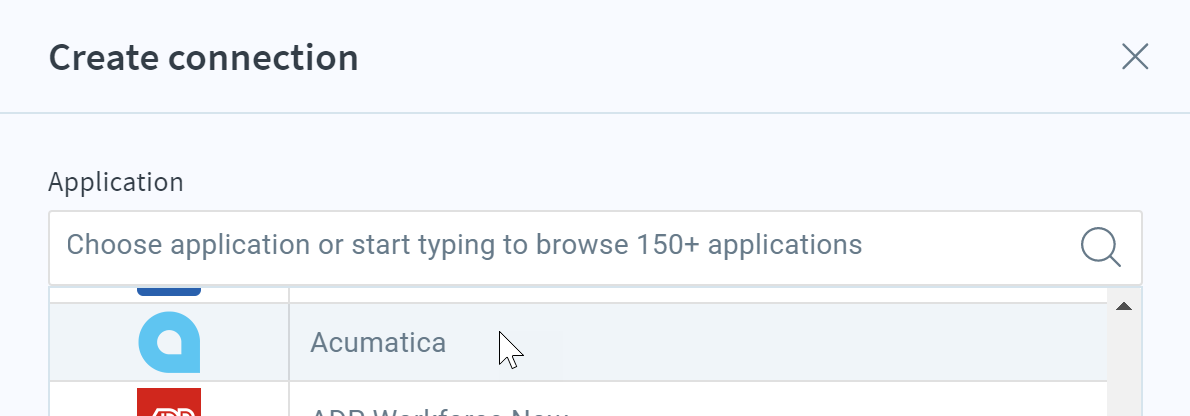

Start establishing a connection to Acumatica in either of the following ways:
In the resulting Application list, select Acumatica.

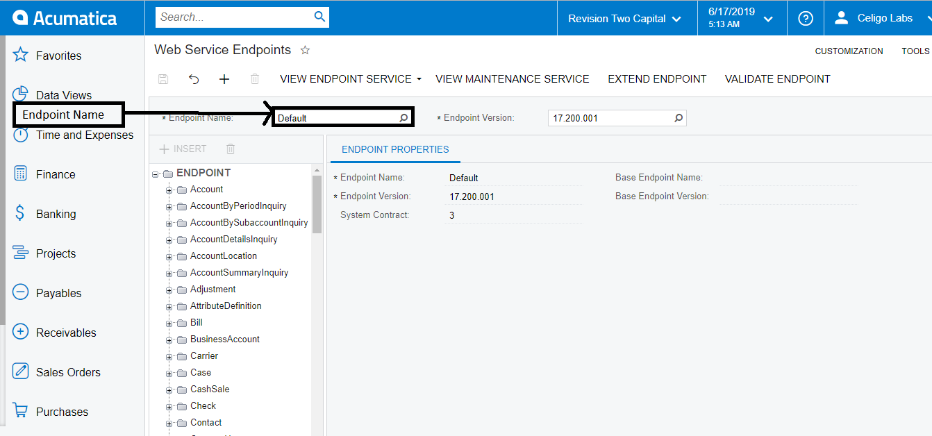

Endpoint name (required): Enter the endpoint name found in your Acumatica account under Web service endpoints.

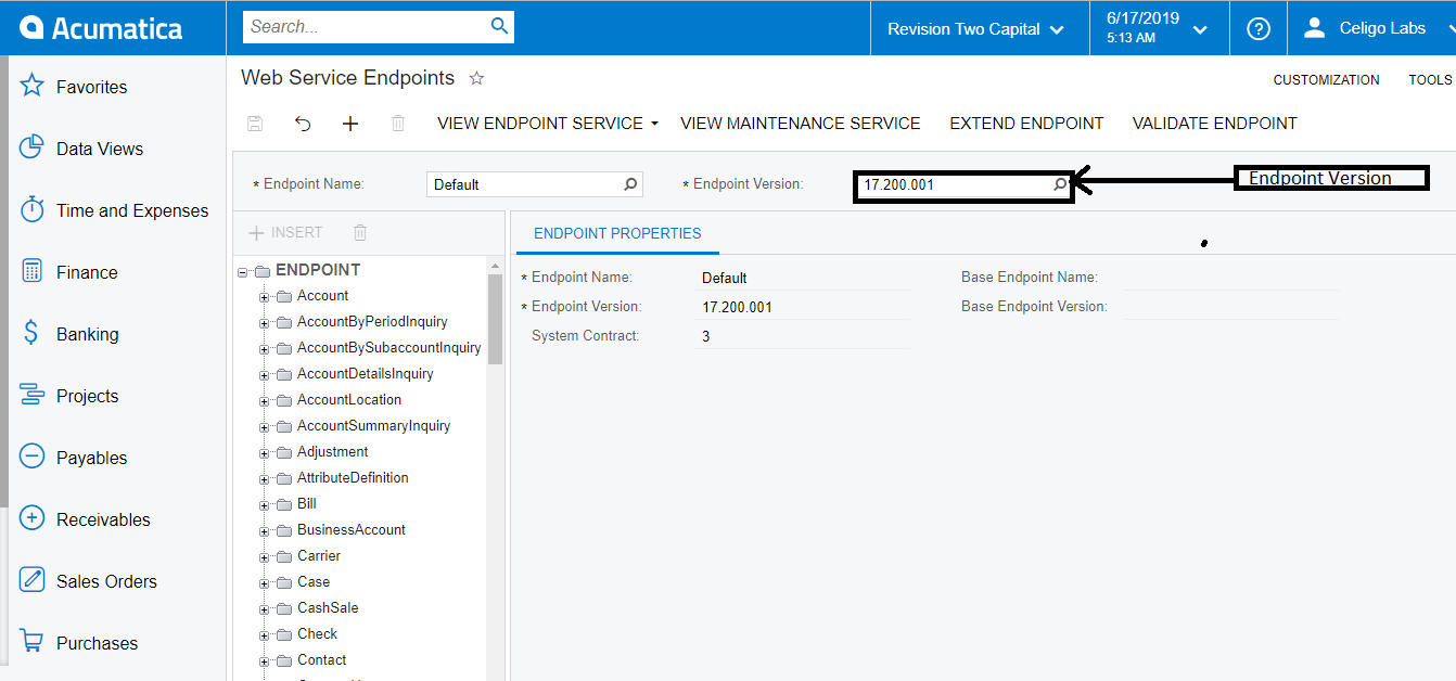

Endpoint version (required): Enter the endpoint version found in your Acumatica account under Web service endpoints. This setting defaults to the current version.

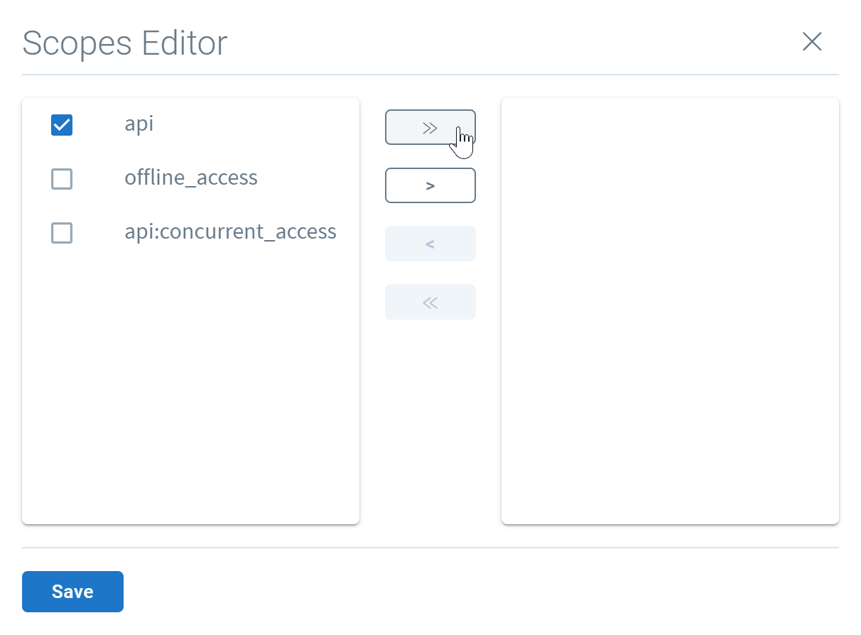

Configure scopes (required): Scopes are permissions that the Acumatica API defines to limit the access to your account. To select the scopes for this connection,
- Click the Configure scopes button.
- To access all of the scopes in the API, click the » button.
– or –
Check the scopes you want to add, and click the > button.

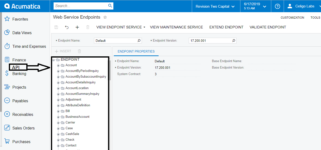

Sign in to your Acumatica account, and search for Web service endpoints.
The search result displays the API in the Endpoints folder.
Notice that it also displays the endpoint name and version, required for your connection:

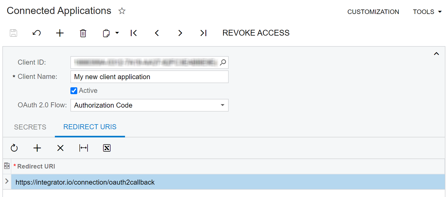

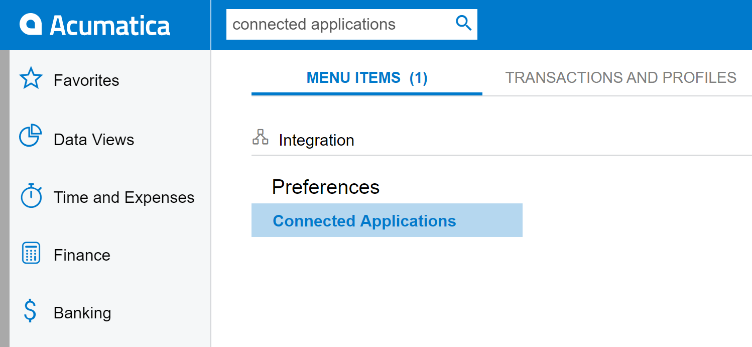

Sign in to your Acumatica account, and search for connected applications. Click the resulting menu item Integration > Preferences > Connected applications.
- Leave Client ID blank for a new app, or search for an existing app.
- Provide a Client name.
- Leave Active checked.
- Choose Authorization code for the OAuth 2.0 flow.

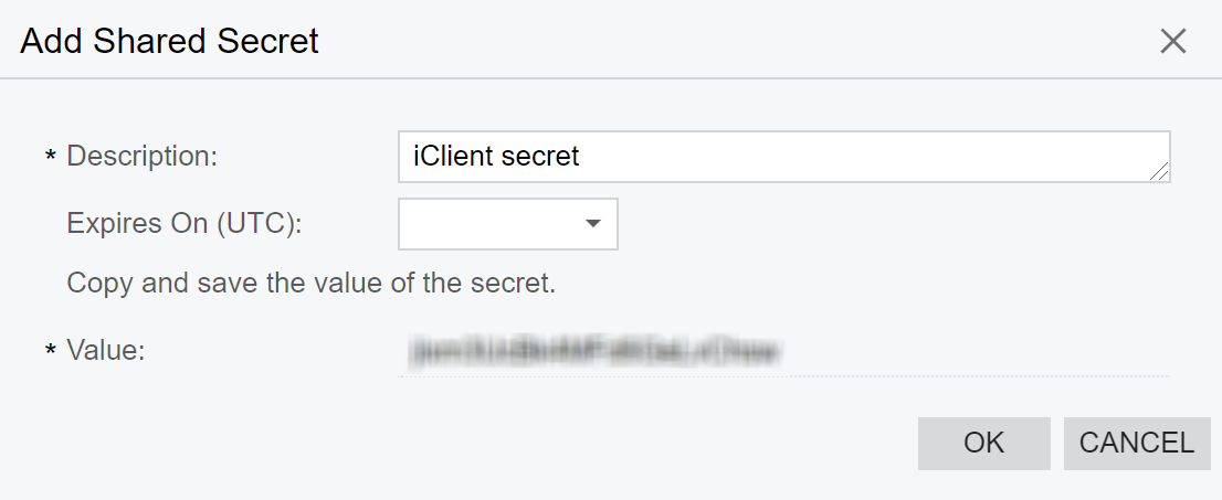

In the Secrets tab, click Add shared secret. Acumatica displays the value – just this once – for you to copy for the connection’s Client secret and also gives you the opportunity to name the secret and give it an expiration date. Click OK to return to the Connected applications page.

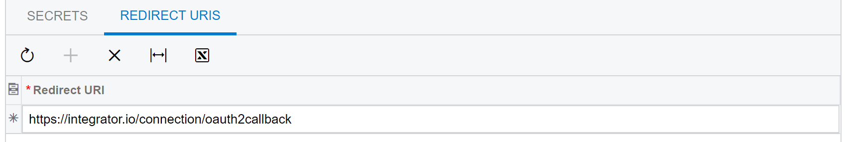

In the Redirect URIs tab, click the + button to add an entry. Paste the Callback URL from the Acumatica connection, above. Press the enter key to commit this URI.
Finally, click the save button (disk icon). Acumatica then assigns the Client ID, which you can copy for the iClient value.

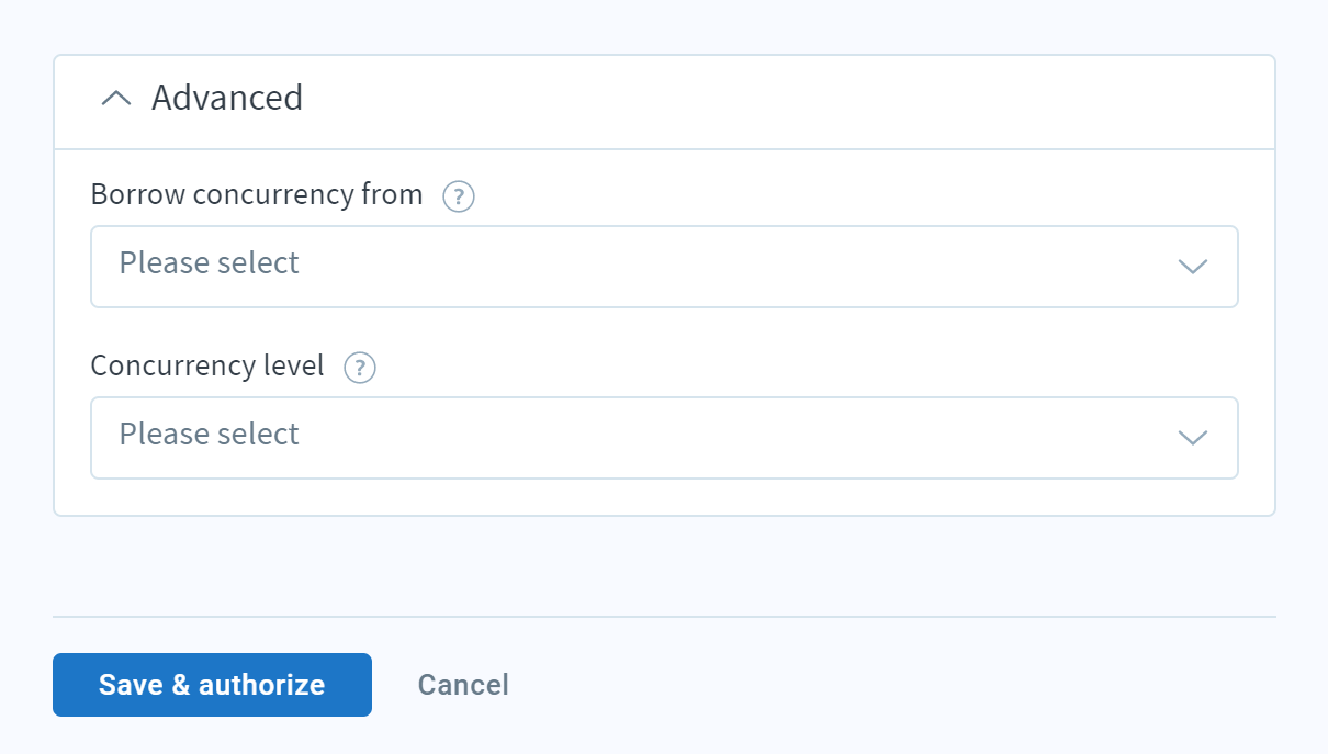

D. Edit advanced Acumatica settings
Before continuing, you have the opportunity to provide additional configuration information, if needed, for the Acumatica connection.
E. Test the connection

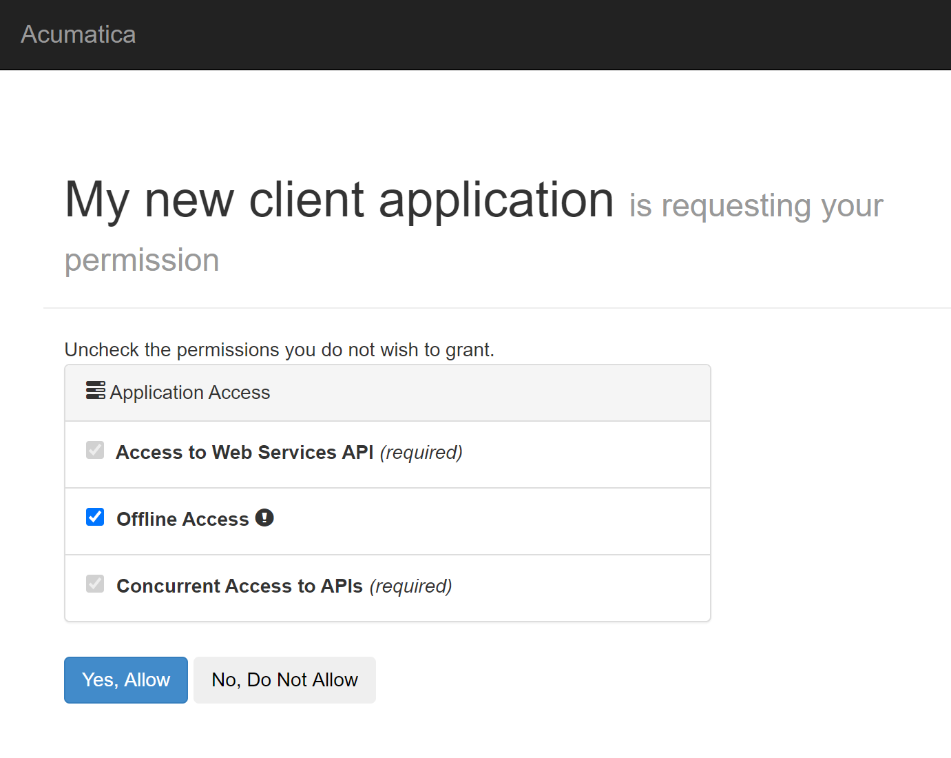

Once you have configured the Acumatica connection, you have the option to Save & authorize or Cancel your changes.
When you save the connection, Acumatica allows you to sign in, if there is no current session. It then prompts you to review and confirm the scopes. Click Yes, allow.
