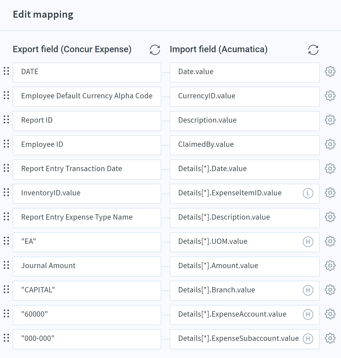

Concur expense reports to Acumatica expense claims (Best Practice)
This integration flow syncs Concur expense reports with Acumatica expense claims for Standard accounts by payment batch.
Applies to
- Concur Expense (Best Practice) – Acumatica Quickstart integration template
Flow details
- Export source: Concur
- Import destination: Acumatica
Built-in export: Get Concur payment batches – get all payment batches that are in open status from Concur
- Built-in preSavePage hook: concur payment request.js – parse links to batch files
- Built-in import: Import Concur payment batches – close the payment batches of Concur
- Built-in lookup: Get Concur payment batch files – get all payment batch files from Concur
- Built-in import: Import Acumatica expense claims – add or update expense claims to Acumatica
Before you begin
- Users in Concur and Employees in Acumatica should be the same.
- Expense Types in Concur and Inventory ID of Non-Stock Items in Acumatica should be the same.
Setup instructions
Configure line-level mapping for UOM.value, Branch.value, ExpenseAccount.value, and ExpenseSubaccount.value in Import Acumatica expense claims.

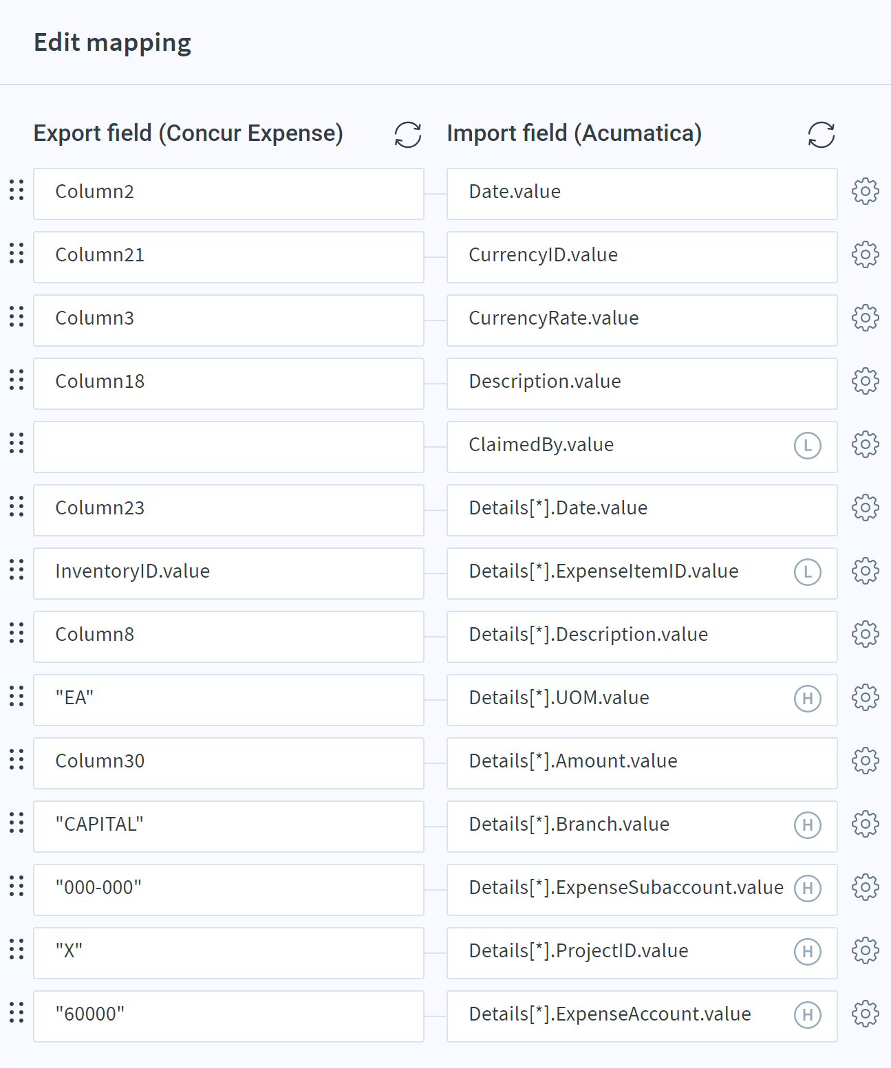

Concur expense reports to Acumatica expense claims (Enhanced)
This integration flow syncs Concur expense reports with Acumatica expense claims for Professional accounts by Extract Method.
Applies to
- Concur Expense (Enhanced) – Acumatica Quickstart integration template
Flow details
Built-in export: Get Concur extract definition details – get Concur extract definition details for expense that have been modified since this flow last ran
- Built-in preSavePage hook: processing Concur expense reports.js – parse links to job files
- Built-in lookup: Get Concur extract files by job ID – get extract files from Concur
- Built-in import: Import Acumatica expense claims – add expense claims into Acumatica
Before you begin
Setup instructions
- Add the Definition ID for the Expense.
- Configure line-level mapping for UOM.value, Branch.value, ExpenseAccount.value, ExpenseSubaccount.value and ProjectID.value in Import Acumatica expense claims.
- Configure dynamic mapping for ClaimedBy.value in Import Acumatica expense claims.

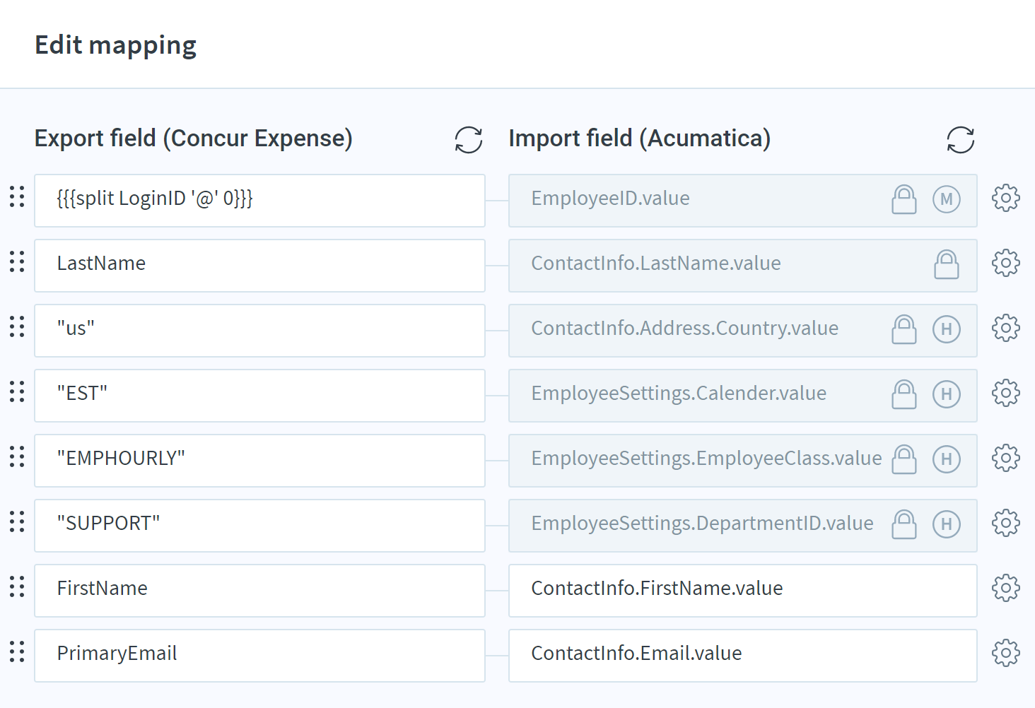

Concur users to Acumatica employees
This integration flow syncs Concur users as Acumatica employees.
Applies to
Flow details
- Built-in export: Get Concur users – all users from Concur
- Built-in import: Import Acumatica employees – add or update employees into Acumatica
Setup instructions
Configure mapping for ContactInfo.Address.value, EmployeeSettings.Calendar.value, EmployeeSettings.EmployeeClass.value, and EmployeeSettings.DepartmentID.value in Import Acumatica employees.

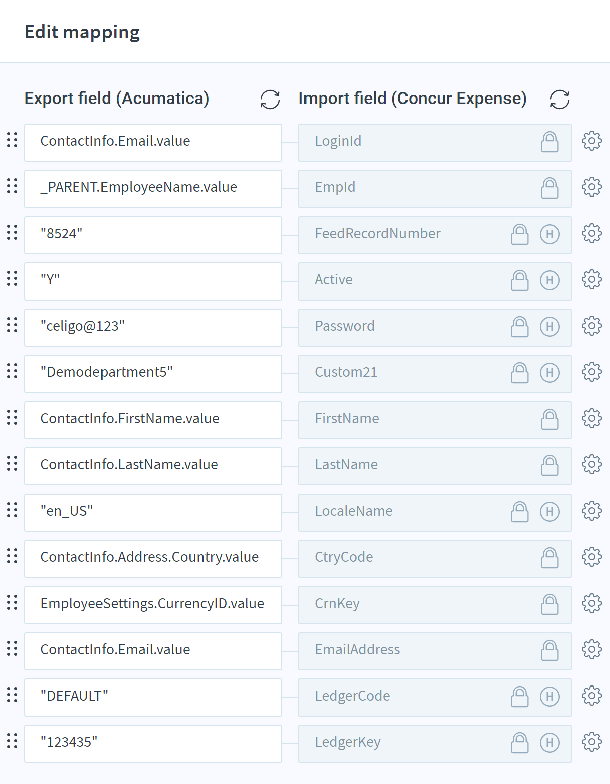

Acumatica employees to Concur users
This integration flow syncs Acumatica employees as Concur users.
Applies to
Flow details
- Export source: Acumatica
- Import destination: Concur
- Built-in export: Get Acumatica employees – get all employees from Acumatica that have been modified since this flow last ran
- Built-in lookup: Get Acumatica employee by id – get an employee from Acumatica by ID
- Built-in import: Import Concur users – add or update users from Concur
Setup instructions
Configure mapping for FeedRecordNumber, Active, Password, Custom21, LocaleName, LedgerCode, and LedgerKey in Import Concur users.
