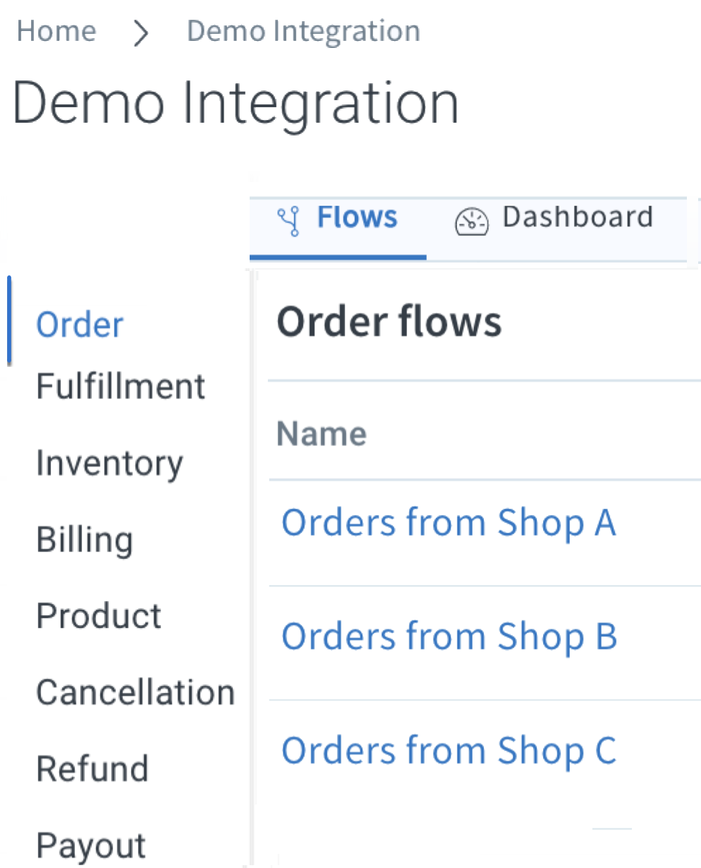

If you have a custom integration tile with many flows, you can use either the integrator.io UI or the integrator.io API, as described in this article, to create groups and assign flows to groups. Each group will act as a filter within the integration console. When you click the group name, only flows assigned to that group will be displayed.
