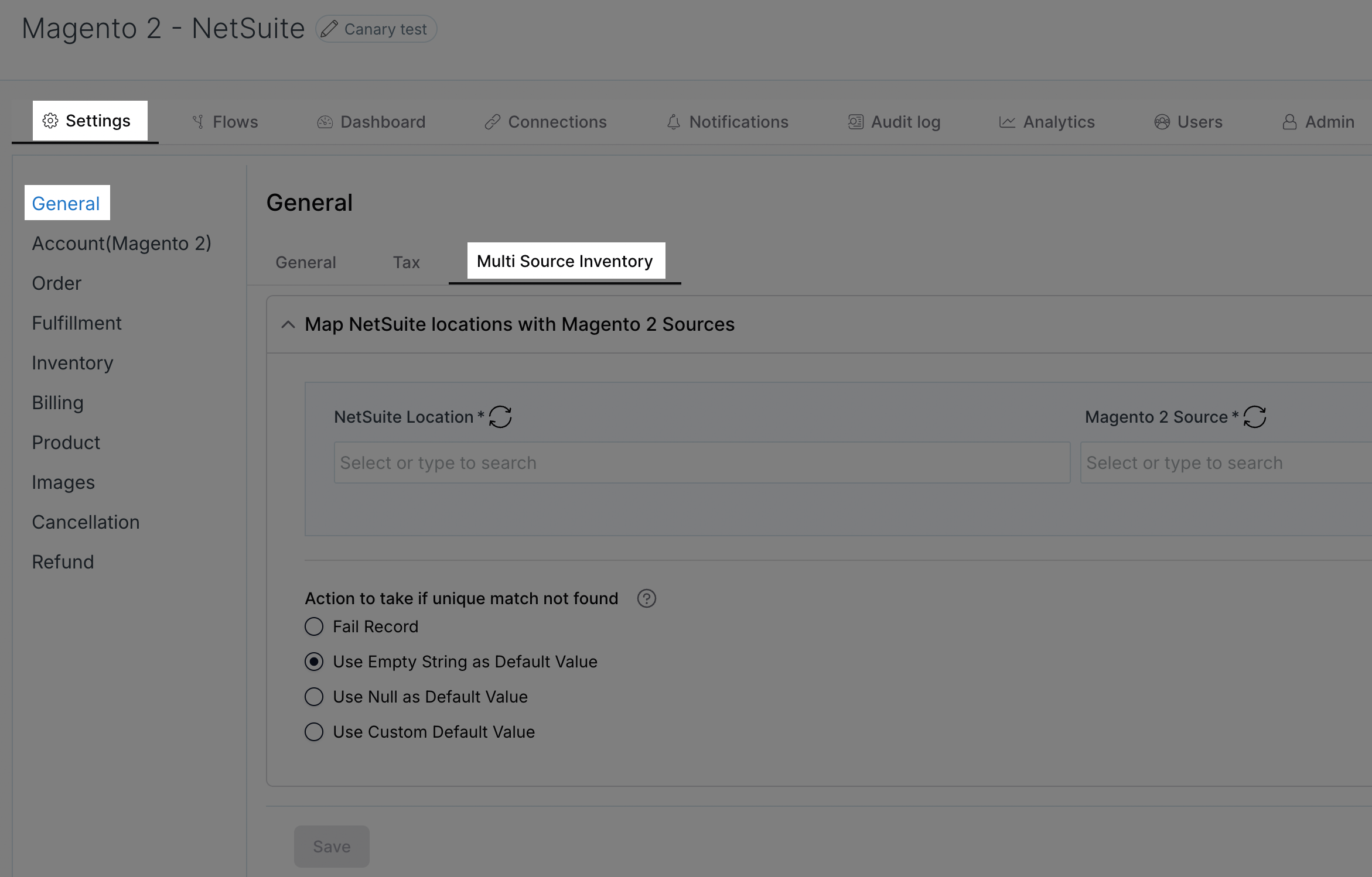

  4. Recheck multi-source inventory mapping:
    1. Go to Settings > General > Multi Source inventory mapping and confirm the source mappings are correct.
    2. Remove and re-add sources if needed.
