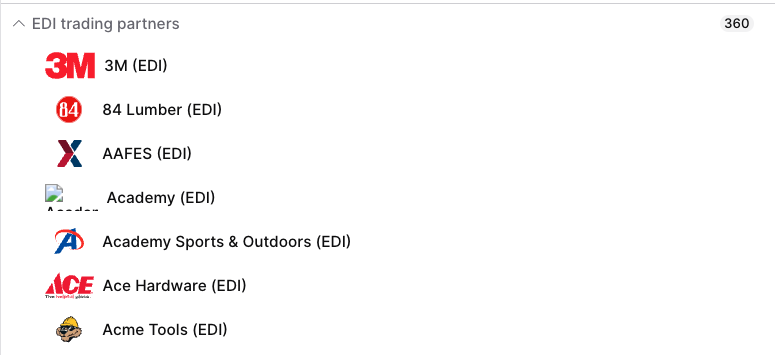

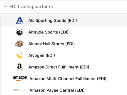

  1. Select the appropriate connection in the EDI trading partners list.

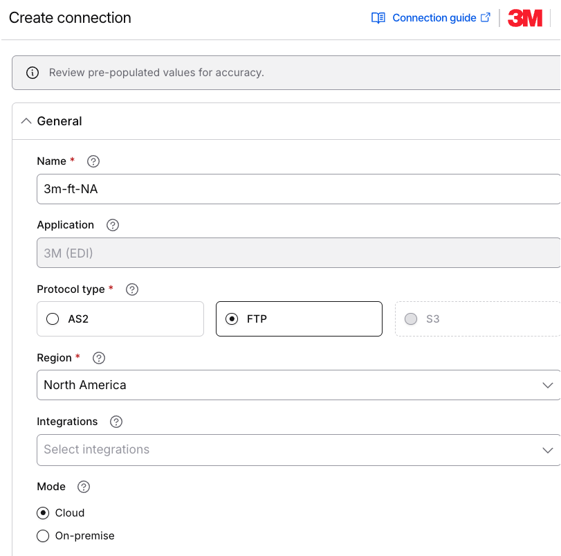

  2. The Create connection pane opens with required and advanced settings. Before you can establish your connection, you and your partner must exchange certain pieces of information.
Select the connection protocol you want to use to communicate with your trading partner and the business region in which you or your trading partner operates. Your selections determine the subsequent configuration steps. Selecting FTP displays the FTP-specific connection settings, and AS2 displays the AS2-specific connection settings, respectively. The selected region is leveraged while configuring downstream flows to configure appropriate EDI profiles and file definitions.
For instructions on configuring other EDI Trading Partner connection protocols, see Set up an AS2 connection for AS2 connections, and Set up an FTP connection for the FTP connections.
