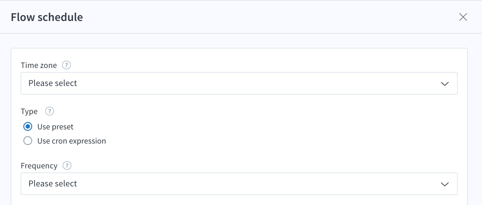

Flow settings
The flow gets the purchase order transactions from NetSuite on a scheduled basis. You can configure the schedule if required.

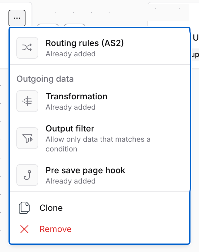

Add a transformation: You must add a script, EDI 855 to NS Purchase Order, to transform the exported data (EDI JSON) to canonical JSON format for the next step.
  1. In the export, click the Actions (...) menu, then the Transformation option.
  2. In the Define transformation page, at the top right corner select JavaScript.
  3. Click the plus sign (+) next to the script settings to add a new script.
  4. In the Create script page, enter a name for your script – for example, EDI 855 to NS Purchase Order.
  5. In the Edit content box, copy and paste this EDI 855 to NS Purchase Order script. Click Save.
  6. In the Define transformation page, in Script, select the script you created above.
  7. Click Save

Add a transformation: You must add a script, EDI ASN 856 to NS Item Fulfilment, to transform the exported data (EDI JSON) to canonical JSON format for the next step.
  1. On the export, click the Actions (...) menu, then click the Transformation (transform.svg) option.
  4. In the Edit content box, copy and paste the EDI ASN 856 to NS Item Fulfilment script. Click Save.
  5. In the Define transformation page, in Script, select the above script you created.
  6. Click Save
Add a Pre save page hook – You must create/add a PreSave page hook.
  1. On the export, click the Pre save page hook (hook.svg) option.
  2. In the Hooks page, the Scripts option is selected by default.
  3. In Scripts, select the script that you had earlier created. That is, EDI ASN 856 to NS Item Fulfilment script.
  4. Click Save.
