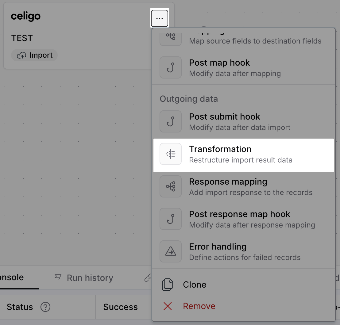

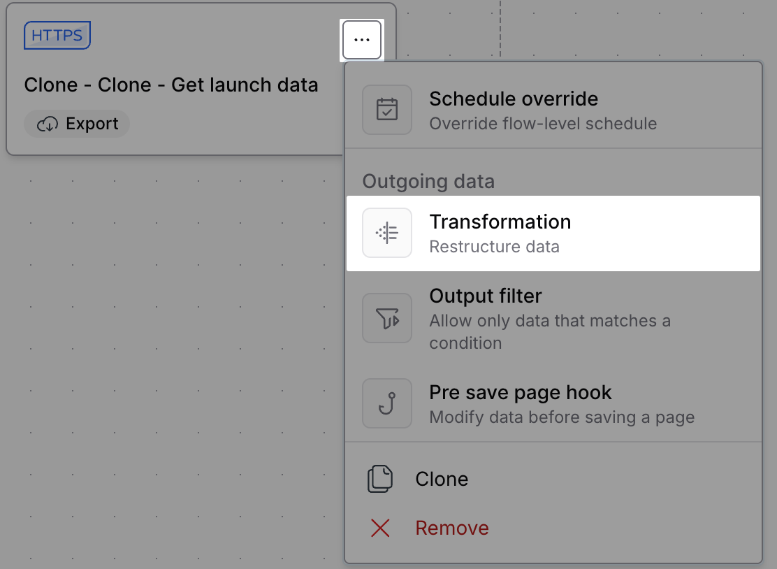

Apply a transform
Use the following steps to apply a transform to a flow step.
You must extract all of the fields you want to keep, even if you only modify one of them. Only the fields listed under in the Output section of the AFE will be included in the final record.
  1. In Flow Builder, click + and select the transform icon. The Define transformation advanced field editor (AFE) opens.
    Transformations in an export
    Transformations in an import
  2. Toggle between Transformation 1.0 and JavaScript.
  3. Add your transformations.
  4. When your data meets the requirements for the next step in your flow, click Save & close.
If Auto preview is enabled, the results of your transform configuration immediately display in the Output section of the AFE.
