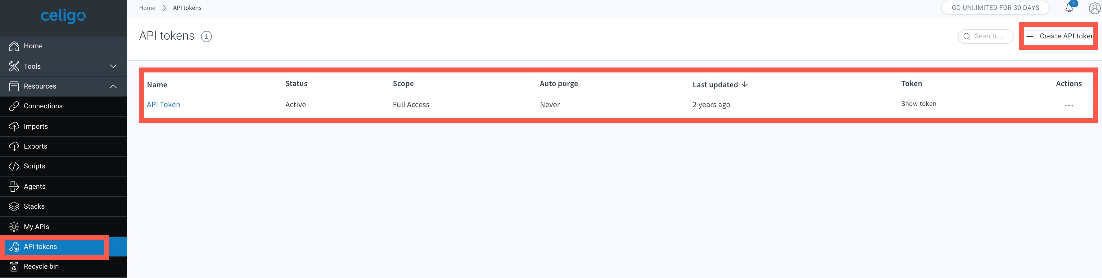

  • Before you set up your connection, ensure to generate an access token at the account level with full access from Resources > APITokens .

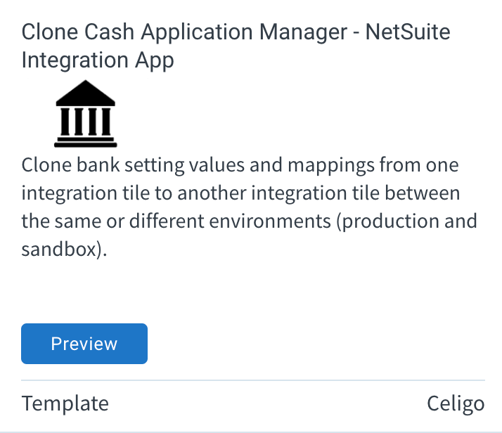

  4. Search for the Clone Cash Application Manager - NetSuite Integration tile and click Preview .

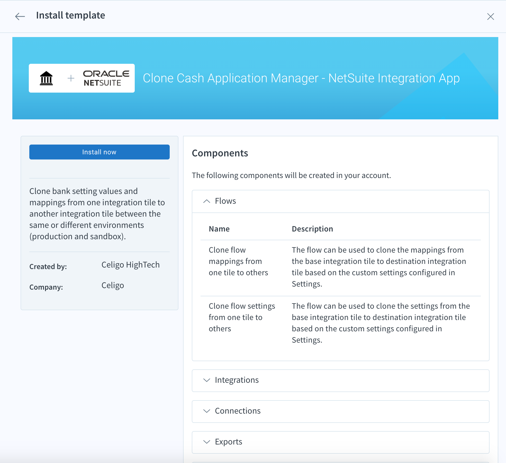

    You can preview the components that are packaged as part of the selected integration.
  5. On the Clone Cash Application Manager - NetSuite Integration App page, click Install now.

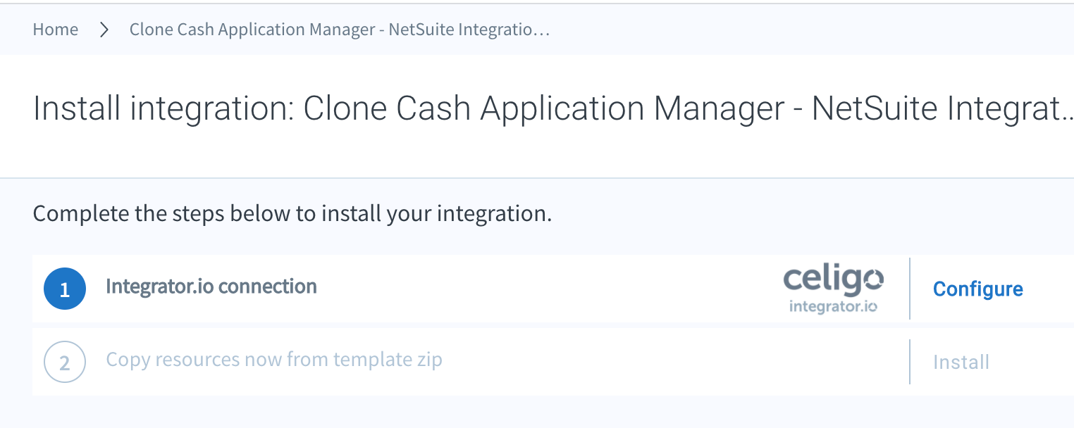

  1. On the Install integration: Clone Cash Application Manager - NetSuite Integration App , next to Step 1, click Configure .

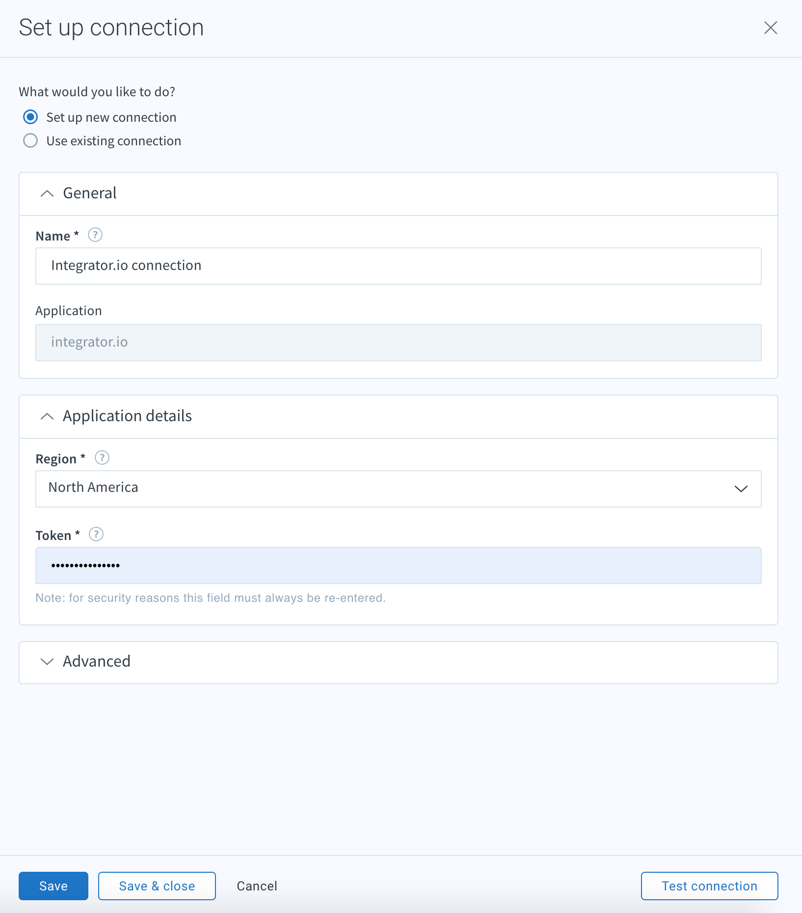

  2. On the “Set up connection” page, you can choose to set up either a new connection or an existing connection.
    1. If you choose to Use Existing Connection , select the connection from the drop-down list.
    2. If you choose to Setup New Connection , proceed with the below next steps.
  3. In the Name field, enter your connection name.
  4. Enter the access token generated at the account level with full access from Resources > API Tokens .
  5. It is recommended to retain the Advanced Settings and Custom Settings as is.
    In the Advanced Settings, ensure to select the value of the Concurrency level setting as “1.”
  6. Test the connection and click Save & Close .
    If an error is displayed while testing the connection, re-check your details, otherwise contact Celigo Support.

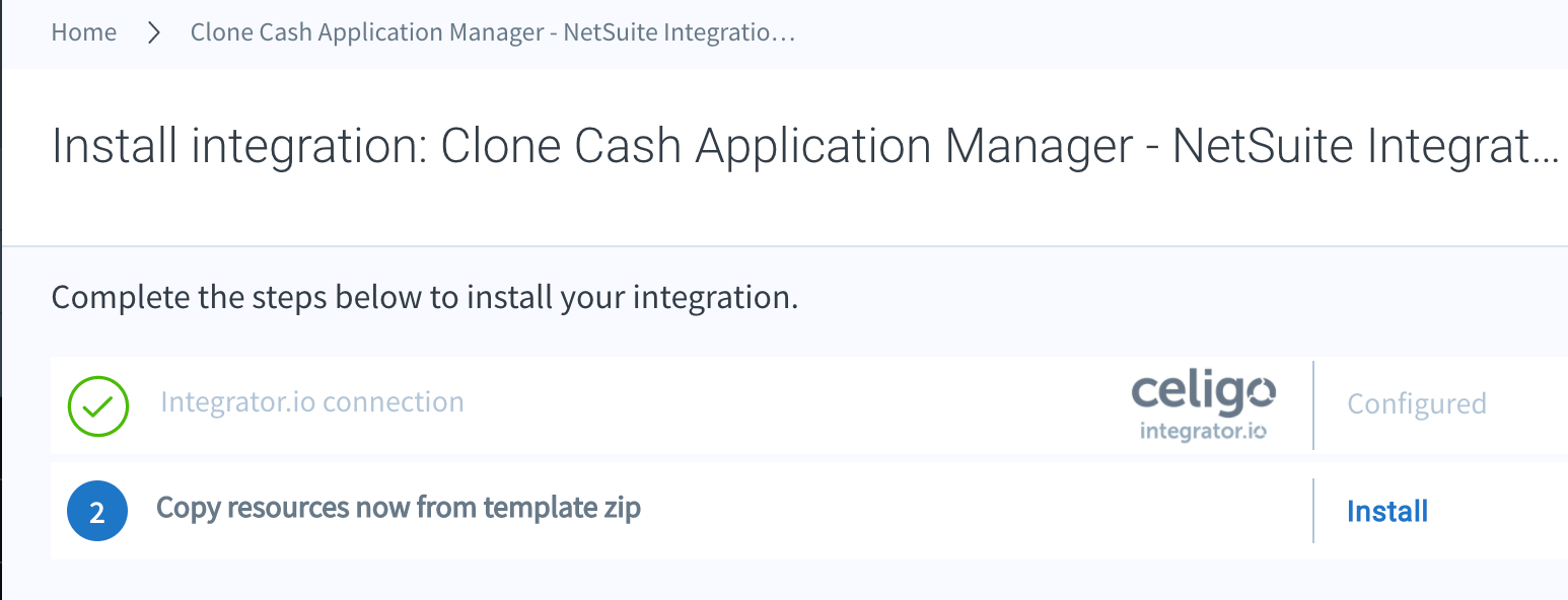

On the “Install app: Cash Application Manager clone utility”, next to Step 2, click Install.
After you successfully install the template zip, you’ll be redirected to the Flows page.
