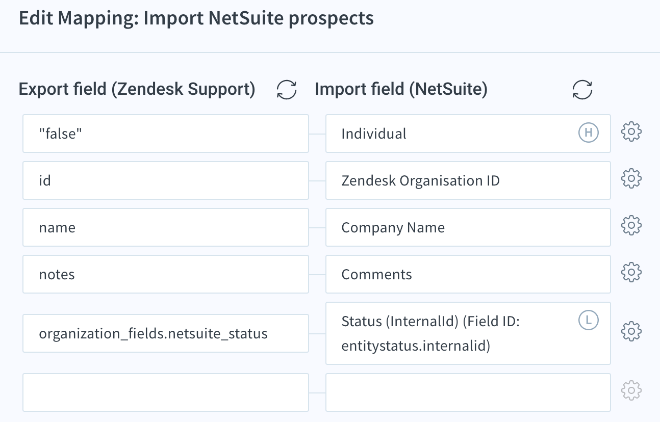

Zendesk Support prospect organization to NetSuite prospect
The integration flow exports recently created organizations from Zendesk Support to prospects in NetSuite.
Flow details
Export source: Zendesk Support
Import destination: NetSuite
Built-in export: Get Zendesk Support organizations – Get all the Zendesk Support organizations that were modified since the last flow run time.

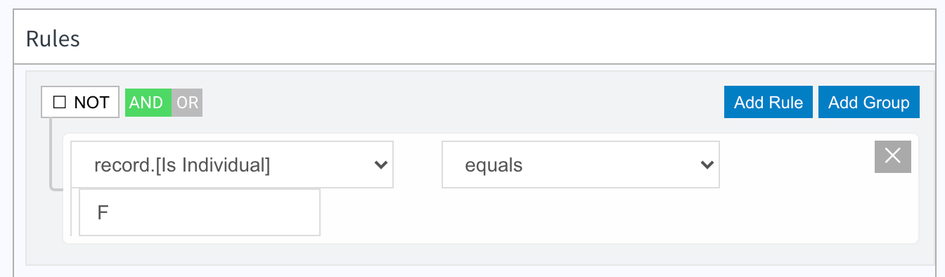

Built-in input filter: filter records
Built-in import: Import NetSuite prospects – Add (or update) prospects into NetSuite with the Name as the lookup identifier.

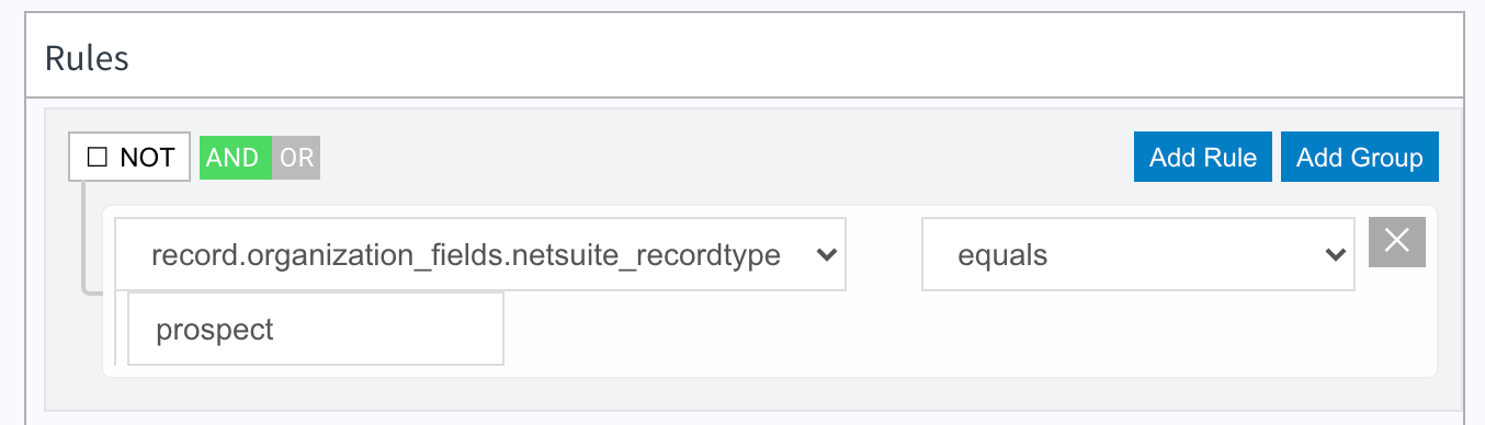

The NetSuite recordType field must be included in Zendesk Support.
Setup instructions
  1. Use an advanced Static: Value to Value lookup to map Prospects in the NetSuite Status field according to your business needs.
  2. Add subsidiary mappings (Standard, Hard-coded, etc.) to the Import NetSuite prospects step according to your business needs.
  3. Configure your NetSuite individuals field in the Import NetSuite prospects step according to your business needs.
  4. Create a custom drop-down list in the Import NetSuite prospects step to configure the Zendesk organizations as a NetSuite status in your import mapping.
  5. Create a custom text field in the Import NetSuite prospects step to configure the Zendesk Support organizations as a NetSuite record type and configure it in the filter rules.

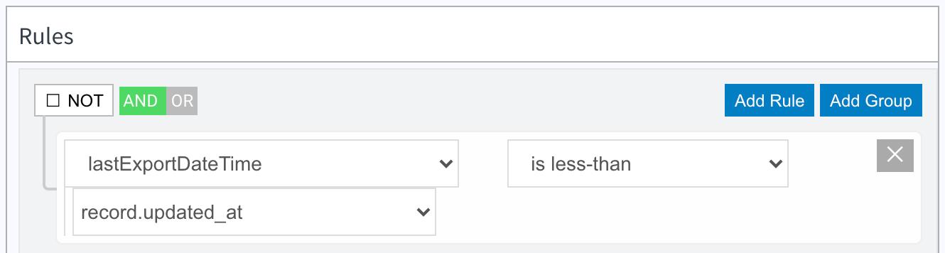

Built-in export: Get Zendesk Support users – Get all Zendesk Support users that were modified since the last flow run time.

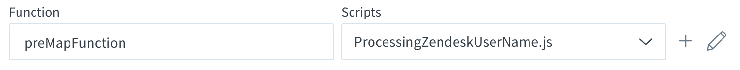

Built-in output filter: filter records
Built-in import: Import NetSuite employees – Add or update employees into NetSuite with their email as the lookup identifier.
Setup instructions

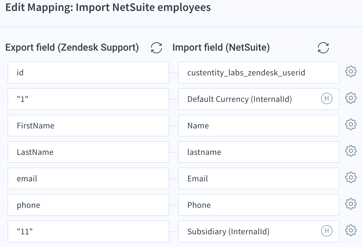

  1. Add subsidiary mappings (Standard, Hard-coded, etc.) for the Import NetSuite employees step based on your business requirements.
  2. Configure your mappings for Default Currency (Internal Id) in the Import NetSuite employees step based on your business requirements.
Output filter: Filter records Import mapping: Import NetSuite employees Hook: preMapFunction

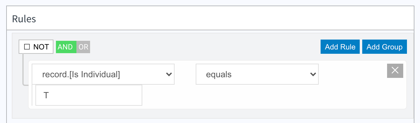

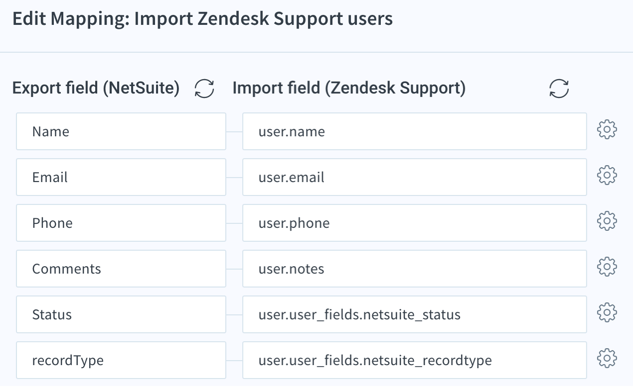

Built-in import: Import Zendesk Support users – Add or update users into Zendesk Support with their email as the lookup identifier.

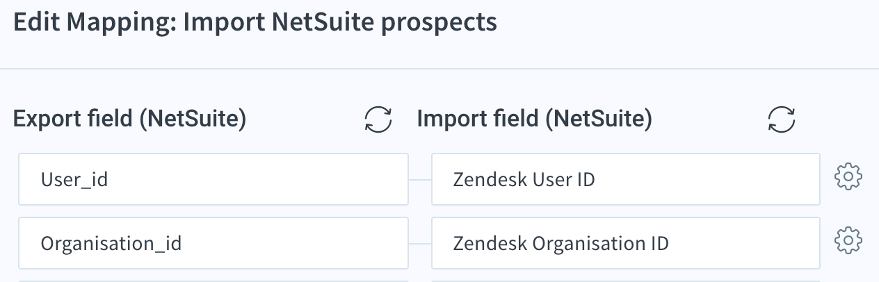

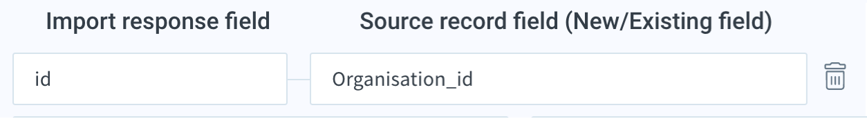

Built-in import: Import NetSuite prospects – Update the Organization or User Id in NetSuite using the Internal Id as the lookup identifier.

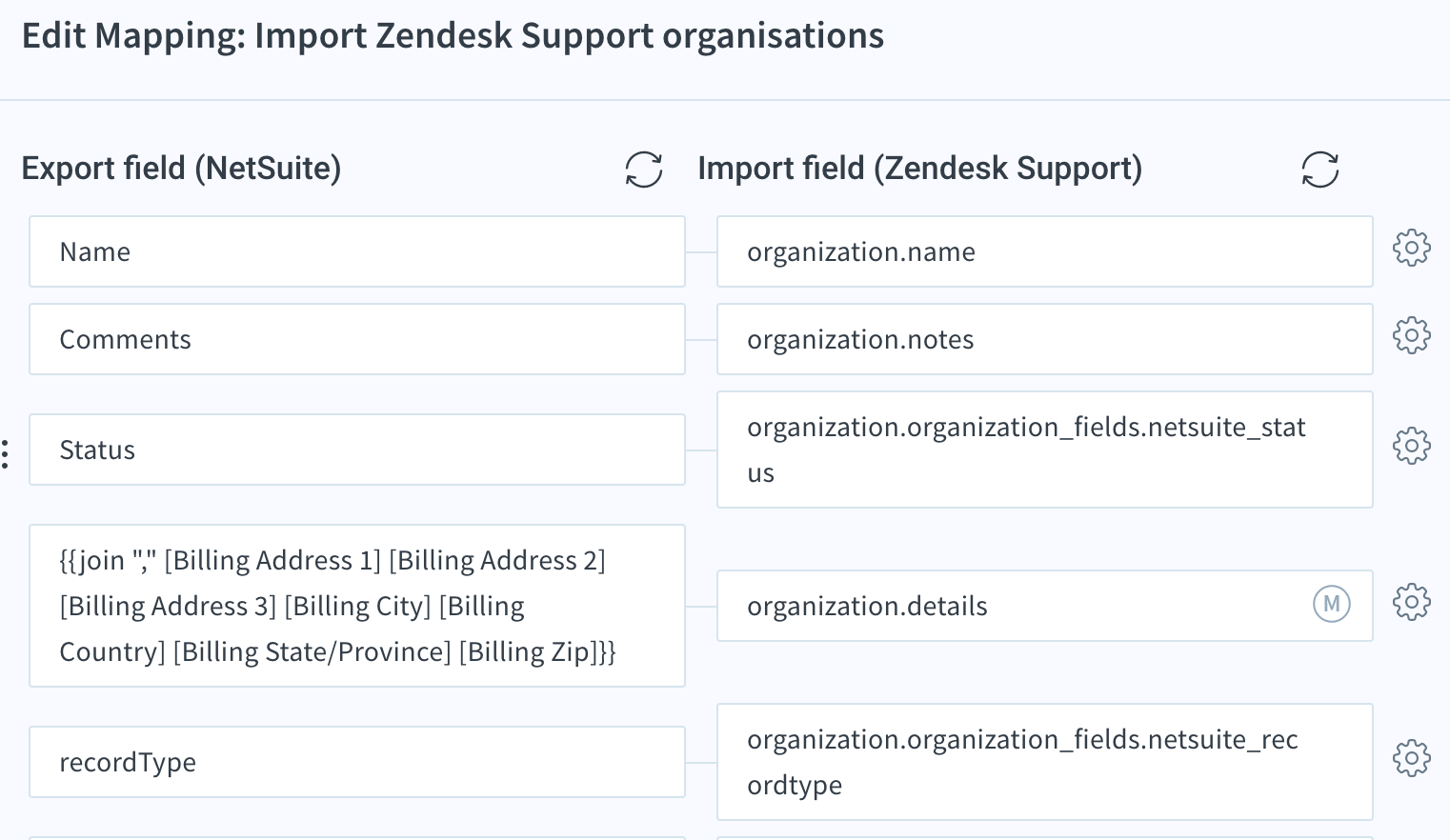

  1. Create a custom drop-down list in the Import Zendesk Support organizations step to configure the NetSuite status as a Zendesk Support organization in your import mappings.
  2. Create a custom text field in the Import Zendesk Support organization step to configure the NetSuite recordType as a Zendesk Support organization in your import mappings.
  3. Create a custom drop-down list in the Import Zendesk Support users step to configure the NetSuite status as a Zendesk Support user in your import mappings.
  4. Create a custom text field in the Import Zendesk Support users step to configure the NetSuite recordType as a Zendesk Support organization in your import mappings.
