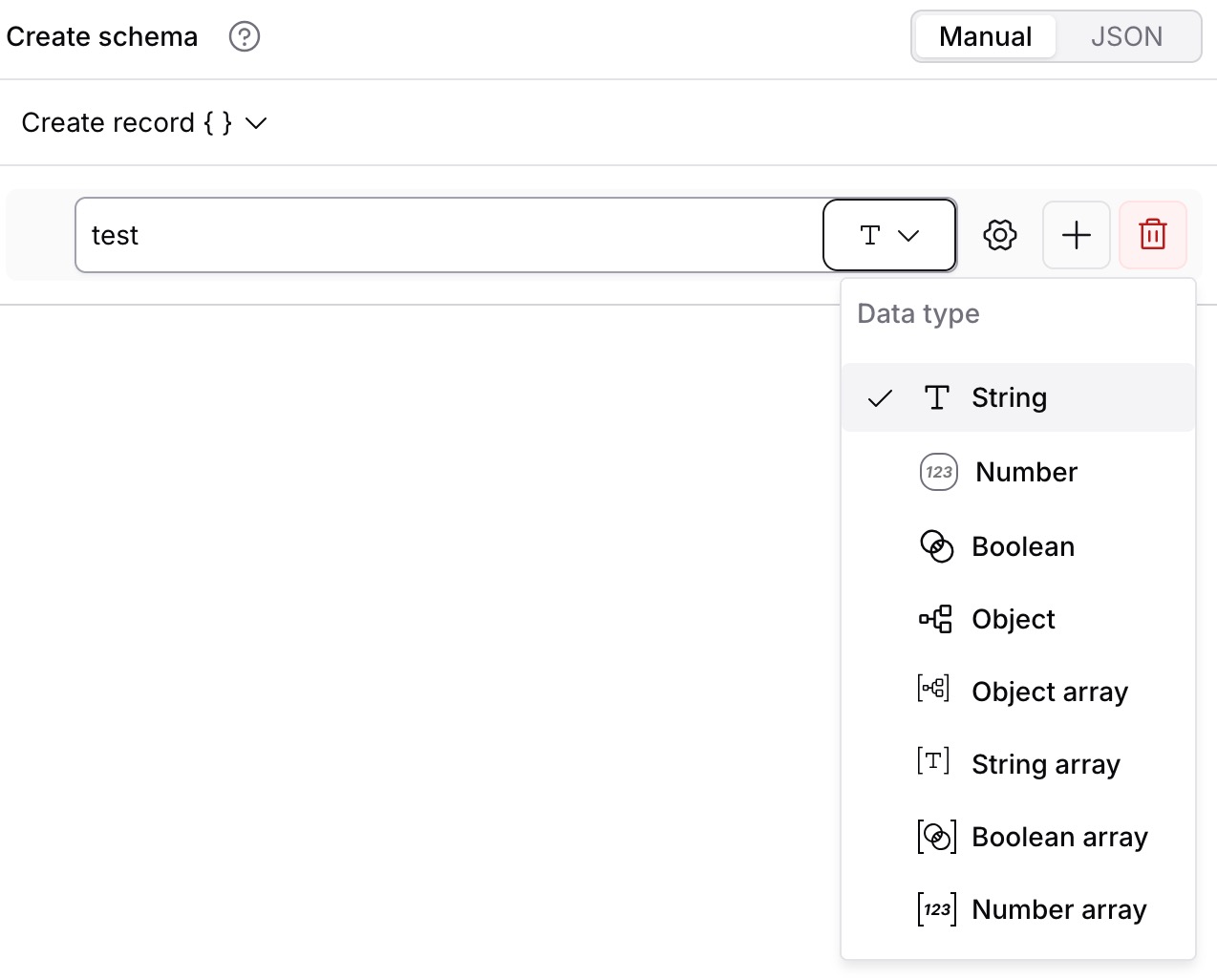

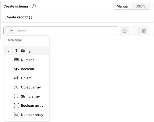

  4. Under Create schema, choose Manual to build the schema visually or JSON to write JSON Schema. Switching from JSON to Manual removes keywords Manual mode doesn't support, after a confirmation. For when to use each mode, see Tool schema and validation reference.

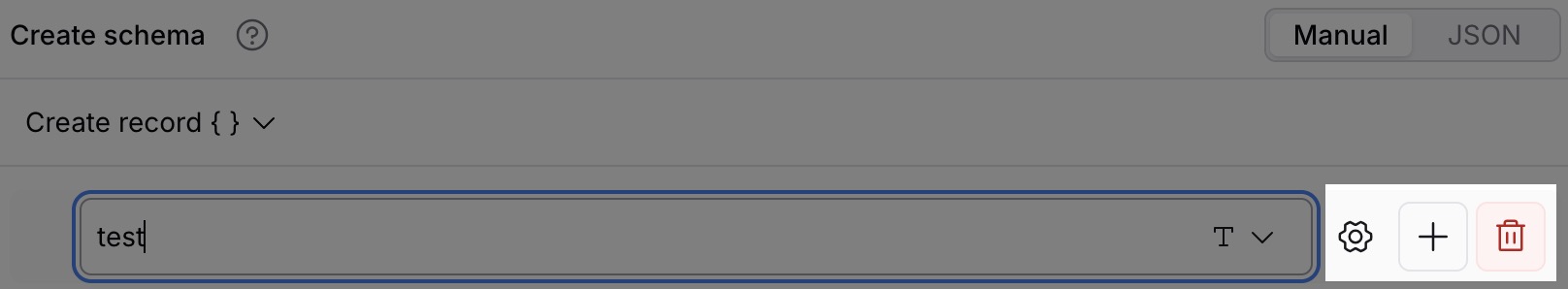

  5. In Manual mode, select Create record { } to add a property, then enter its name and select its type at the left of the row. Point to any row to view and modify validation settings, add a child property, and delete the property.
