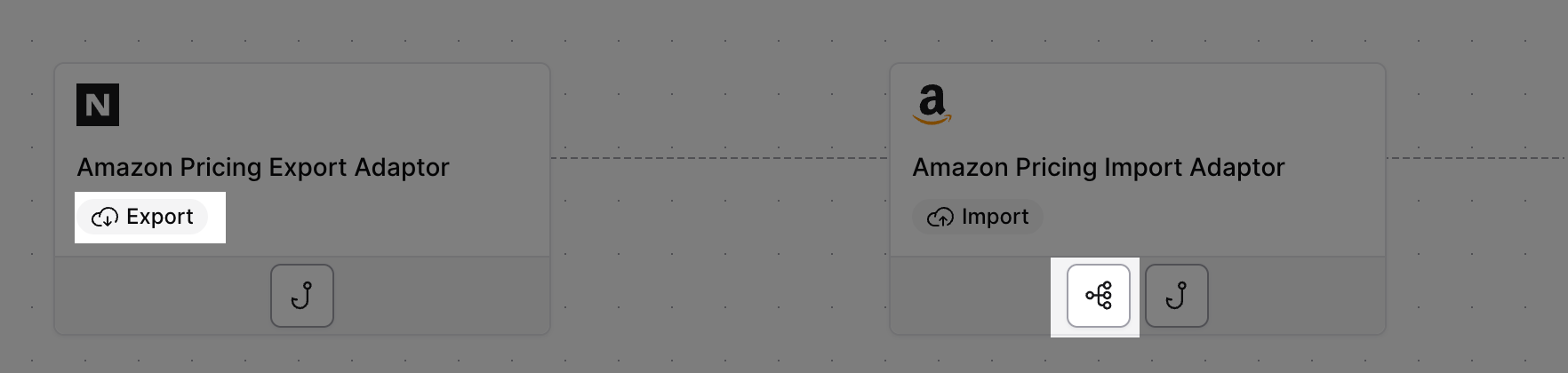

  1. Open the flow and select Amazon Pricing Export Adaptor (the first step in the flow).

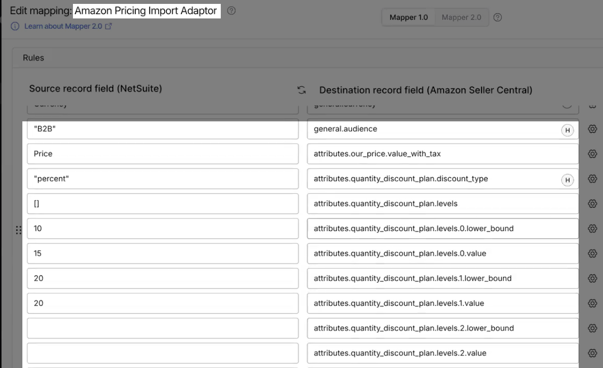

  1. Select Mappings across the import Amazon Pricing Import Adaptor. On the Edit Mapping page, configure the fields as explained below.
  2. General audience: pre-configured to B2B. Change this value to B2C only if you want to use this template for consumer-facing pricing..
  3. Discount plan type: Set the type of discount to offer to business buyers.
    • Export field (Amazon Seller Central): (hardcoded value)
    • Import field (NetSuite): discountType
    • The accepted values:
      • Percentage: buyers receive a percentage-based discount.
      • Fixed: buyers receive a fixed price reduction
      In the mapping editor, enclose hardcoded values in quotes, for example, "Percentage".
  4. Plan level: Leave this field empty. No configuration is required.
  5. Discount levels: Configure up to five quantity-based discount levels. Two levels are pre-configured by default. For each level, map the following two fields.
  6. Select Save & close.

The template ships with two pre-configured levels. To add levels three through five:
  1. In the mapping editor, locate the existing lower bound quantity and discount value fields for levels 1 and 2.
  2. Replicate those destination fields for the next level.
  3. Update the index in the destination field name to match the new level number. For example, change [1] to [2] for level 3.
  4. Enter the lower bound quantity and discount value for the new level.
  5. Repeat for each additional level, up to a maximum of five.
    Amazon supports a maximum of five discount levels. Adding more than five levels will cause the flow to fail.
