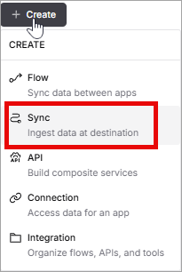

- Go to Home
, select Create, and then select Sync.

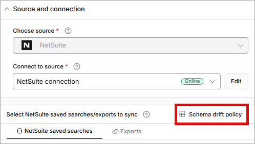

- Follow the steps to choose a source and connect to it (see Create a data ingestion sync).
- Set the schema drift policy (see Configure a schema drift policy).

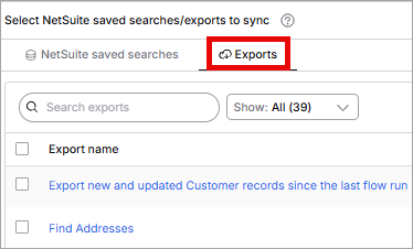

- If your connection has options other than exports, select Exports.
If source application metadata isn't available for an export, Celigo sync provides intelligent defaults: it inspects sample request data to infer each column's data type (such as mapping
created_attoDATETIMENTZ).Tip
For data ingestion exports, retrieve as much context as possible by using a
ListorGet allAPI endpoint or writing an inclusive SQL statement (for example, pulling all Zendesk tickets without extra parameters). Choose Export type: All for complete datasets or Delta for incremental syncs.
- Optionally, add an field-level schema policy override (see Configure a schema drift policy).
- Select each export you want to sync, or select the checkbox in the header row to select all.
