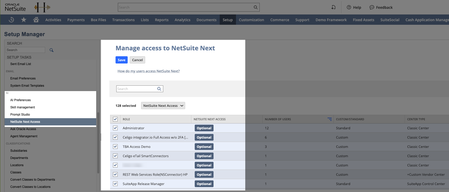

  1. Sign in to NetSuite using the Administrator role.
  2. Go to Setup > Company > AI > NetSuite Next Access.
  3. Select the roles that should have access, or select Select All.
  4. From the access dropdown, choose Optional.
  5. Select Save.
  6. Sign out of NetSuite and sign back in.
Switch to NetSuite Next should now appear.
