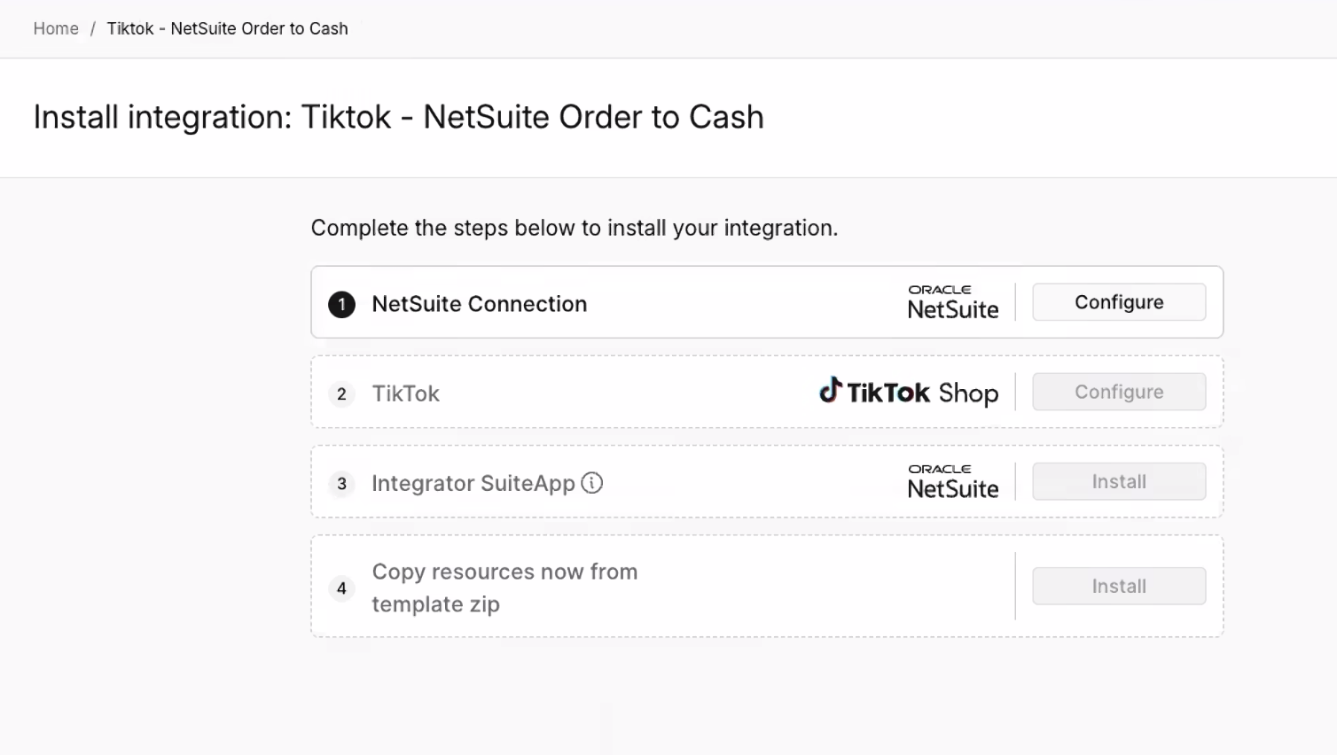

Install the TikTok - NetSuite Order to Cash template
To install the template:
  1. Navigate to integrator.io > Marketplace.
  2. Search for TikTok - NetSuite Order to Cash template.
  3. Open the template and review the template contents.
  4. Select Install now.
  5. Configure a connection to NetSuite (Token-based authentication).
  6. Configure TikTok connection.
  7. Install the Integrator SuiteApp.
  8. Install Copy resources now from template zip.
  9. Complete the installation.
