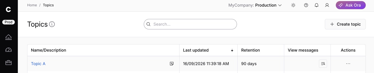

- A Celigo topic is created and managed in integrator.io under Resources > Topics. Celigo stores the messages. You don't run any infrastructure.

| Create a topic and set its retention | Create and manage topics |
