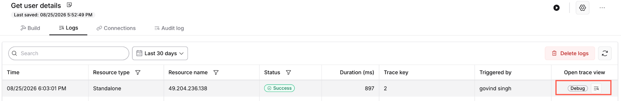

  1. Go to AI studio ai-studio-icon.png, and then select Tools.
  2. Select the tool, and then select Logs.
Search and filter
  • Search filters the list by text.
  • The date range (default Last 5 mins) offers presets and Custom range, where you set Start time, End time, and Timezone, and then Apply. Clear removes it.
  • The Resource type, Resource name, and Status columns have filters.
  • Select Refresh refresh.png to reload the list.
Invocation list
Column Description
Time When the invocation started.
Resource type AI Agent, MCP Server, or Standalone (a direct REST API call).
Resource name The agent or MCP server; for a REST API caller, the caller's IP address.
Status Whether the run succeeded or failed.
Duration (ms) Elapsed time in milliseconds.
Trace key The value of the tool's trace key template for this record, if one is set. See Configure tool input.
Triggered by The account owner for agent invocations; the token's owner for MCP and REST API invocations.
Open trace view Opens the trace view. A Debug badge marks invocations logged at the Debug level.

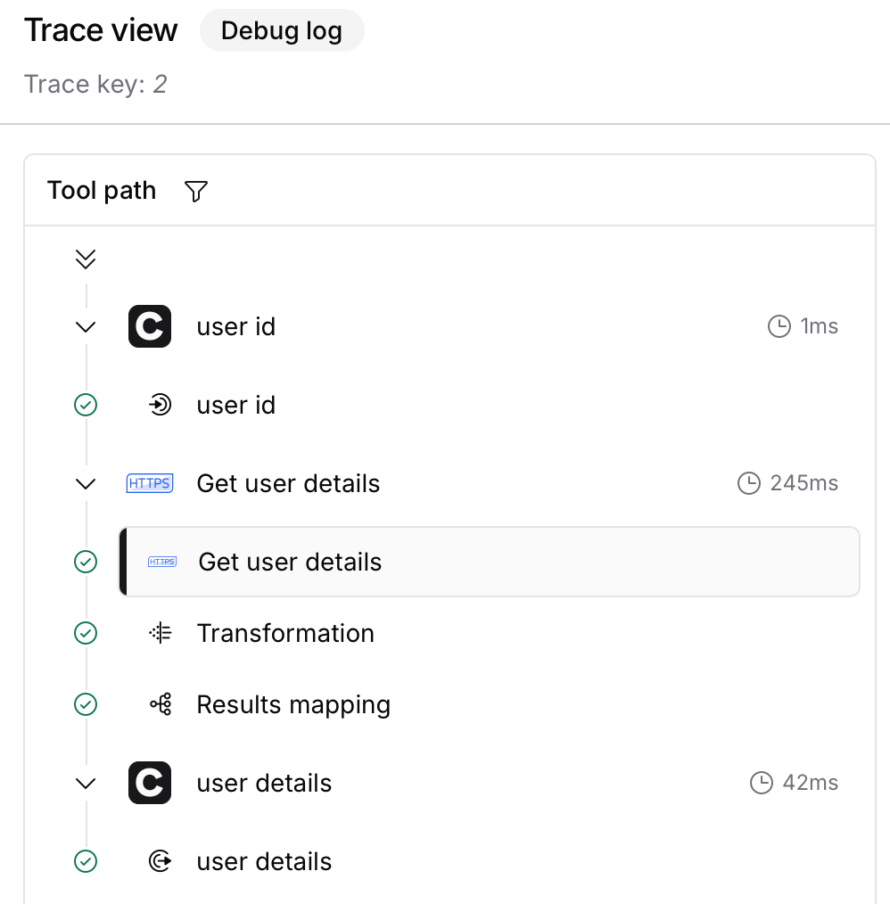

Trace view
The trace view shows the run step by step. The left pane lists the steps in order, from the Tool input boundary through each step to the Tool output boundary; nested tools appear inline, up to five levels deep. Select a step to see its input and output in the right pane.
  • Where request and response detail is available, Request shows General details, Headers, and Body, and Response shows what the application returned. Select Copy to copy a payload.
  • A step that processed several records shows a child list you can filter by status and page through.
Request and response detail is available for HTTP, NetSuite, and Salesforce connectors. Other connectors show the step's input and output only.
Salesforce steps log request and response detail at lower levels than other connectors. At Basic, successful steps record metadata only, and failed steps also record the request and response. Standard records the request and response for every call, and Detailed records them as flows do. Debug adds the inputs and outputs of mappings, transformations, and similar step components.

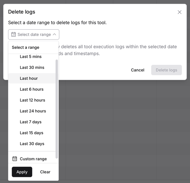

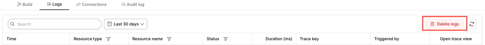

Delete logs
Account owners, administrators, and users with Manage access can delete a tool's logs.
  1. On Logs, select Delete logs.
  2. Choose the date range.
  3. Select Delete logs.
