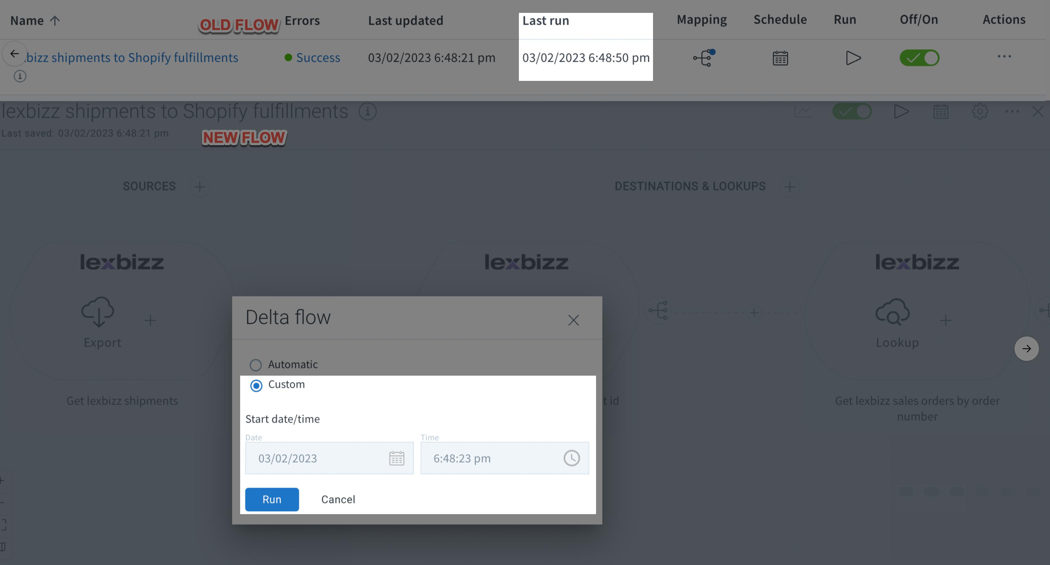

If you have chosen to use Option 1 to update the flow, once all the mapping updates are done in the new flow based on the old flow, refer to the Last run details (run timestamp) of the old flow and use the Custom run in Run now setting to run the new flow for the first time so that the flow doesn't sync all the records again.
Once the Custom run is complete, select the Run now setting and close the window, and then schedule the new flow by referring to the old flow schedule details.

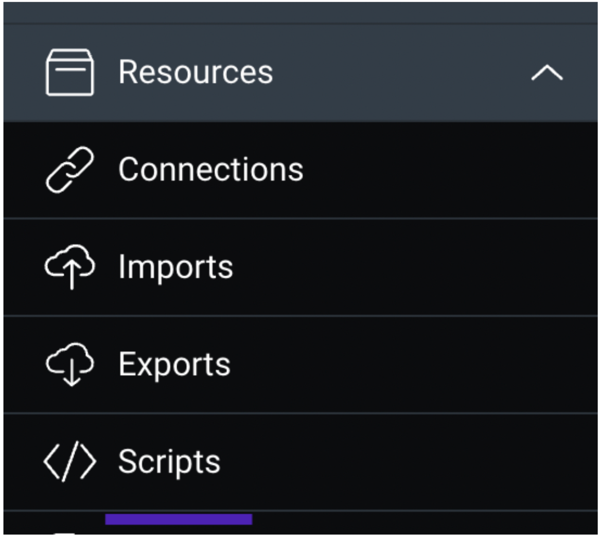

  5. After adding the lookup Get a list of fulfillment orders for a specific order, and import steps Move the location of fulfillment Order and Import Shopify fulfillments. Create a script under Resources → Scripts.

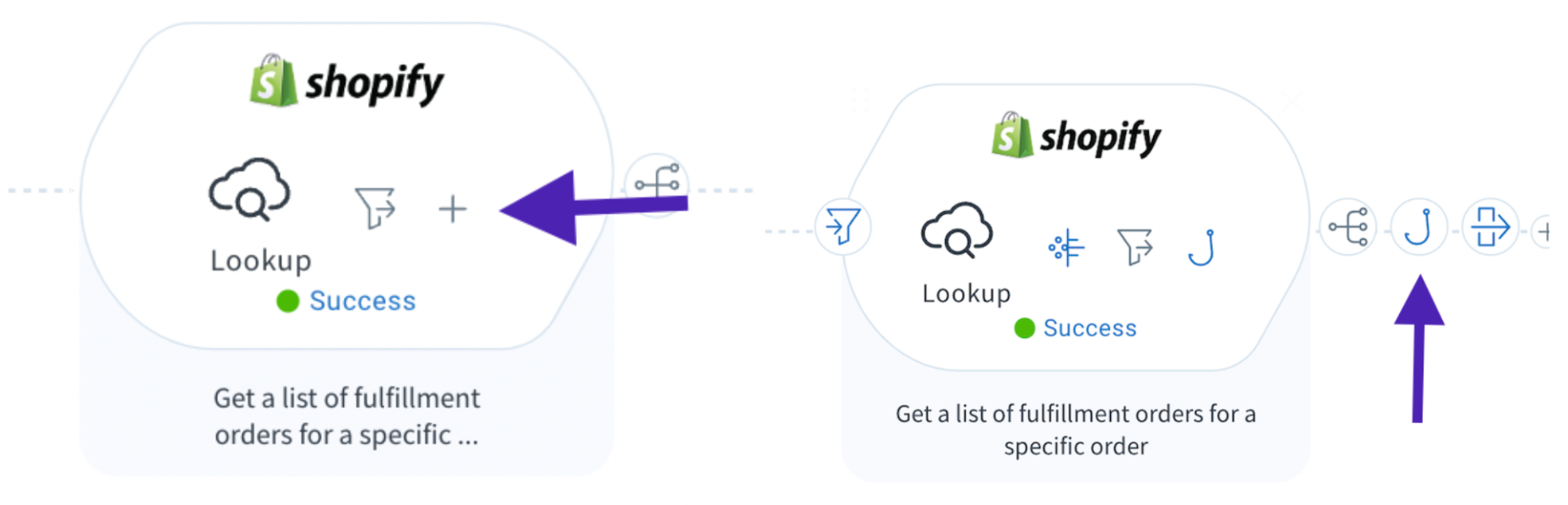

  8. Go back to the flow. In the Get a list of fulfillment orders for a specific order lookup, select + and then select the hook.
  9. Select the script that you have created.
  10. Select Save and then select Close.

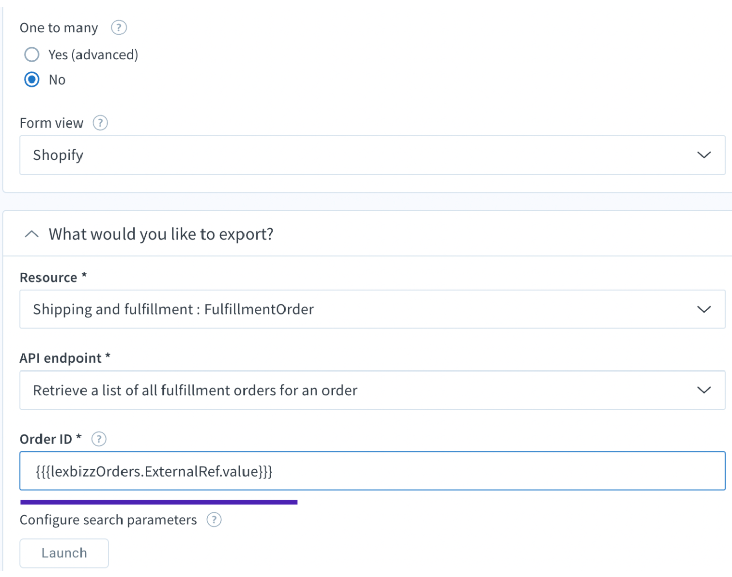

  11. Open the Get a list of fulfillment orders for a specific order lookup step, in the Order ID field, enter the value {{{lexbizzOrders.ExternalRef.value}}}.

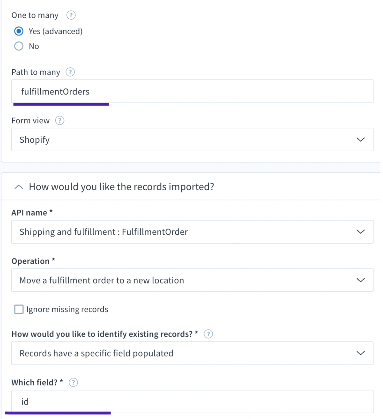

  12. Open the Move the location of fulfillment Order import step, in the Path to many field, enter the value fulfillmentOrders.
  13. In the Which field? setting, enter id.

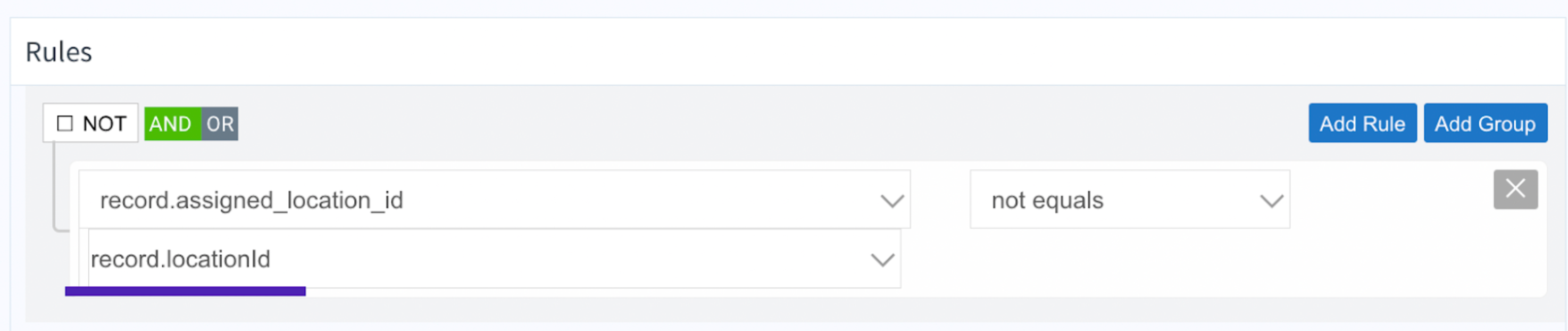

  14. In the Move the location of fulfillment Order import, add an input filter.

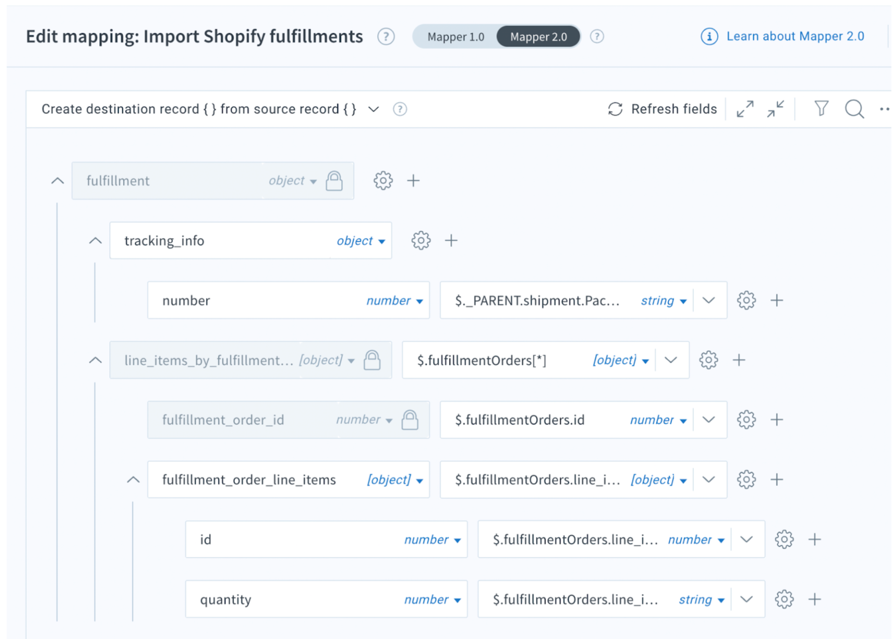

  15. Open the mappings of the Import Shopify fulfillments and use Mapper 2.0 to configure the mappings provided in the table below.
    Destination record fields
    Source record fields
    fulfillment.tracking_info.number
    $.shipment.Packages[0].TrackingNbr.value
    fulfillment.line_items_by_fulfillment_order[*].fulfillment_order_id
    $.fulfillmentOrders[*].id
    fulfillment.line_items_by_fulfillment_order[*].fulfillment_order_line_items[*].id
    $.fulfillmentOrders[*].line_items[*].id
    fulfillment.line_items_by_fulfillment_order[*].fulfillment_order_line_items[*].quantity
    $.fulfillmentOrders[*].line_items[*]. newQuantity

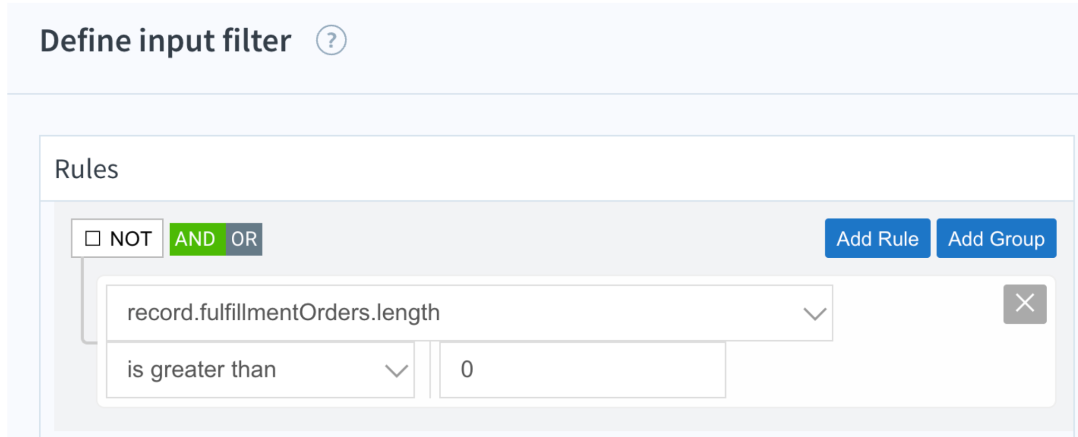

  16. In the Import Shopify fulfillments import, add an input filter to allow only the records with fulfillmentOrders length greater than zero.
