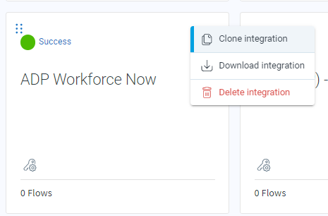

    1. Tile view: Click the overflow (...) menu in the upper-right corner of the tile and select Clone integration.
