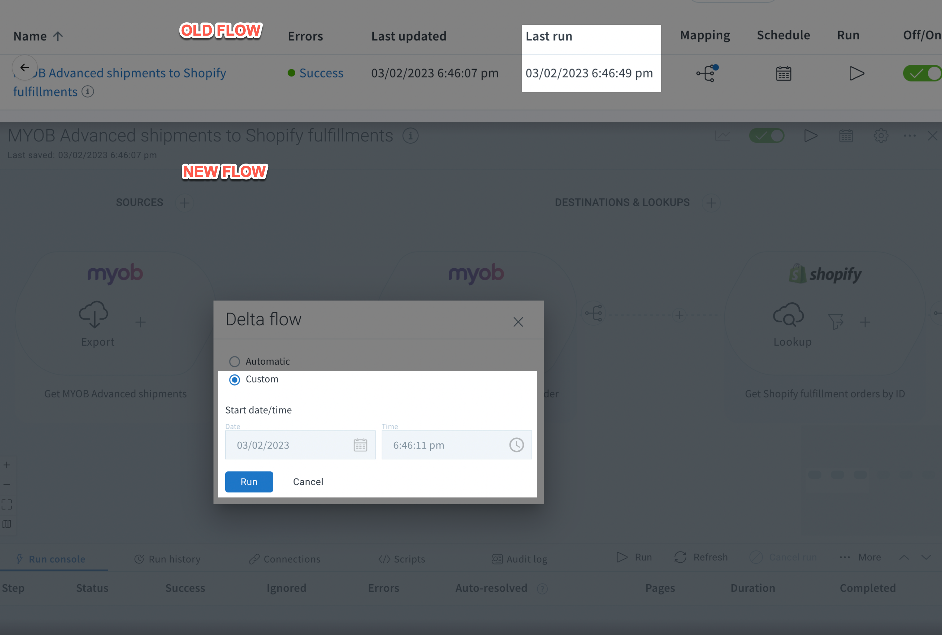

If you have chosen to use Option 1 to update the flow, once all the mapping updates are done in the new flow based on the old flow, refer to the Last run details (run timestamp) of the old flow and use the Custom run in Run now setting to run the new flow for the first time so that the flow doesn't sync all the records again.
Once the Custom run is complete, select the Run now setting and close the window, and then schedule the new flow by referring to the old flow schedule details.

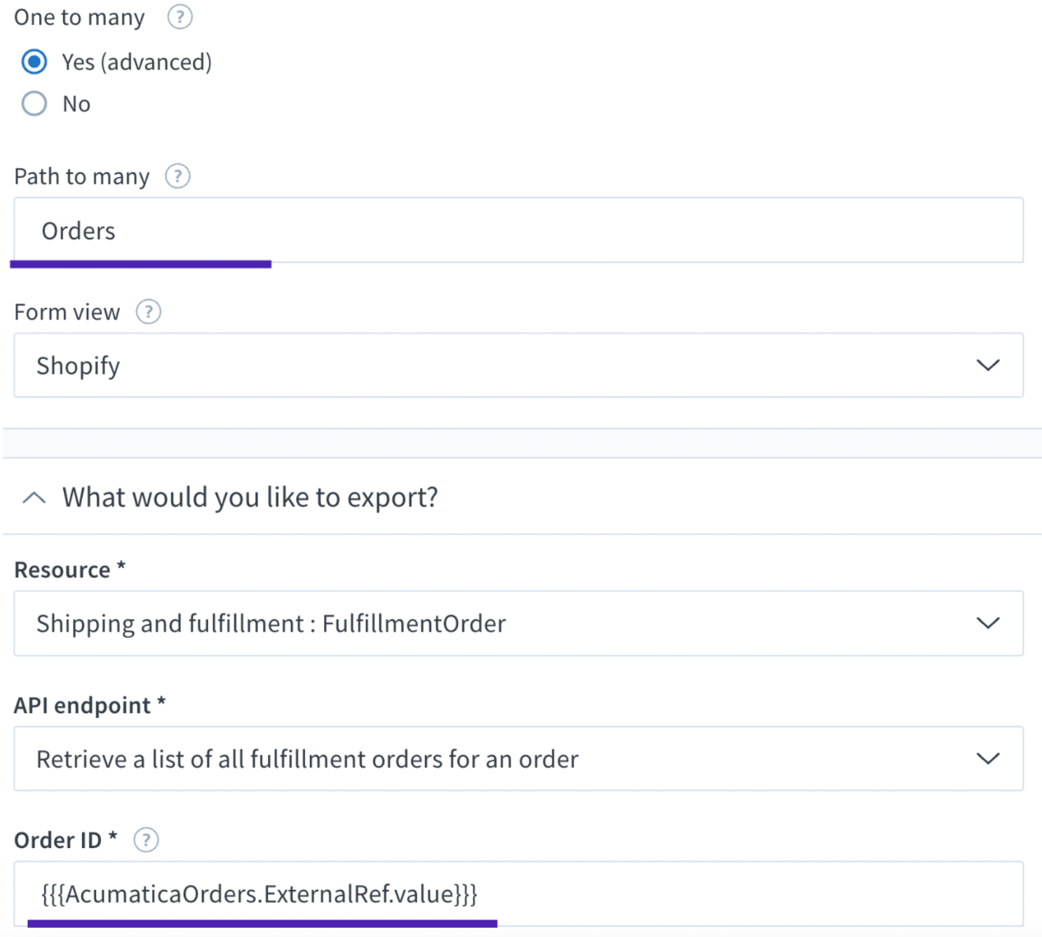

  5. Open the Get a list of fulfillment orders for a specific order lookup, and set the following:
    1. Path to many: Orders
    2. In the Order ID field, paste {{{AcumaticaOrders.ExternalRef.value}}}.

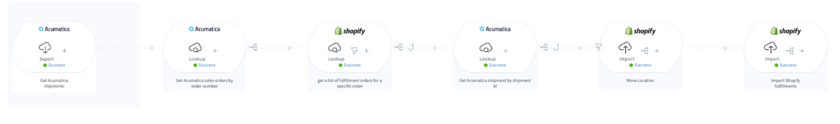

  6. After adding the lookup Get a list of fulfillment orders for a specific order, and import steps Move the location of fulfillment Order and Import Shopify fulfillments. Create a script under Resources → Scripts.

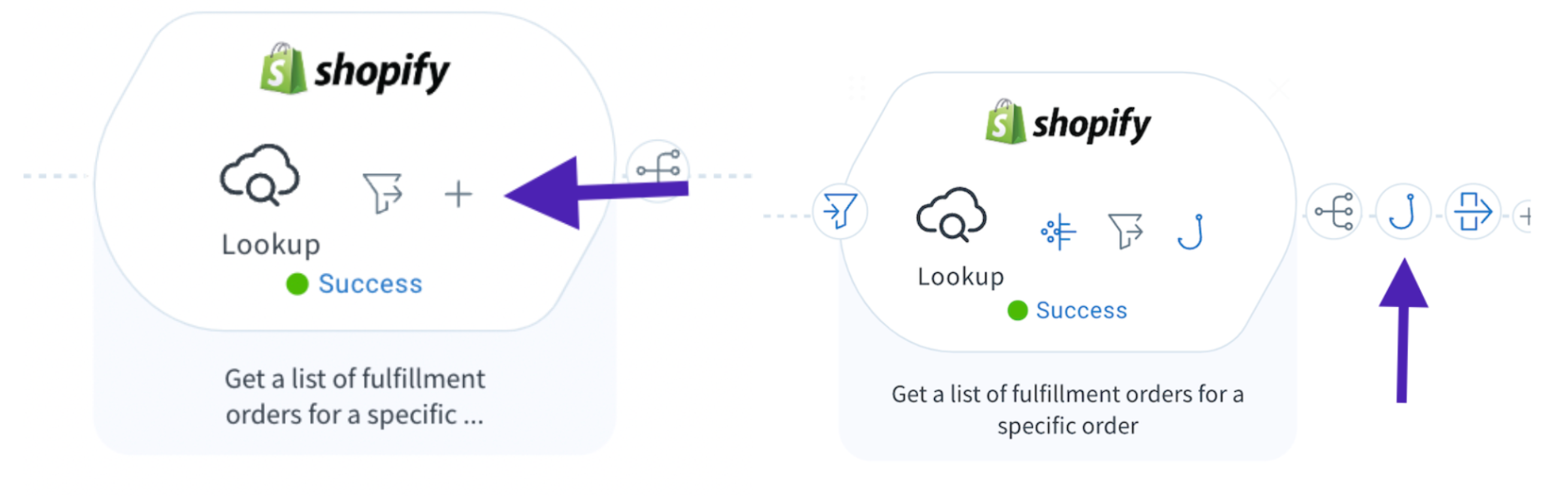

  9. Go back to the flow. In the Get a list of fulfillment orders for a specific order lookup, select + and then select the hook.
  10. Select the script that you have created.

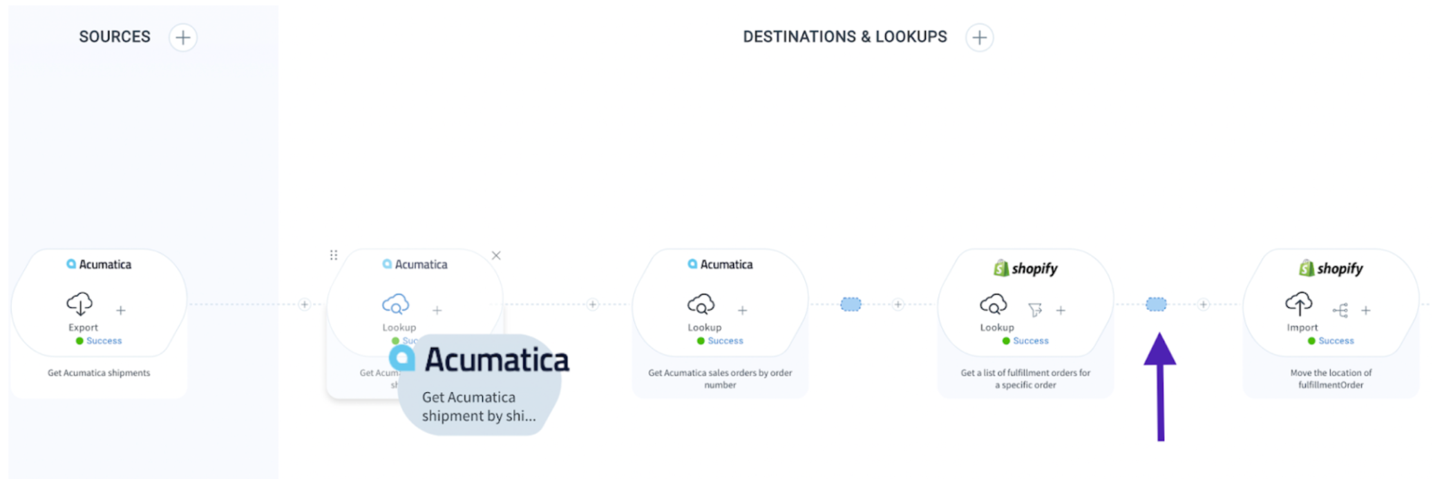

  12. Drag the Get MYOB Advanced shipment by shipment id step to its new position in the flow.

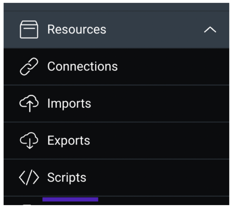

  13. Create another script under Resources → Scripts.
  14. In the Name field, provide a name for the script.
  15. In the Edit content, paste the below code.

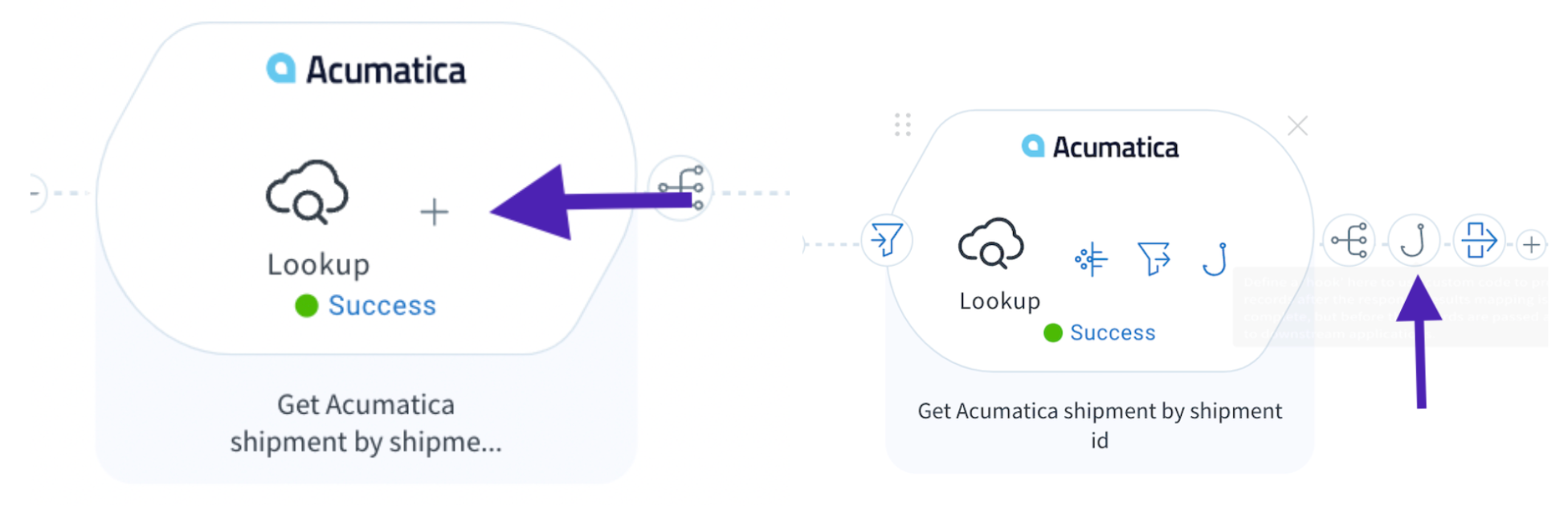

  16. Go back to the flow. In the Get MYOB Advanced shipment by shipment id lookup, select + and then select the hook.
  17. Select the script that you have created.
  18. Select Save and then select Close.

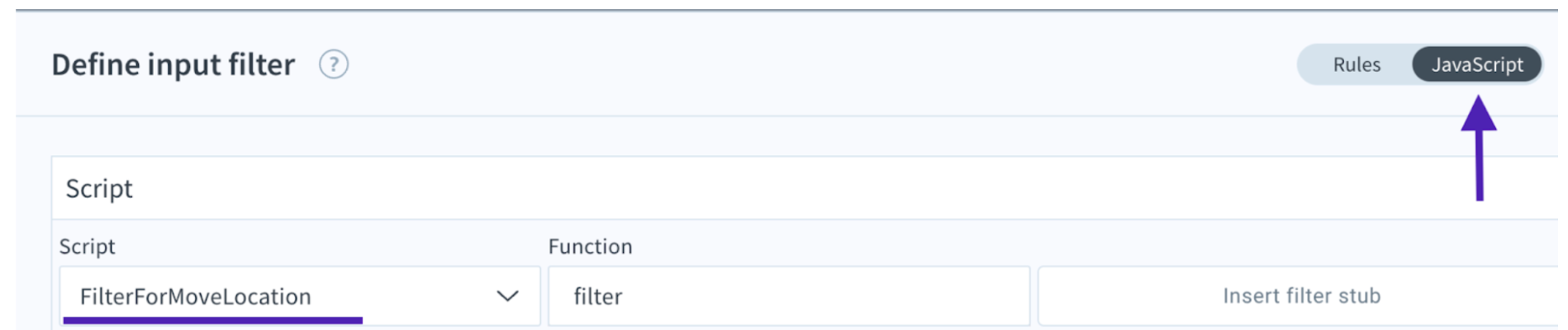

  22. Go back to the flow. In the Get a list of fulfillment orders for a specific order lookup, select + and then select the hook.
  23. Select the input filter icon ​.
  24. Select JavaScript at the top right corner and select the script that you have created in the previous step.

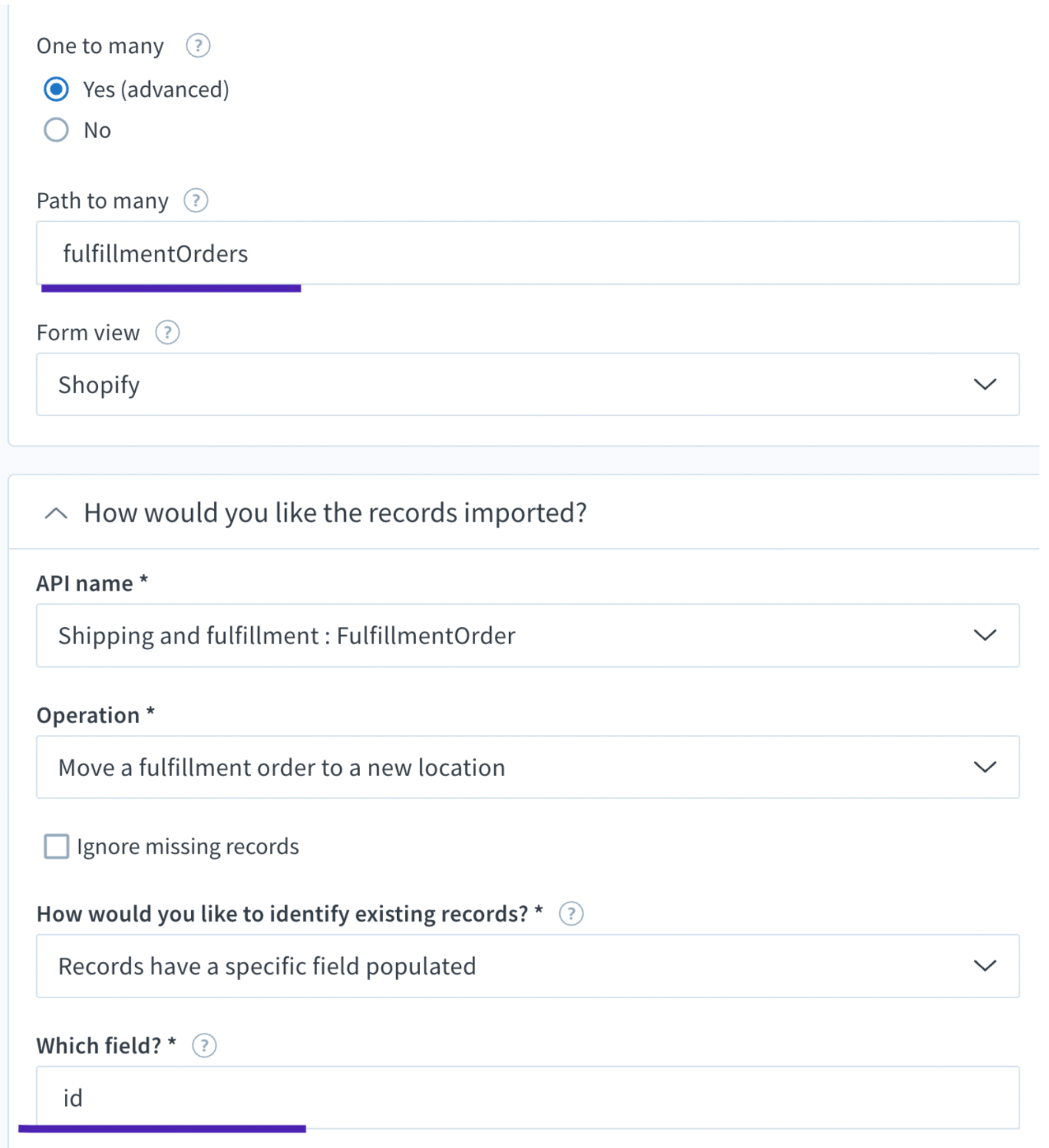

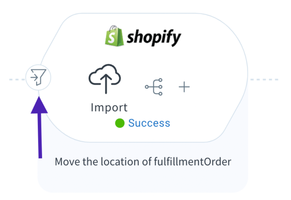

  25. Open the Move the location of fulfillmentOrder import and set the following:
    1. Path to many as fulfillmentOrders
    2. Which field? Enter id

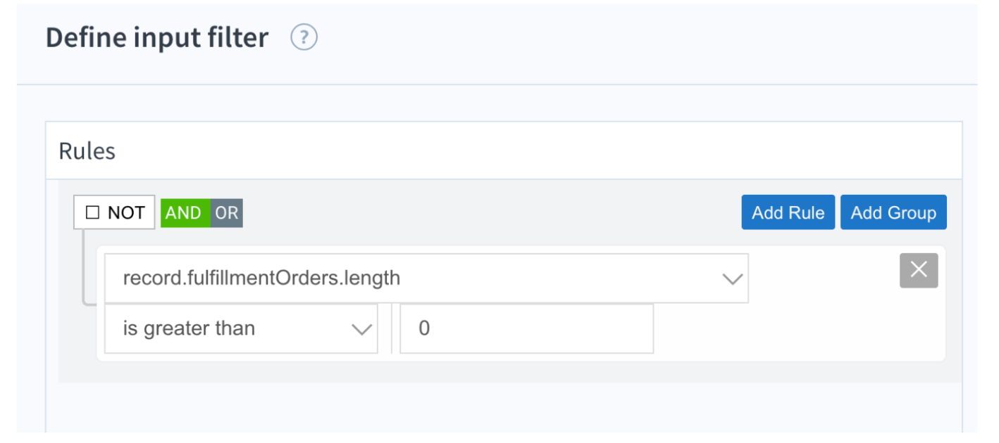

  26. In the Import Shopify fulfillments import, add an input filter to allow only the records with fulfillmentOrders length greater than zero.

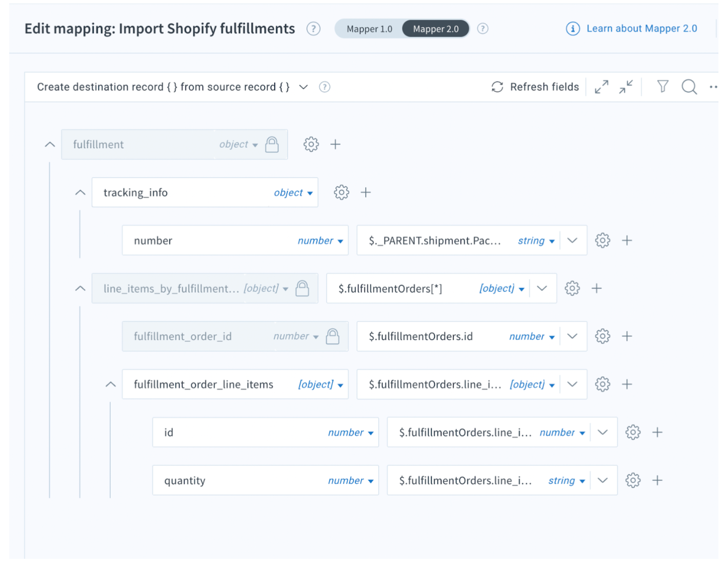

  27. On the Import Shopify fulfillments import, select the Mappings icon and use Mapper 2.0 to configure the mappings provided in the table below.
Destination record fields
Source record fields
fulfillment.tracking_info.number
$._PARENT.shipment.Packages[0].TrackingNbr.value
fulfillment.line_items_by_fulfillment_order[*].fulfillment_order_id
$.fulfillmentOrders[*].id
fulfillment.line_items_by_fulfillment_order[*].fulfillment_order_line_items[*].id
$.fulfillmentOrders[*].line_items[*].id
fulfillment.line_items_by_fulfillment_order[*].fulfillment_order_line_items[*].quantity
$.fulfillmentOrders[*].line_items[*]. newQuantity
