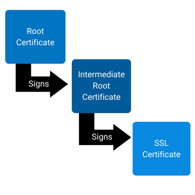

Your connection consists of three hierarchical certificates. The expiring certificate is the “SSL Certificate” (see figure).
Your integrations will not be affected by the expiring certificate unless you are using an HTTPS AS2 connection with a system that does not automatically populate the new certificate.
For customers affected by the changes, ask your trading partners to download the new HTTPS SSL certificate and update your system manually.
