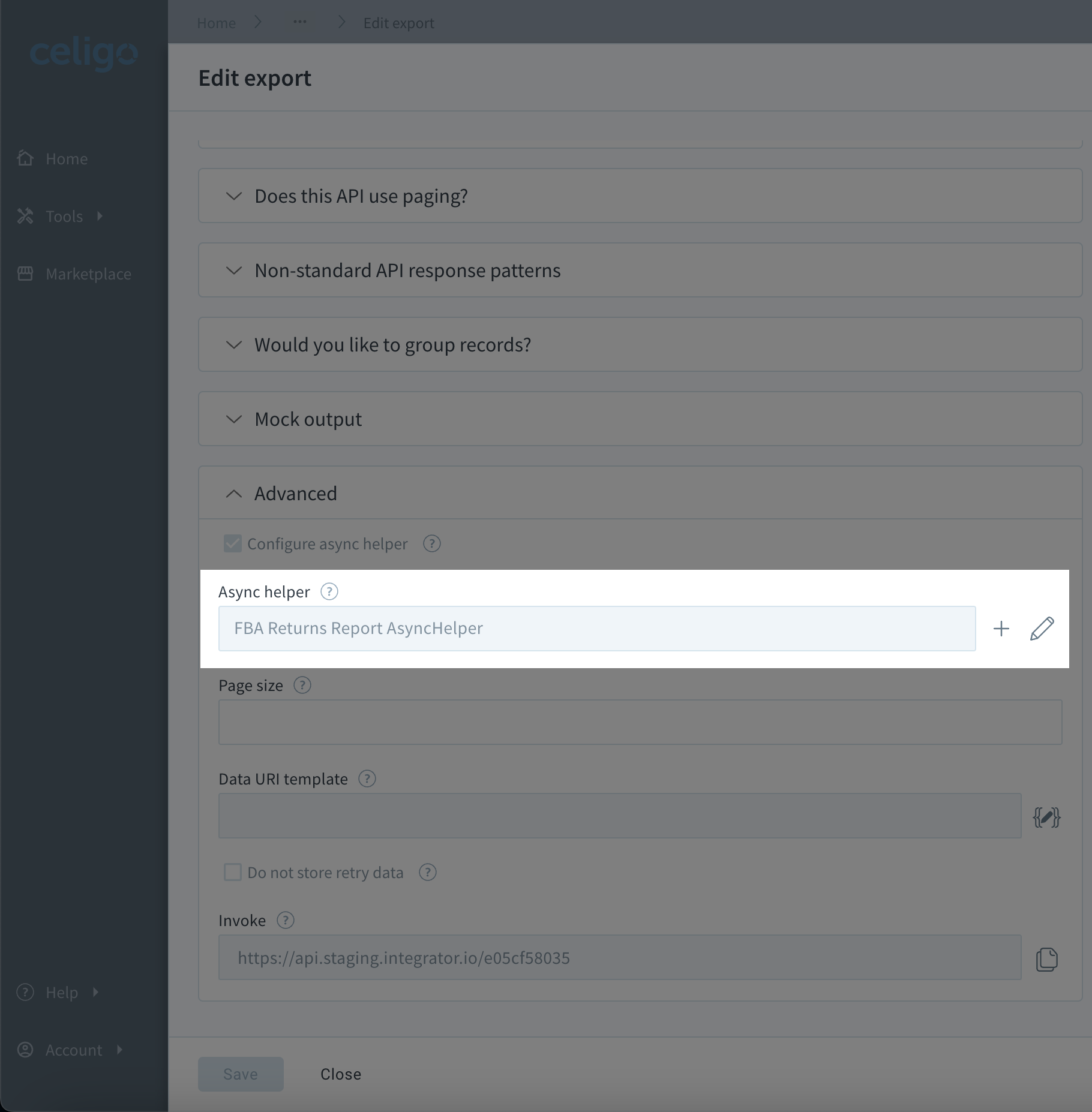

  1. Go to the export bubble of the affected flow (for example, Amazon (FBA) returns to NetSuite RA and item receipts or Amazon (FBA) Inventory Adjustments to NetSuite Inventory Adjustments).
  2. In the Edit export pane, go to the Advanced tab.
  3. Click Edit pencil.svg next to the Async helper setting.

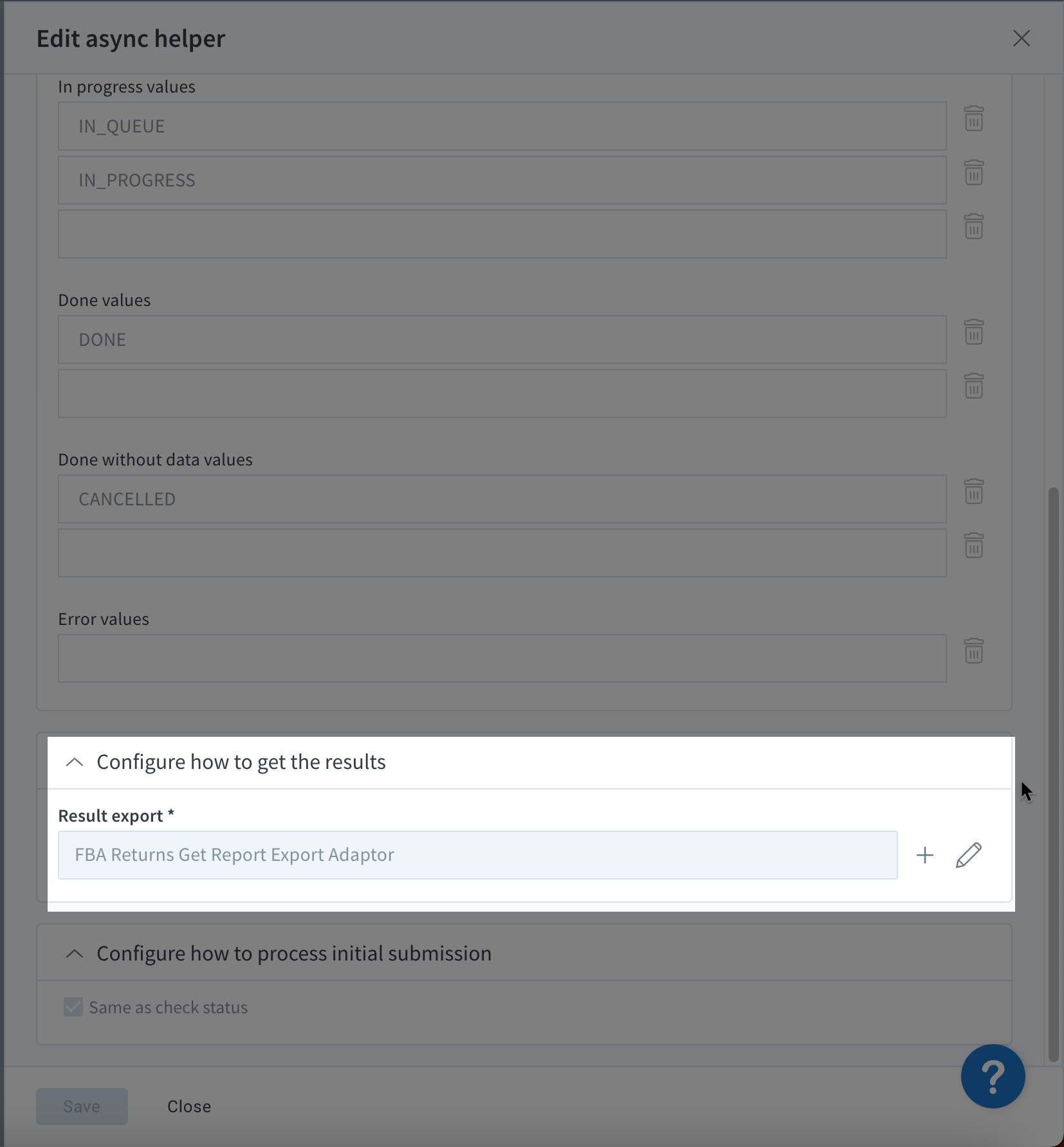

  4. In the Edit Async helper pane, go to the Configure how to get the results section.
  5. Click Edit pencil.svg next to the Result export setting.

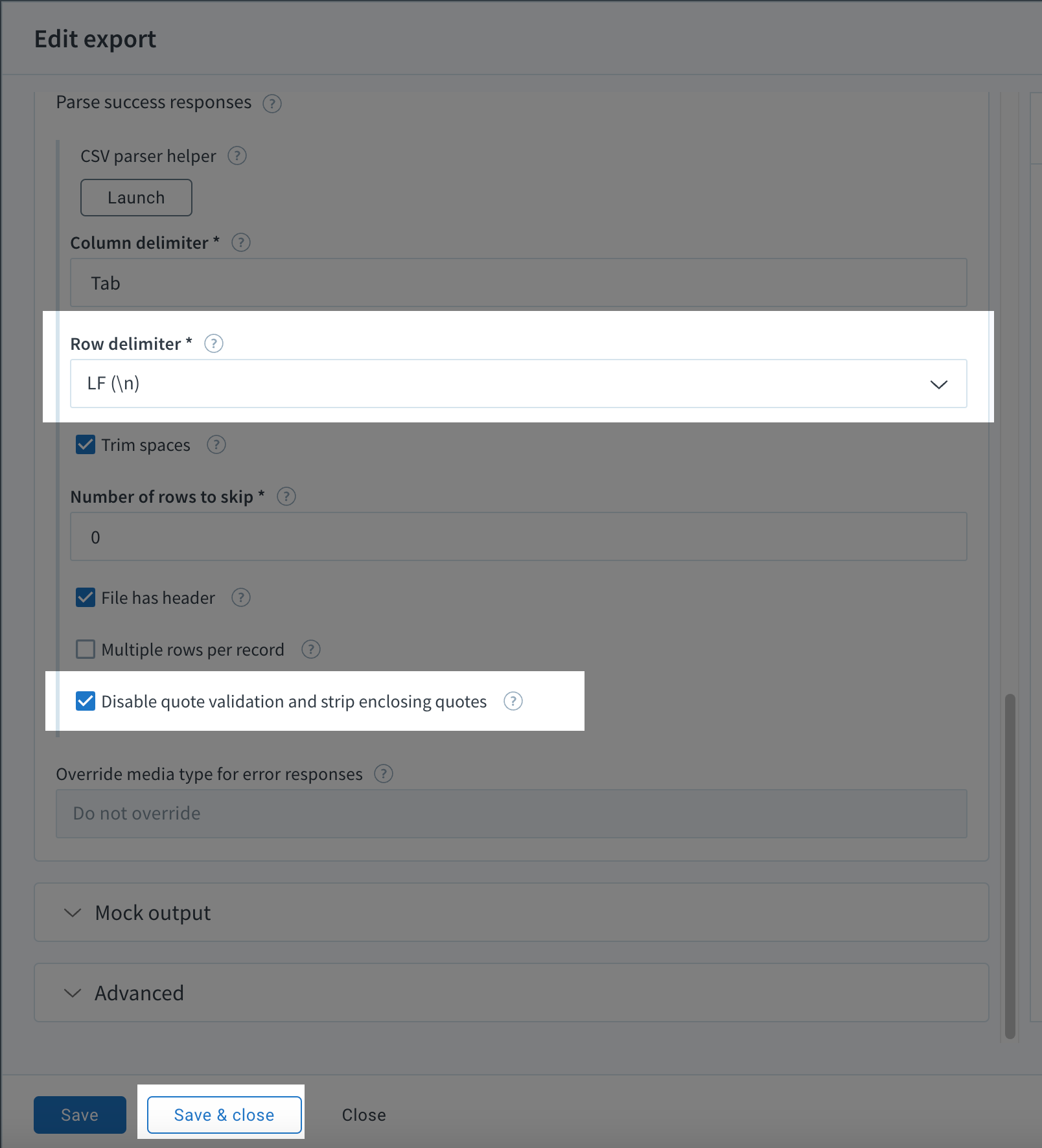

  6. The Edit export pane appears with the option to edit the Async helper settings.
  7. Select LF(\n) in the Row delimiter setting.
  8. Check the Disable quote validation and strip enclosing quotes setting.
  9. Click Save & close to save the changes made to the Async helper.
  10. Go back to the affected flow and run it again.
You should be able to sync the records without facing the “Invalid closing quote” error.
