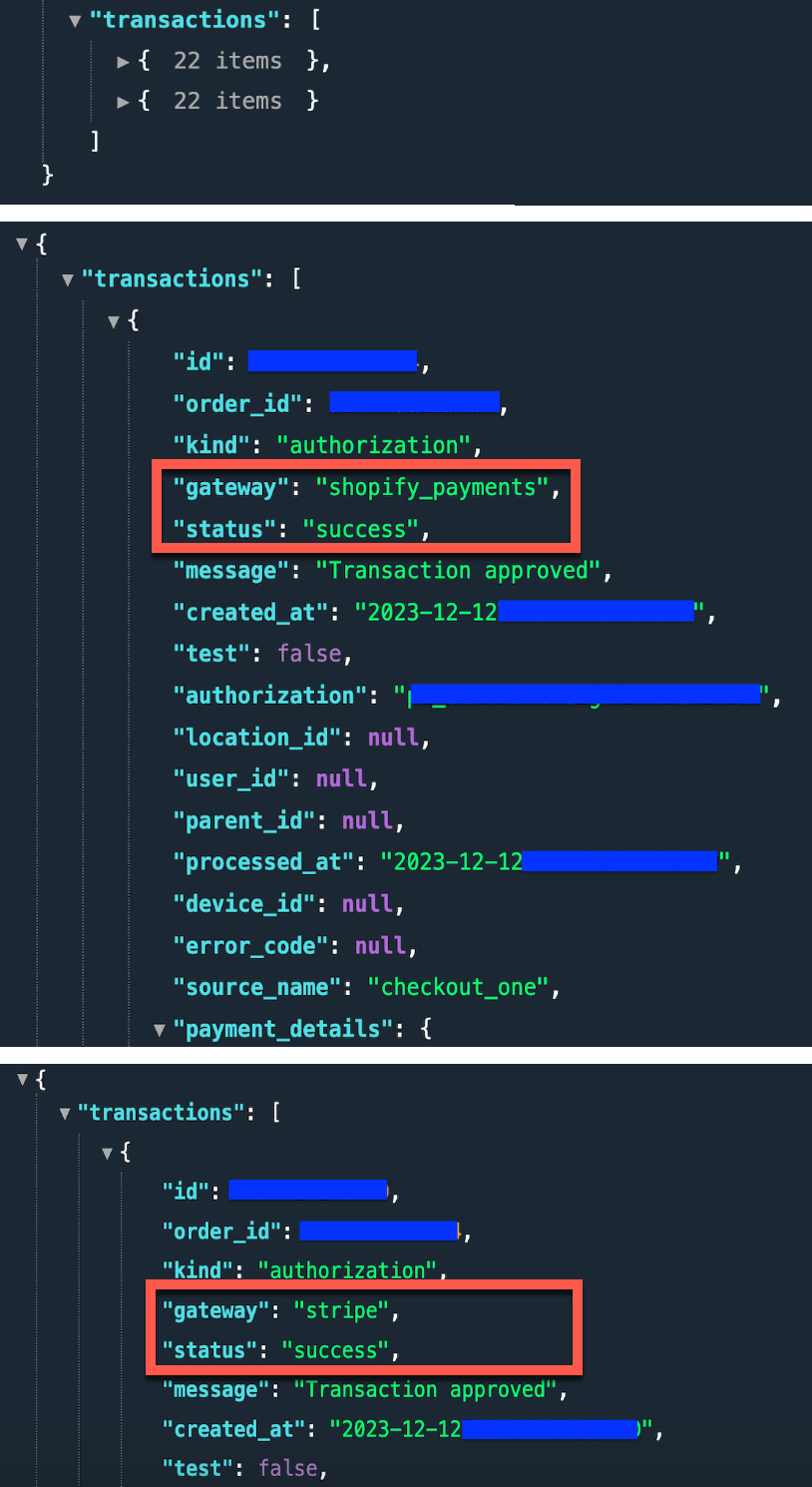

To get the Shopify gateway field values:
  1. Go to your Shopify store.
  2. In the left pane, select Orders.
  3. Open the appropriate order that has the associated payment transactions.
  4. In the browser address bar (URL), after the Shopify order number, enter /transactions.json to see the gateway value.
    • Example: https://usstore.myshopify.com/admin/orders/1356273254482/transactions.json
  5. Select Enter.
  6. In JSON, below "transactions", you can find the “gateway”.

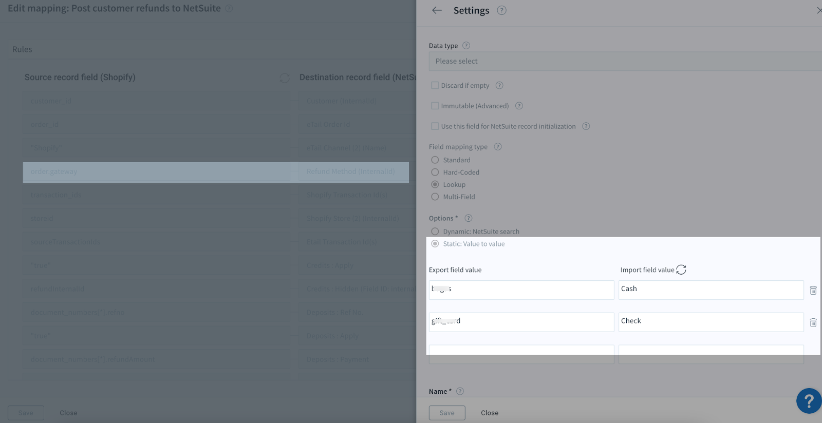

  1. Navigate to Settings > Order > Payment > Map Payment Methods.
  2. In the Shopify Payment Method field, enter the Shopify gateway value.
  3. In the NetSuite Payment Method field, enter the corresponding value for the NetSuite payment method.
    Note: While selecting a value in the NetSuite Payment Method field, if no data is yet visible, select Refresh to fetch the values from NetSuite.

  4. Select Save.
  5. Select the Map Shopify payment gateway to NetSuite payment method checkbox to move the Shopify payment method mapping from the processing method to the payment gateway.
  6. Select Save.

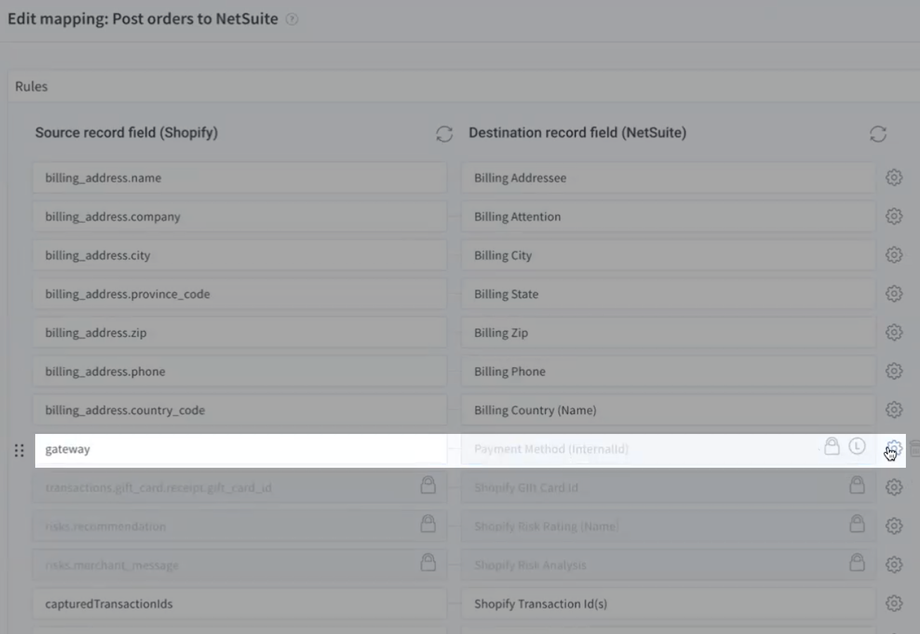

Once you have made the above changes, open any of the above-mentioned flows > mapping, and you will notice the updated gateway field mapping.
The following screenshot is an example of the Shopify order to NetSuite cash sale (add) flow.
The following screenshot is an example of the Shopify refund to NetSuite refund (add) flow.
