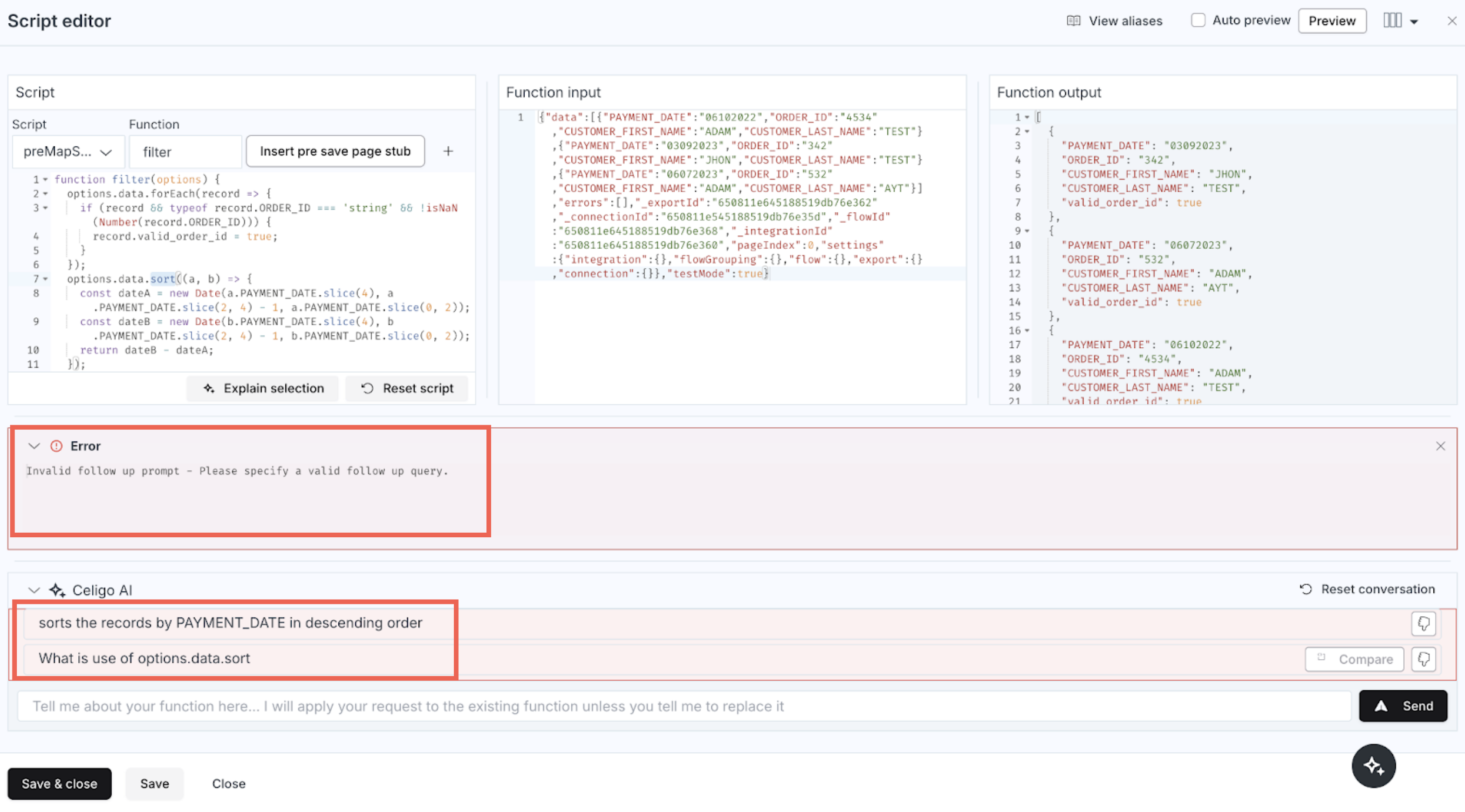

An error displays if your Celigo AI prompt is empty or invalid.
To provide a more natural and intuitive experience, the Celigo AI assistant in the Javascript editor allows you to engage naturally and conversationally. Instead of relying on a rigid and command-based approach, the AI assistant will allow you to ask dynamic follow-up prompts with guided responses.
To maintain the defined scope, if your prompt/query falls outside the assistant’s capabilities, AI will display an error message or guide you with relevant information.

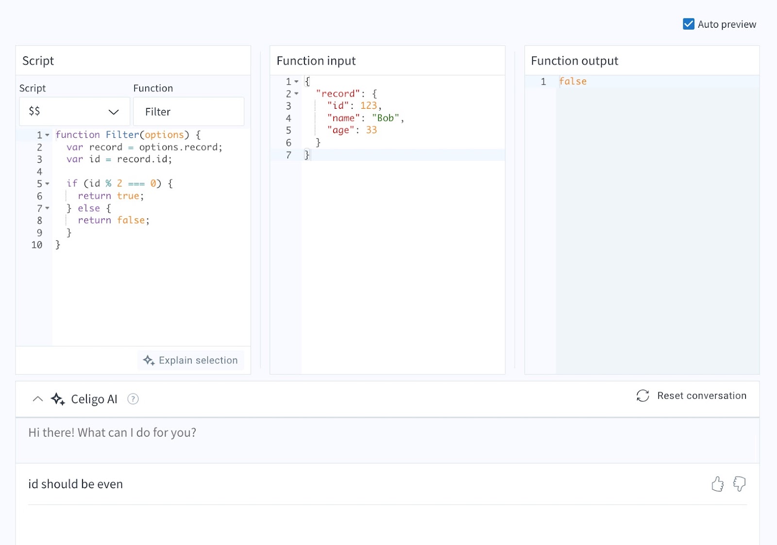

Example 1: A simple expression to check if the ID is even
Sample JSON
Prompt
JavaScript Code
Output after Auto preview
Function: Filter
"record": {
"id": 123,
"name": "Bob",
"age": 33
id should be even
function Filter(options) {
var record = options.record;
var id = record.id;
if (id % 2 === 0) {
return true;
} else {
return false;
false

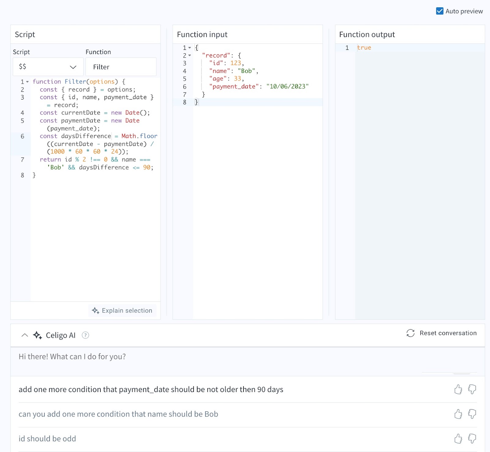

Example 2: A series of expressions to validate the JSON
Sample JSON
Prompt
JavaScript Code
Function: Filter
"record": {
"id": 123,
"name": "Bob",
"age": 33,
"payment_date": "10/06/2023"
id should be even
const { record } = options;
const { id } = record;
return id % 2 !== 0;
true
can you add one more condition that name should be Bob
const { id, name } = record;
return id % 2 !== 0 && name === 'Bob';
true
add one more condition that payment_date should be not older then 90 days
const { id, name, payment_date } = record;
const currentDate = new Date();
const paymentDate = new Date(payment_date);
const daysDifference = Math.floor((currentDate - paymentDate) / (1000 * 60 * 60 * 24));
return id % 2 !== 0 && name === 'Bob' && daysDifference <= 90;
true

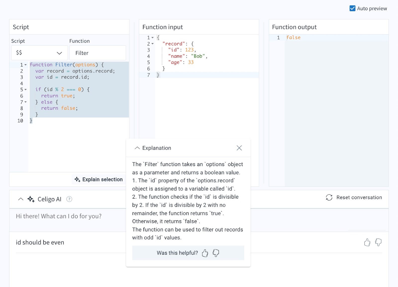

Celigo AI explains the JavaScript code for full or partial selection. Select the part of the code that you want Celigo AI to explain, and click Explain selection. Celigo AI will generate an explanation for the selected code. The selected lines remain highlighted until you close the explanation window. You can reposition the explanation window as needed.
Example 1: Explanation for a simple expression
Sample JSON
Prompt
JavaScript Code
Explain selection
"record": {
"id": 123,
"name": "Bob",
"age": 33
id should be even
var id = record.id;
if (id % 2 === 0) {
return true;
} else {
return false;
The `Filter` function takes an `options` object as a parameter and returns a boolean value.
1. The `id` property of the `options.record` object is assigned to a variable called `id`.
2. The function checks if the `id` is divisible by 2. If the `id` is divisible by 2 with no remainder, the function returns `true`. Otherwise, it returns `false`.
The function can be used to filter out records with odd `id` values.

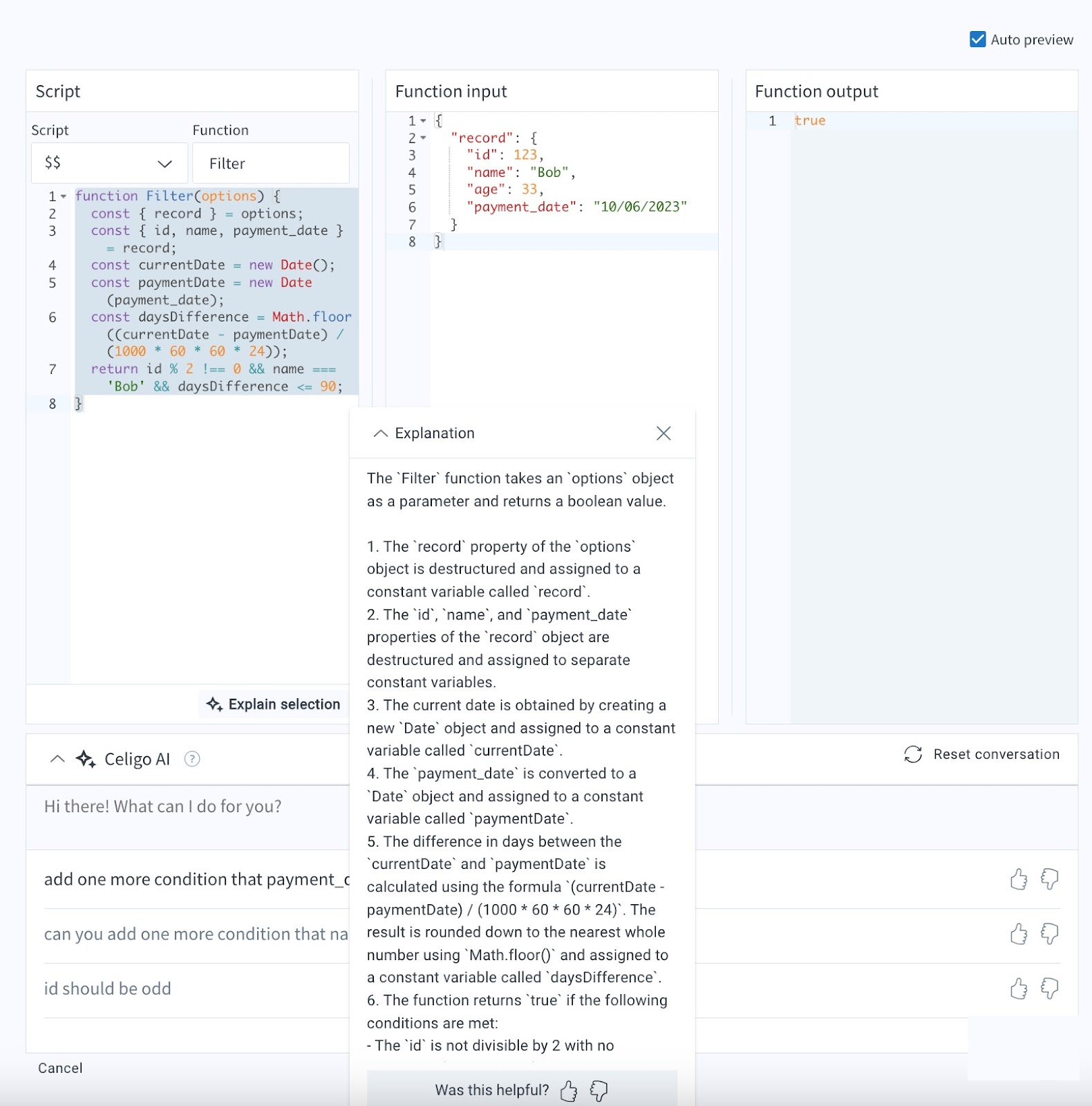

Example 2: Explanation for a series of prompts
Sample JSON
Prompt
JavaScript Code
Explain selection
"record": {
"id": 123,
"name": "Bob",
"age": 33,
id should be odd
1. The `record` property of the `options` object is destructured and assigned to a constant variable called `record`.
2. The `id`, `name`, and `payment_date` properties of the `record` object are destructured and assigned to separate constant variables.
3. The current date is obtained by creating a new `Date` object and assigned to a constant variable called `currentDate`.
4. The `payment_date` is converted to a `Date` object and assigned to a constant variable called `paymentDate`.
5. The difference in days between the `currentDate` and `paymentDate` is calculated using the formula `(currentDate - paymentDate) / (1000 * 60 * 60 * 24)`. The result is rounded down to the nearest whole number using `Math.floor()` and assigned to a constant variable called `daysDifference`.
6. The function returns `true` if the following conditions are met:
- The `id` is not divisible by 2 with no remainder (`id % 2 !== 0`).
- The `name` is equal to 'Bob'.
- The `daysDifference` is less than or equal to 90.
If any of these conditions are not met, the function returns `false`.
The function can be used to filter out records that have an odd `id`, a name other than 'Bob', or a payment date that is more than 90 days ago.
add one more condition that payment_date should be not older than 90 days

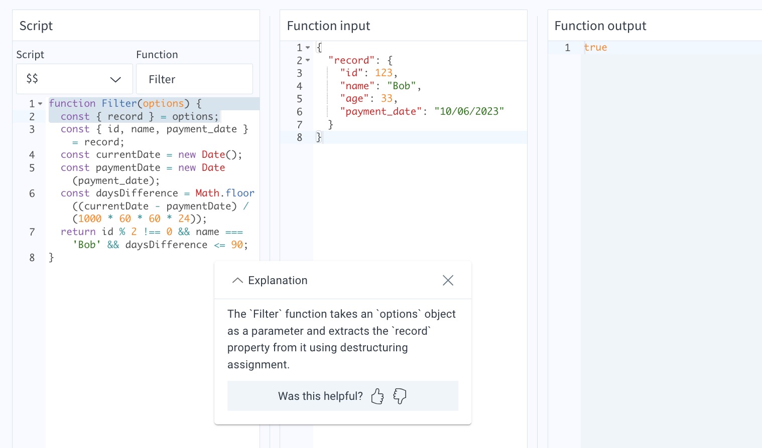

Example: Partial selection
When you select the syntax partially and click Explain selection
