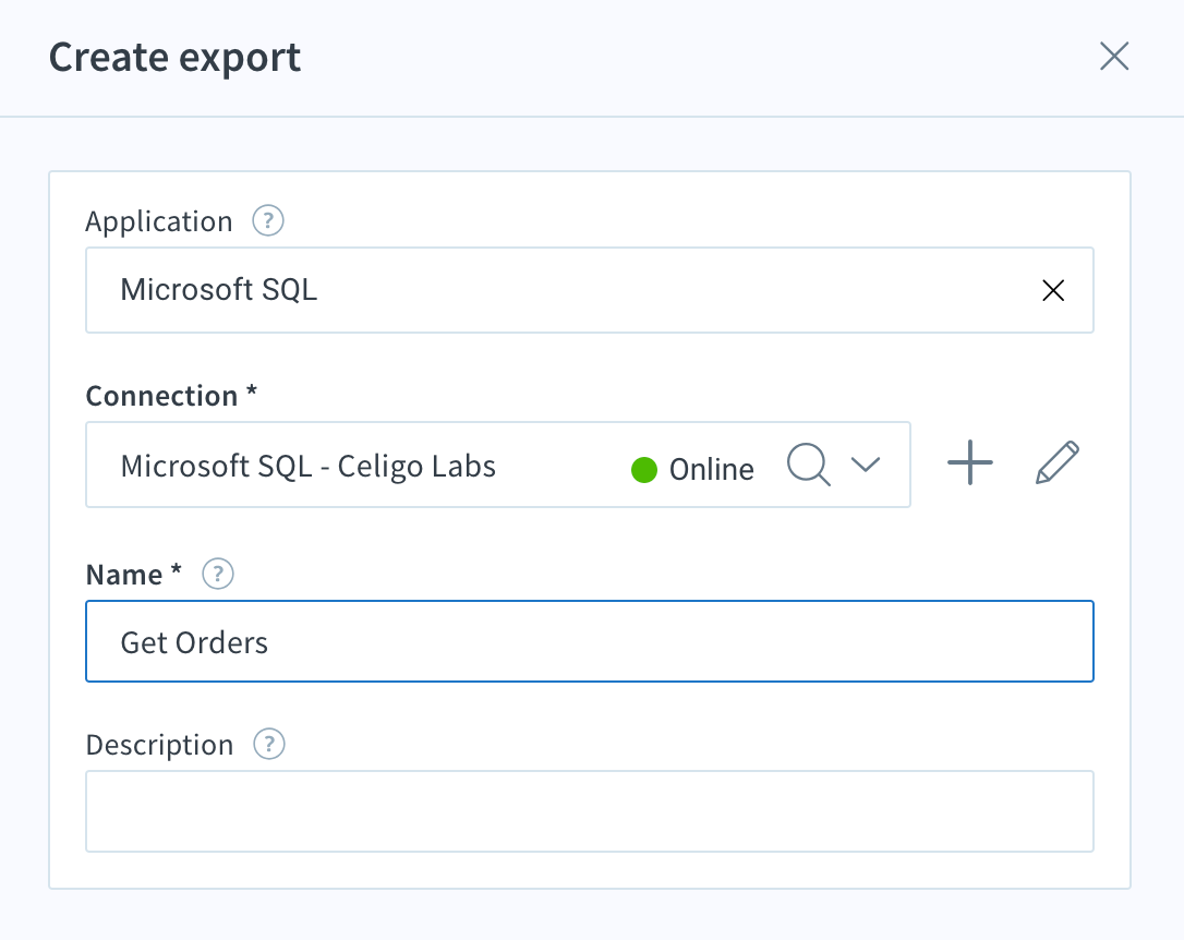

  1. From the Resources menu, select Exports to open the list of exports for your account.
  2. At the upper right of the Exports page, click + New export.
  3. In the resulting Create export panel, give the new export a meaningful name. (The Name field is required; Description is optional, for your reference.)
  4. Continuing in the Create export panel, select Microsoft SQL from the Application list.
  5. After you select a database application, the Connection list is populated only with existing connection resources for that database type. Select an existing connection, or click the plus (+) button to add a new connection.

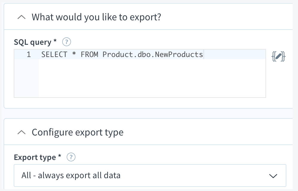

  6. Then, in the Query field, write the SQL statement that fetches the data that you require.
    Some implementations require you to specify the database name when accessing a table – for example,
    SELECT * FROM <databasename>.<schema>.<tablename>
  7. Select an Export type:
    • All – to export all data, always
    • Delta – to export only data that has changed since the last time the data flow was run
    • Once – to export only data that has not already been exported
    • Limit – to export a limited set of records, primarily used for testing to avoid syncing lots of data
      When you select the export type as Limit - export a set number of records , another setting How many records would you like to export? is enabled for you to enter the maximum number of records to export each time this flow runs. The default value is set to one. You can export a maximum of 100 records.
  8. Click preview to see sample JSON-formatted data. If the SQL query is not executed successfully, revise the Query or Export type values.
