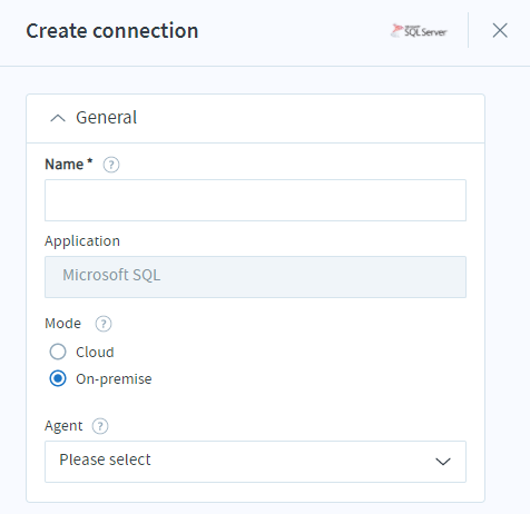

B. Supply general Microsoft SQL settings
At this point, you’re presented with initial options for providing the new MS SQL connection.
Name (required): How you want to refer to this connection in integrator.io.
Application: default value is Microsoft SQL.
  • Cloud: Connect to a publicly accessible server application.
  • On-premise: Connect to a server that is publicly inaccessible and has integrator.io agent installed on it, such as a production MS SQL Server environment.
Agent (required, if On-premise selected for Mode; otherwise hidden): Select an agent from the list. To connect to an on-premise application, integrator.io requires that an agent be installed on a networked computer. An agent is a small application that allows you to connect to data behind your firewall. When installing an agent, you will specify a unique access token, which then populates the Agent drop-down list. The installed agents connect to integrator.io and establish a reverse SSH tunnel, allowing secure communication without the need to whitelist integrator.io’s IP addresses in your firewall settings. A single agent can be used by multiple different connections.

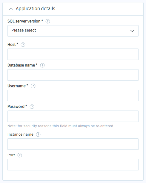

C. Provide Microsoft SQL authentication
SQL server version (required): Select one of the following server versions:
  • Azure
  • SQL Server 2008 R2 (no longer supported by Microsoft)
  • SQL Server 2012
  • SQL Server 2014
  • SQL Server 2016
  • SQL Server 2017 (also applies to SQL Server 2019 and SQL Server 2022 versions)
Celigo strongly recommends not selecting MS SQL server version 2008 R2 since it’s no longer supported by Microsoft. If you are unable to connect or run into trouble while integrating to this version, you won’t get any support from Microsoft, and the Celigo Support team will not be able to help you resolve your issues. Upgrade to a newer MS SQL server version before building integrations.
Host (required): Enter the hostname or IP address of the server to connect to. These values were created during SQL Server setup.
Database name (required): Provide the database name created during SQL Server setup.
Auth type (required, if Cloud selected for Mode; otherwise hidden): Select either of the following options:
  • Database user: Connect to a Microsoft SQL database using a username and password.
  • Service principal: Connect to a Microsoft SQL database using a service principal.
    Service principal authentication is not supported for SQL Server 2008 R2.
  • Service principal client (required, if Service principal selected for Auth type; otherwise hidden): Click the Create service principal client button and configure the iClient settings. After you create the iClient, you can select it from the list the next time.
    (Click the pencil button ( pencil.svg ) to review or edit the client service principal; and the plus sign (Define_options.svg) to add another service principal client.)
Database user – Cloud or On-premise mode
To create a database user, enter the following details:
  • Username (required): Enter the username created by the SQL Server administrator for this account.
  • Password (required): Enter the password created by the SQL Server administrator for this account.

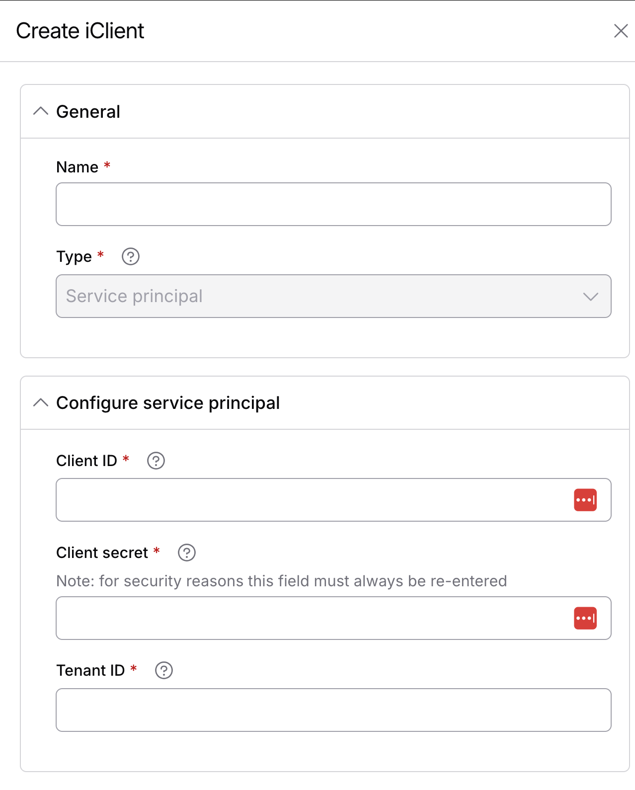

Service principal – Cloud mode
To create a service principal client, enter the following details in the Create iClient form that opens:
  • Name: Enter a meaningful name for your iClient
  • Type (read-only): Service principal is selected by default. Learn more about creating an application in Microsoft Entra ID.
    If you've earlier entered Azure as the SQL server version, you can follow the steps in the settings below. For other server versions, see Microsoft documentation.
  • Client ID: Enter the client ID for your registered Microsoft SQL, Azure SQL or Fabric SQL in Microsoft Entra ID. The client ID uniquely identifies the application used for authentication.
    To get this detail,
    1. Sign in to Microsoft Entra admin center.
    2. Go to Microsoft Entra ID or search for it using the search bar.
    3. In the left navigation menu, select App registrations under the Manage section.
    4. Select All applications and search by name.
    5. On the application's Overview page, you can find the Client ID.
  • Client secret: Enter the client secret generated for your client ID in the registered Microsoft SQL, Azure SQL or Fabric SQL. It acts like a password for the application.
    if you don't already have it, go to Entra IDApp registrationsOverviewManageCertificates & secrets to generate a new secret. Then copy and save the secret value because you will not able to see it again later. Check if you have the required Microsoft permission to create a new client secret.
  • Tenant ID: Enter the tenant ID of your Microsoft Entra ID tenant. It is the unique identifier of your organization's identity environment in Microsoft Entra.
    To get the tenant ID or directory,
    2. Hover over your account name (avatar) and check the directory details.
      Or
    3. Go to Entra IDOverviewProperties tab and look for Tenant ID.

Instance name (or Port required): Specify the instance name to connect to, assuming that the SQL Server Browser service is running on the database server and UDP port 1434 is reachable. If you set the instance name, you cannot also set the Port, below; they are mutually exclusive connection options.
Port (or Instance name required): Enter the TCP port for the database engine, which is 1433 by default in SQL Server. Port 1433 is also the official Internet Assigned Number Authority (IANA) socket number for SQL Server, and SQL Server Management Studio (SSMS) uses it to manage SQL Server instances across the network.

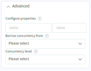

D. Edit advanced Microsoft SQL settings
Before continuing, you have the opportunity to provide additional configuration information, if needed, for the Microsoft SQL connection.
Configure properties (optional): You can use these fields to provide additional name-value pairs to be sent to SQL Server with the connection. You can use any of the following advanced configuration options:
