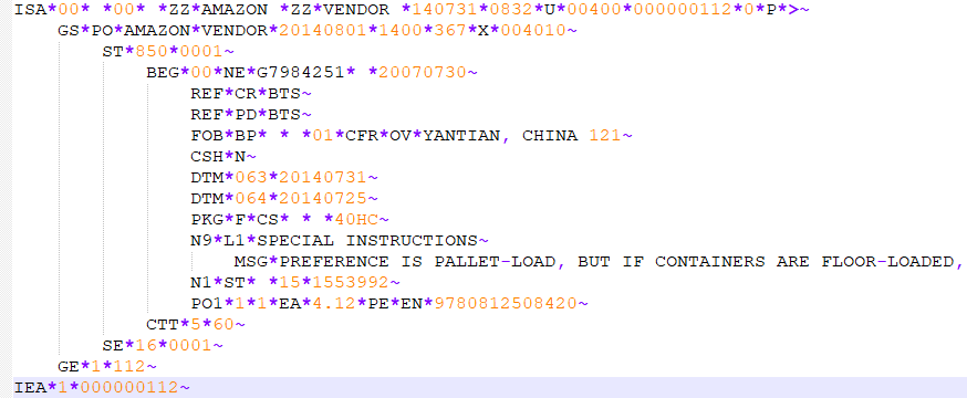

  • Amazon EDI 850 – EDI file format (purchase order in EDI format) to the JSON format and vice versa are present under EDI to JSON and JSON to EDI. Note that these two sections are arranged to represent a parent-child relationship; see the table of contents, above, for this hierarchy.
    The following code illustrates an Amazon 850 purchase order EDI text file:
    ISA*00* *00* *ZZ*AMAZON *ZZ*VENDOR *140731*0832*U*00400*000000112*0*P*>~
    GS*PO*AMAZON*VENDOR*20140801*1400*367*X*004010~
    ST*850*0001~
    BEG*00*NE*G7984251* *20070730~
    REF*CR*BTS~
    REF*PD*BTS~
    FOB*BP* * *01*CFR*OV*YANTIAN, CHINA 121~
    CSH*N~
    DTM*063*20140731~
    DTM*064*20140725~
    PKG*F*CS* * *40HC~
    N9*L1*SPECIAL INSTRUCTIONS~
    MSG*PREFERENCE IS PALLET-LOAD, BUT IF CONTAINERS ARE FLOOR-LOADED, THEN PLEASE DO CLAMP-LOAD OR STRAIGHT FLOOR-LOAD. DO NOT USE SLIP SHEET FOR THIS FC DESTINATION.PAYMENT TERMS ARE PER CONTAINER.~
    N1*ST* *15*1553992~
    PO1*1*1*EA*4.12*PE*EN*9780812508420~
    CTT*5*60~
    SE*16*0001~
    GE*1*112~
    IEA*1*000000112~
    The EDI file is available in this rough format, which is easier to understand as a hierarchy for the Amazon 850 purchase order. The integrator.io definition file structures your data according to the definition, as it encounters each of these EDI lines.

Input (EDI)
ST*850*0001~
SE*16*0001~

Input (EDI)
CTT*5*60~

Input (EDI)
REF*CR*BTS~
REF*PD*BTS~

Input (EDI)

Input (EDI)
CSH*N~

Input (EDI)
DTM*063*20140731~
DTM*064*20140725~
Process (Definition File)

Input (EDI)
PKG*F*CS* * *40HC~

Input (EDI)

Input (EDI)

Input (EDI)
N1*ST* *15*1553992~

Input (EDI)

Output (EDI)
GE*1*112~

Output (EDI)
ST*850*0001~
SE*16*0001~

Output (EDI)
BEG*00*NE*G7984251**20070730~
CTT*5*60~

Output (EDI)
REF*CR*BTS~
REF*PD*BTS~

Output (EDI)
FOB*BP***01*CFR*OV*YANTIAN, CHINA~
FOB*BP***01*CFR*OV*YANTIAN, CHINA 121~

Output (EDI)
CSH*N~

Output (EDI)
DTM*063*20140731~
DTM*064*20140725~

Output (EDI)
PKG*F*CS***40HC~

Output (EDI)

Output (EDI)

Output (EDI)
N1*ST**15*1553992~

Output ( EDI)

Q. While performing a JSON to EDI conversion, I am unable to convert special characters. For example, a "<" symbol appears as "&lt;". What is the workaround?
A. Use {{{ }}} in the Definition File while converting the JSON element to EDI.
The following code-snippet illustrates how to use {{{ }}} when there is a special character in the input data. In the following example, MSG contains a less than (<) symbol.

"MSG":[
        "Free-Form Message Text":"PREFERENCE IS PALLET-LOAD, BUT IF CONTAINERS ARE FLOOR-LOADED, THEN PLEASE DO CLAMP-LOAD OR STRAIGHT FLOOR-LOAD. DO NOT USE SLIP SHEET FOR THIS FC DESTINATION.PAYMENT TERMS ARE PER CONTAINER."
    "name": "MSG",
    "description": "Message Text",
    "relativeDataPath": "MSG",
    "maxOccurrence": 50,
    "required": true,
    "elements": [
            "name": "name",
            "value": "MSG"
            "name": "Free-Form Message Text",
            "value": "{{{[Free-Form Message Text]}}}"// {{{ }}}here is used so that the special characters appear as is in the EDI format.
Output (EDI)
MSG*PREFERENCE IS < PALLET-LOAD, BUT IF CONTAINERS ARE FLOOR-LOADED, THEN PLEASE DO CLAMP-LOAD OR STRAIGHT FLOOR-LOAD. DO NOT USE SLIP SHEET FOR THIS FC DESTINATION.PAYMENT TERMS ARE PER CONTAINER.~
