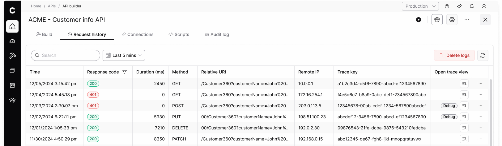

Request history table columns
To open request history, open your API in API builder and select Request history.
Each row in the request history table represents one inbound request. The table includes the following columns:
  • Time — The date and time the request was received.
  • Response code — The HTTP response code returned. Codes in the 2xx range appear in green; error codes appear in red.
  • Duration (ms) — How long the API took to process the request, in milliseconds.
  • Method — The HTTP method used (GET, POST, PUT, PATCH, DELETE, etc.).
  • Relative URI — The path of the request, relative to https://api.integrator.io/apis/<version>. Long URIs are truncated in the table view.
  • Remote IP — The IP address of the client that sent the request.
  • Trace key — A unique identifier assigned to each request. The trace key lets you track a specific request through every step of the API execution path and find it in request history using search. To learn how trace keys work and how to set a custom trace key, see Set a custom trace key to uniquely identify a record.
  • Open trace view — Opens trace view for that request. Rows captured during an active debug session display a Debug badge next to the trace key.
Search and filter request history
Use the search bar and filter controls to narrow the request history table to the entries you need.
  • Search by URI — Type a relative URI or partial URI into the search bar. The table updates to show only matching requests. If your query produces no results, the table displays: "Query may be too specific to produce results. Try another query, or clear current search query." Select Clear to reset the search.
  • Filter by response code — Select the filter icon next to Response code. Select one or more codes from the list, then select Apply. Select Clear to remove all selected codes. If the active filters produce no results, the table displays: "Filtering may be too specific to produce results. Adjust selected filters, or clear current selection." Select Clear filters to reset.
  • Filter by time range — Select the time range selector (default: Last 5 mins) to change the window of request history displayed.
To refresh the table and fetch the latest requests, select the refresh icon.

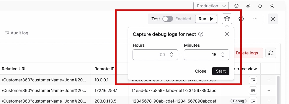

Enable debug logging
Debug mode temporarily raises logging to the Debug level, capturing complete execution detail for every request received while it's active. It overrides whatever log level is otherwise set while it's on.
To enable debug mode:
  1. In API builder, select Enable debug mode.
  2. In Capture debug logs for next, enter a duration in hours and minutes.
  3. Select Start.
Capture debug logs for next panel with hours and minutes fields and a Start button
Debug mode takes effect immediately and logs every request received during the active window at the Debug level.
The minimum duration is 5 minutes. The maximum debug duration depends on your subscription:
Subscription Maximum debug duration
Free trial 15 minutes
Standard 1 hour
Professional 24 hours
Enterprise 72 hours
Warning
Debug logs may increase latency and cause timeouts, especially for high-volume or one-to-many APIs.

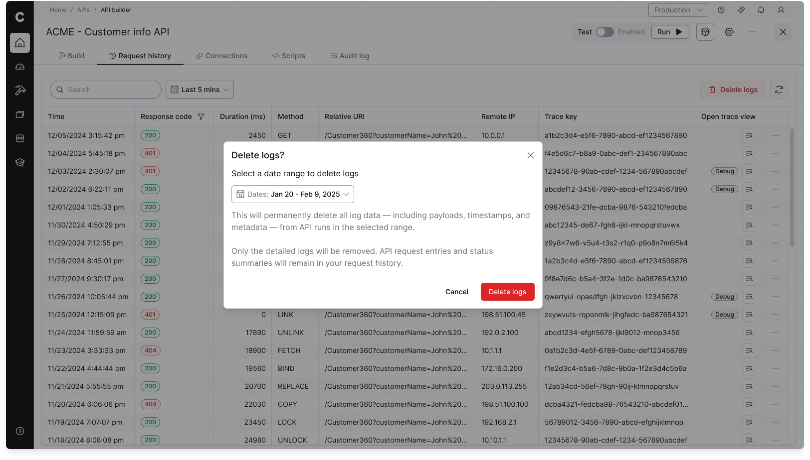

Delete logs
Delete stored request logs to remove data you no longer need or to meet a compliance requirement. Deleting a log permanently removes its payloads and metadata for the date range you select. The request entry and status summary remain in request history.
Only admins, owners, and users with manage access can delete logs.
To delete logs:
  1. In Request history, select Delete logs.
  2. Select Select date range, choose a range, then select Apply.
  3. In the Delete logs? confirmation dialog, select Delete logs.
Delete logs dialog with a date range selector
Each deletion is recorded in the audit log with the time, user, action, and selected date range.
Logs are retained according to your account's data retention policy.

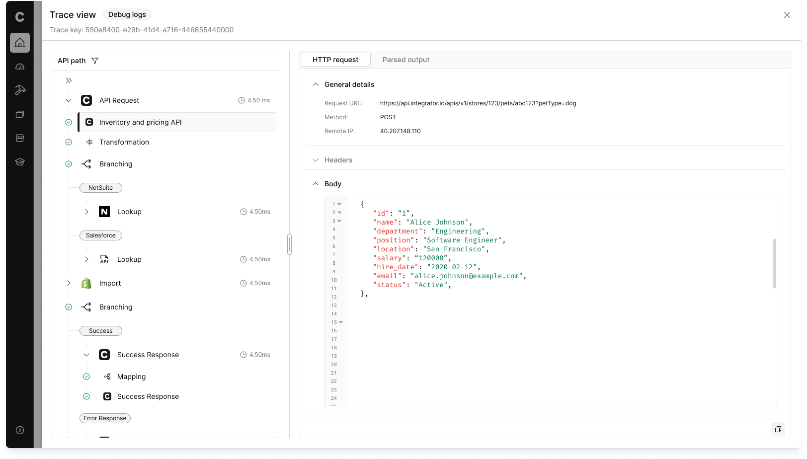

View a request in trace view
Trace view follows a single request end to end through your API's execution path, showing the steps it passed through, the data at each step, and how long each step took. Select Open trace view in any row to open it.
Trace view with the API path panel and the HTTP request tab
API path panel
The left panel shows the API path: a tree of every step the request passed through, including the API request node, branching, lookups, imports, tool imports, mappings, and success or error response nodes. Expand a tool import to view its internal steps and any nested tools. Each node shows its execution time. Select a node to view its details in the right panel.
Right panel tabs
What appears in the right panel depends on which node you select.
API request node
  • HTTP request — General details (request URL, HTTP method, remote IP), headers, and request body.
  • Parsed output — The parsed payload passed downstream to subsequent steps.
Tool nodes
  • Tool input and output - The data the API passed to the tool and the data the tool returned.
  • Internal steps - Execution details for lookups, imports, mappings, transformations, and other supported components inside the tool.
  • Nested tools - Expand a nested tool to trace execution through its internal steps.
All other nodes (lookups, imports, mappings, response nodes)
  • Input — The data received by this step.
  • HTTP response — General details (status code, response time), headers, and response body.
Authentication tokens, API keys, and other sensitive information are always masked in trace view. Tool execution logs follow the parent API's log level. You can't set a separate log level for a tool.
