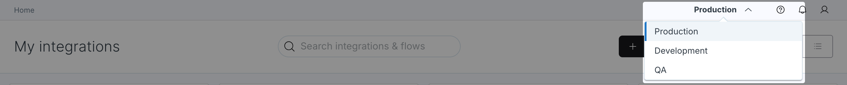

  2. In the top bar, select Environment, and then select Sandbox. See Create and manage multiple environments.

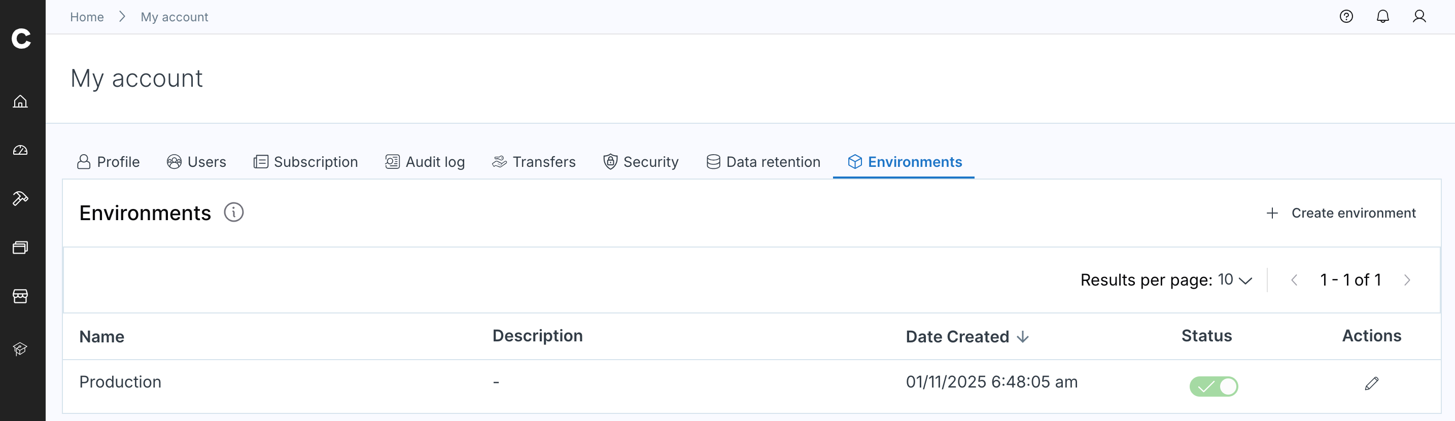

You can now rename your Sandbox environment and create more environments. See Create and manage multiple environments.
